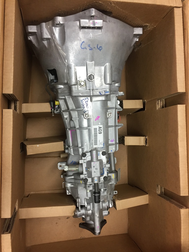

Finally got the transmission back home. It was sitting at a friends shop for the longest time. Still accumulating parts for the swap. Getting closer though.

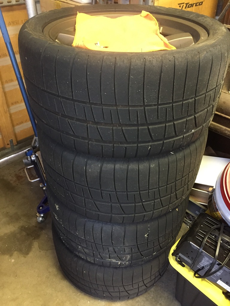

The BFG Rivals are off the truck and it's sitting on the work out nt05's. Going to be dismounting the BFG's and selling them.

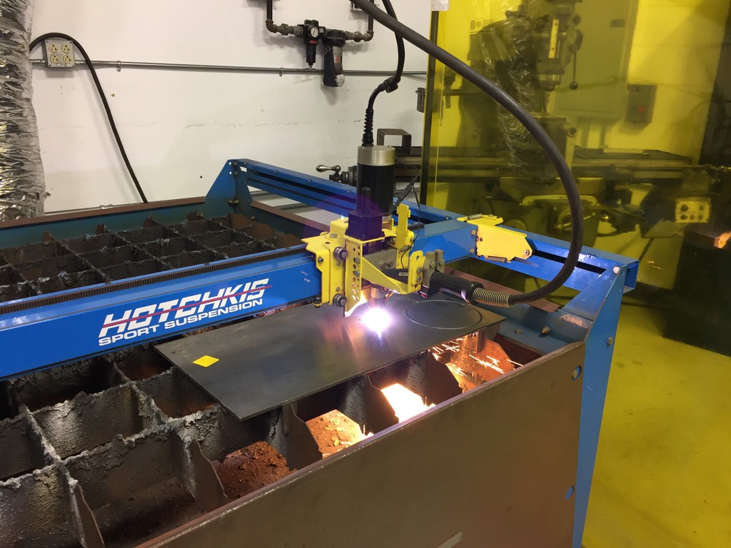

having a plasma table at work made quick work of some of the pieces.

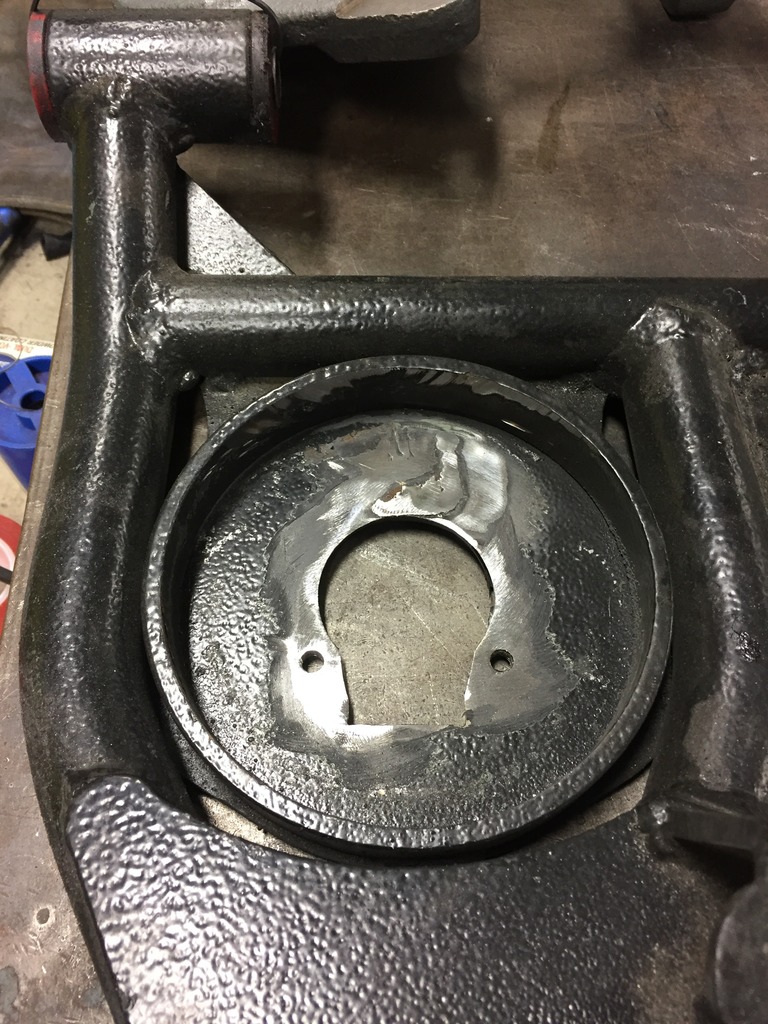

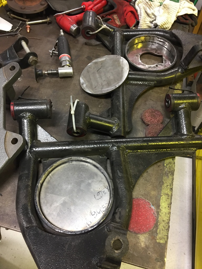

Got my front arms on the bench. Cut the spring notches out of the pockets. And got my filler plates ready to weld in along with the coil-over and new sway bar link mounts. I'm going to strip the terrible powder coat on the arms and either re-coat or just paint them. Might make some new bushings for them too.

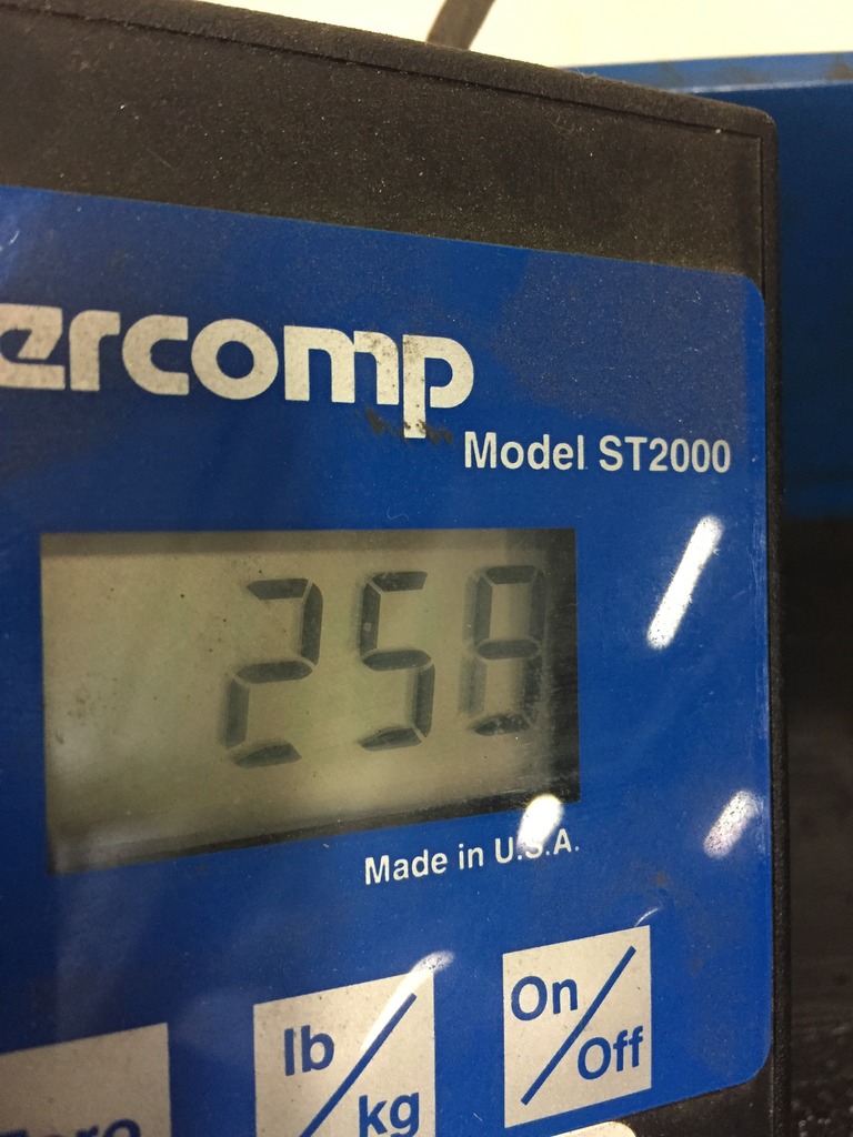

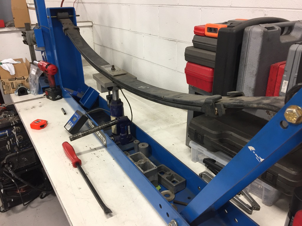

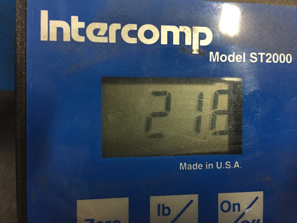

Also got the rear leafs on the spring tester to check the rates. Why? because I could. My original plan was to 4 link the rear, but I am going to try out a few things with the leaf springs first.

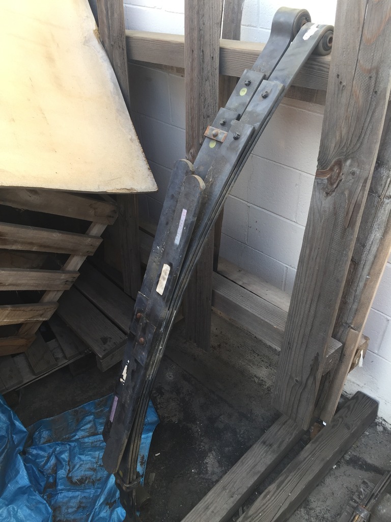

Found a set of rear leafs off of a 2007 Dodge Ram RCSB in an old parts pile at the shop that are pretty close to the dimensions of the Silverado springs.
Might use one of the leafs out of that pack to stiffen up mine.
My springs tested out at 220 lbs and the dodge's were 260lbs. So the additional leaf would add a little bit of rate to the rear. I am going to get the front suspension finished up before I change the rate on the rear.
