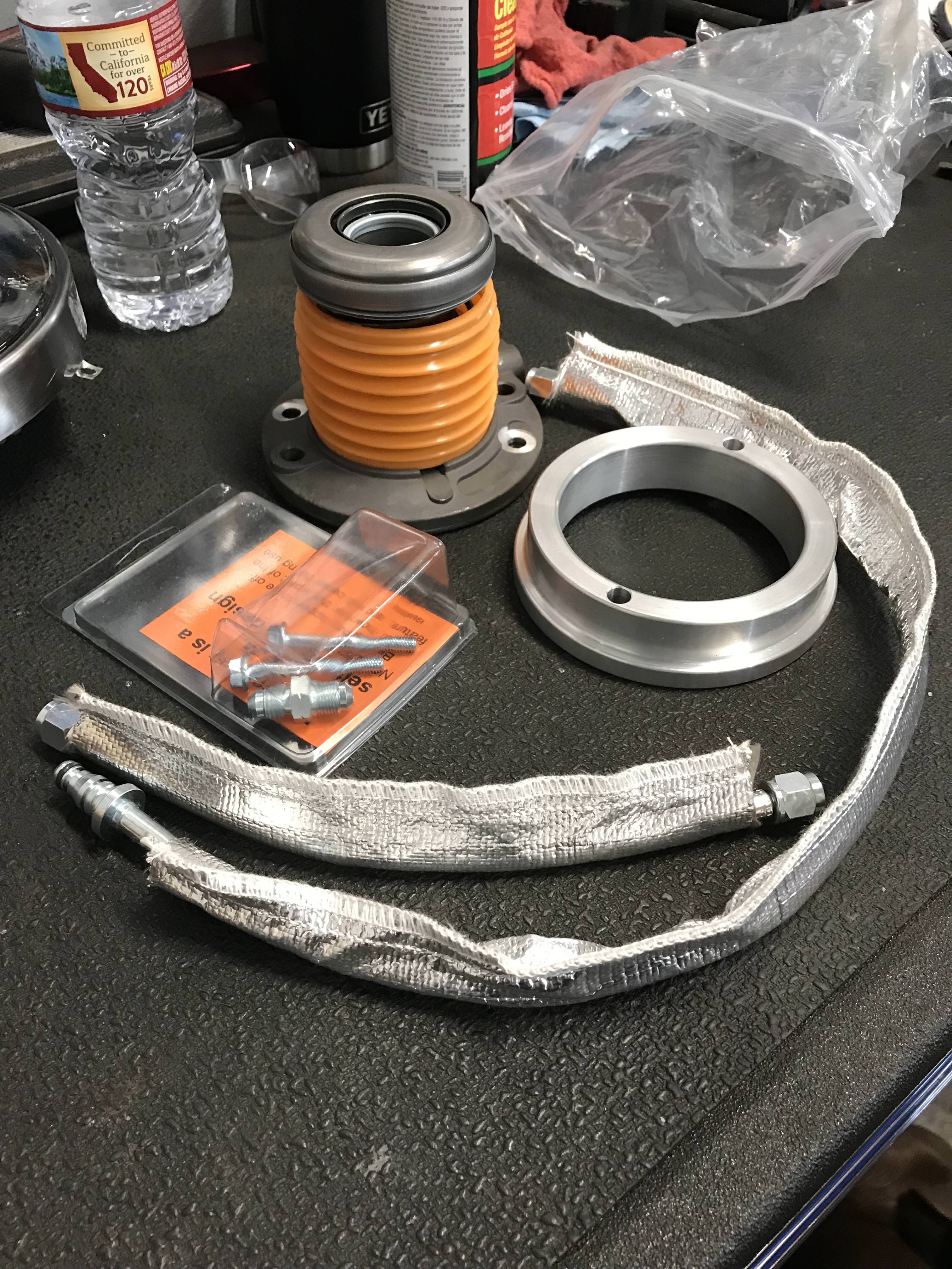

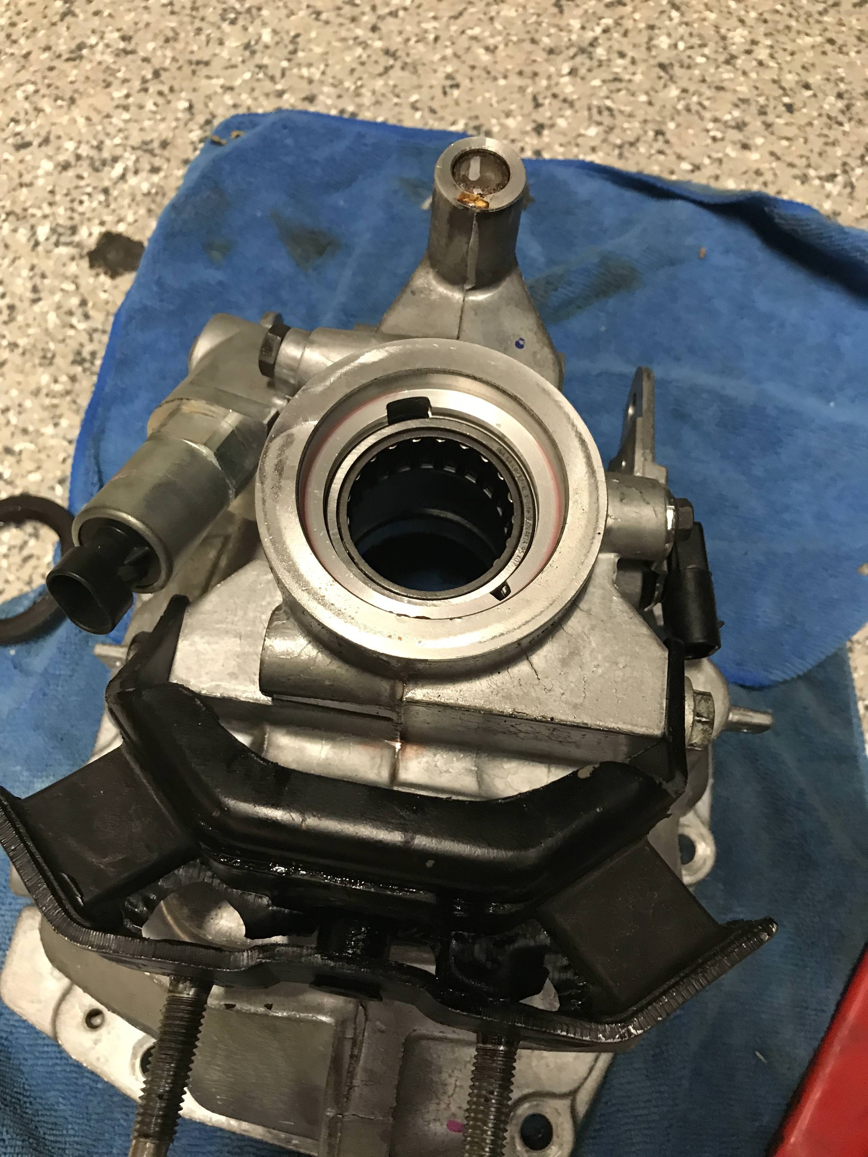

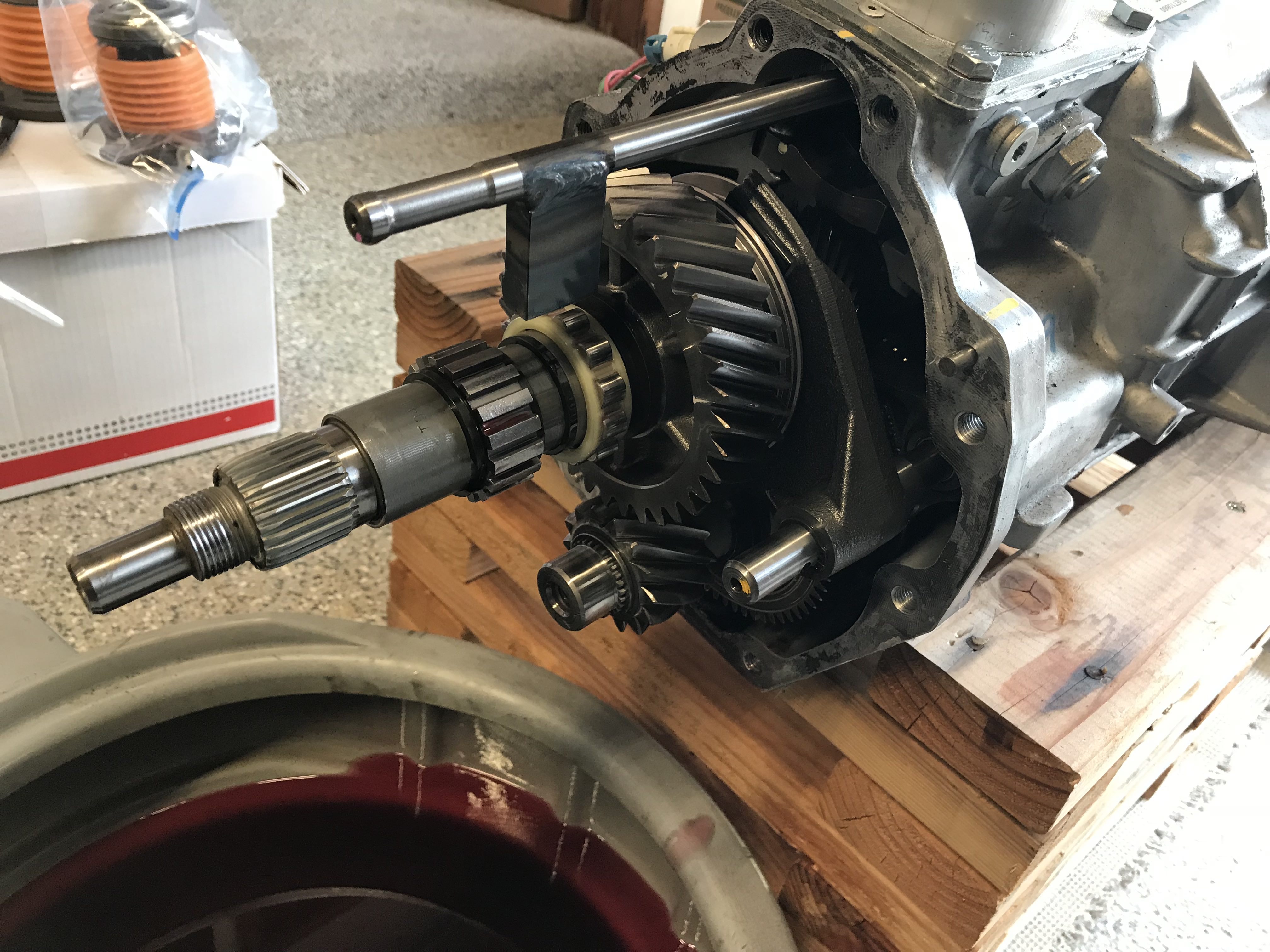

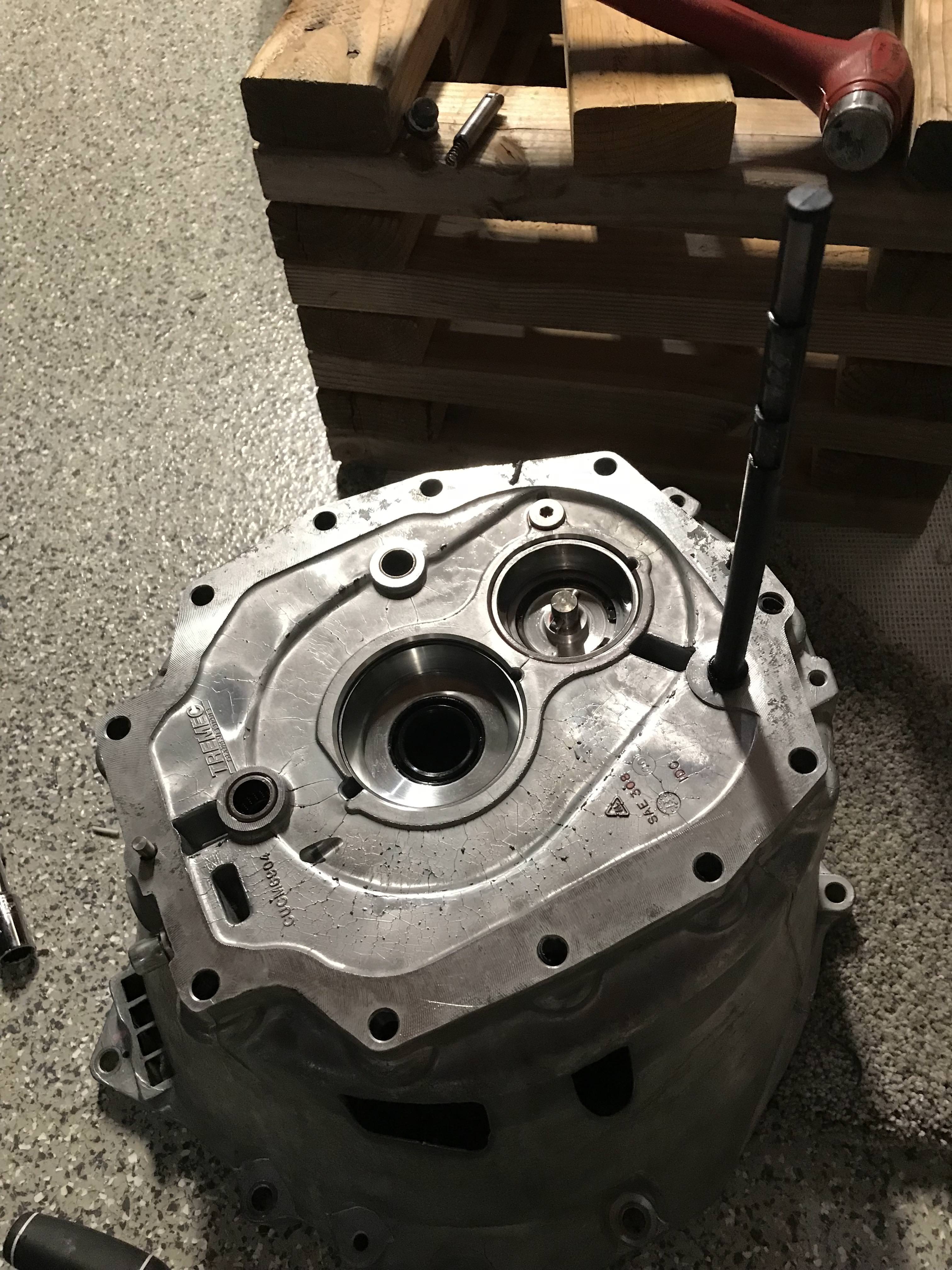

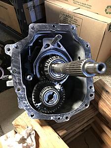

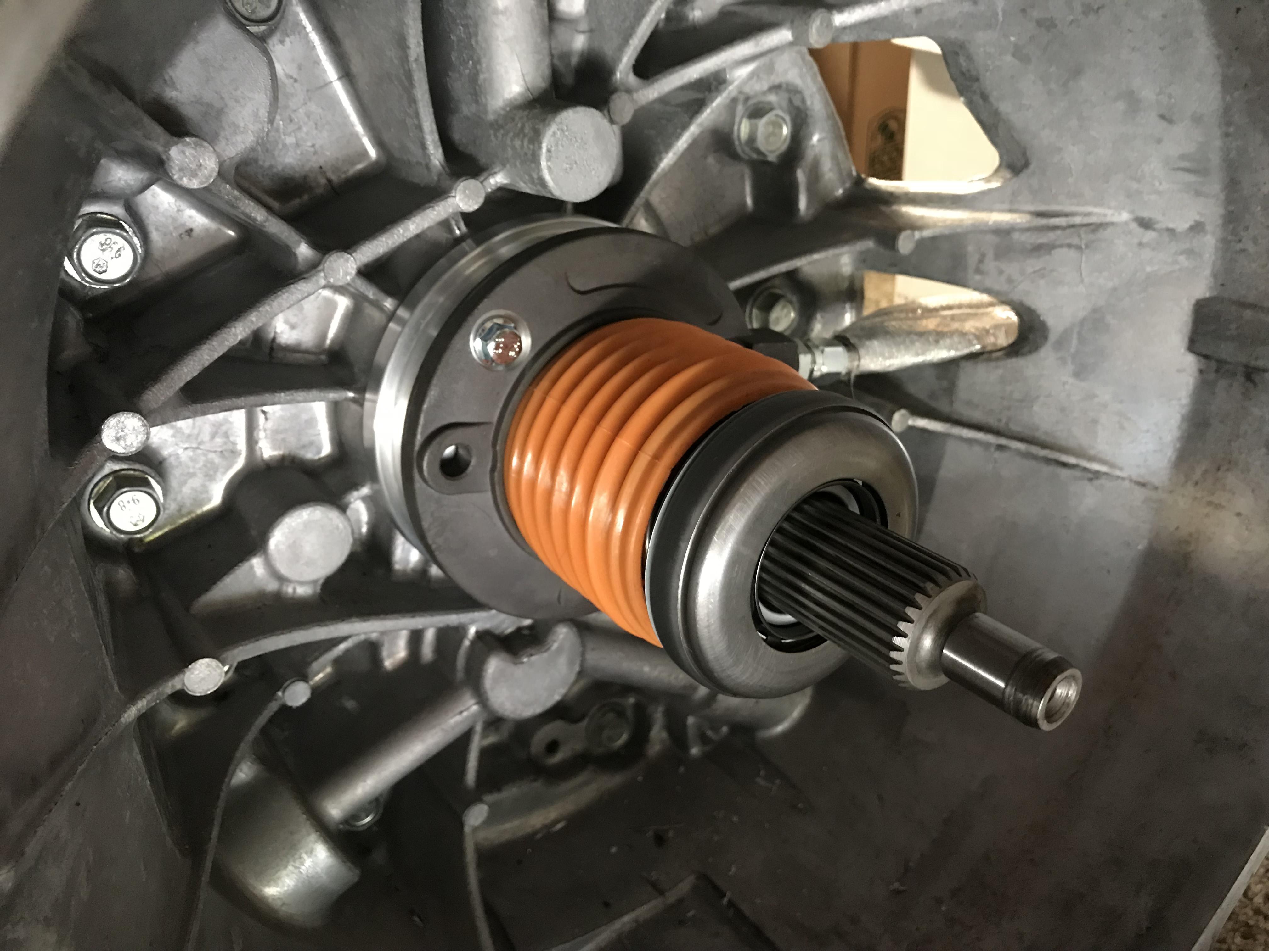

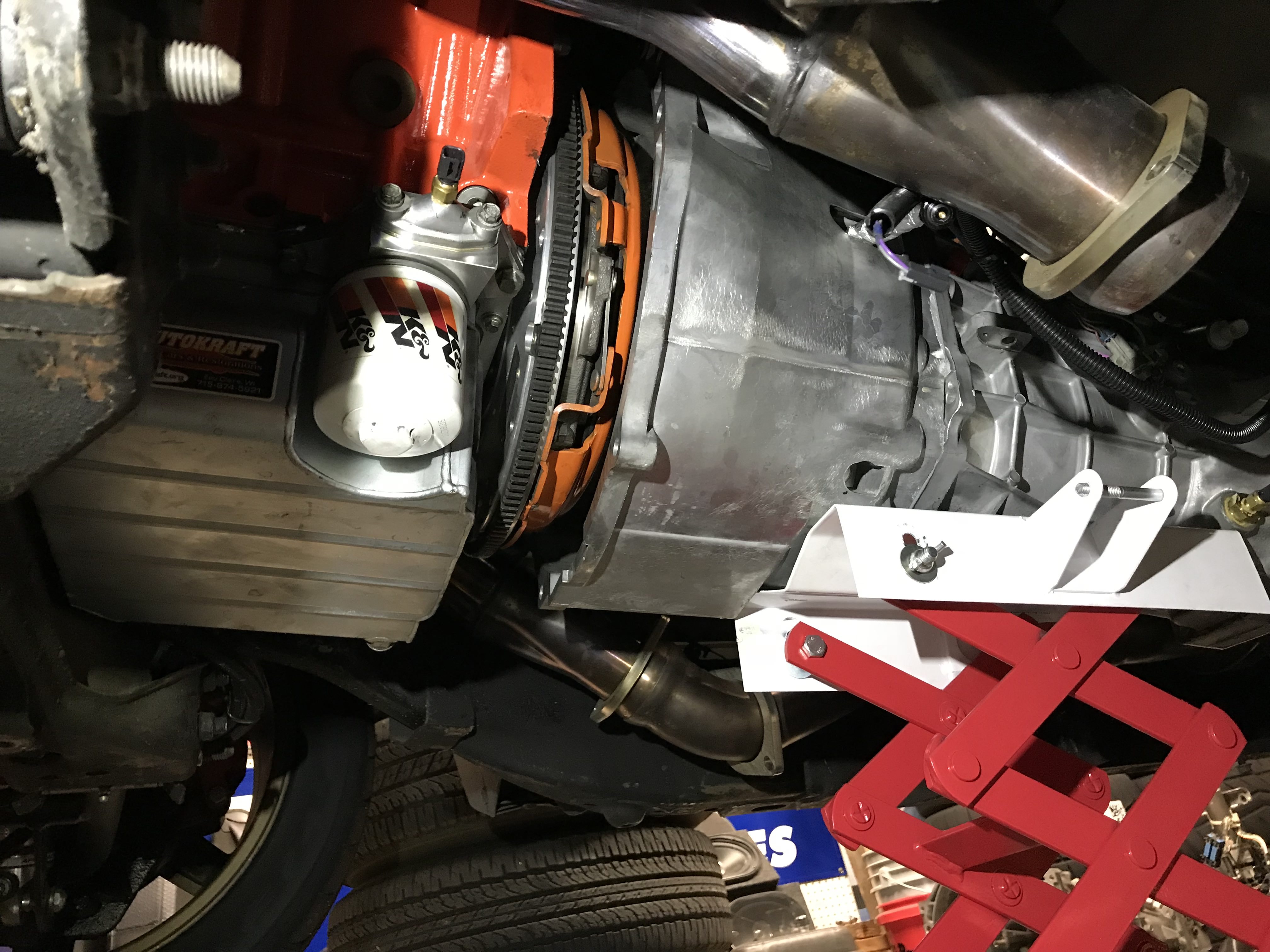

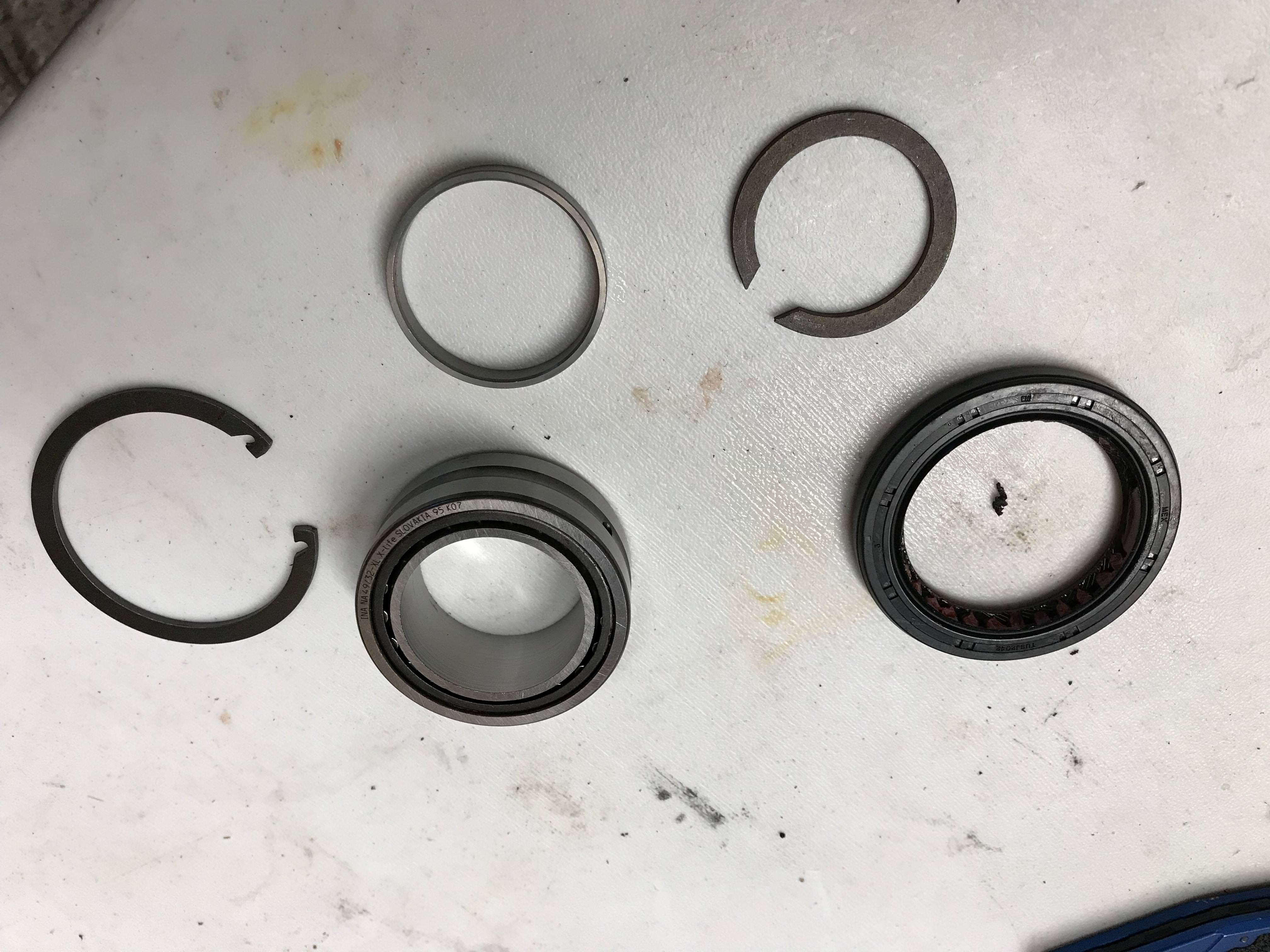

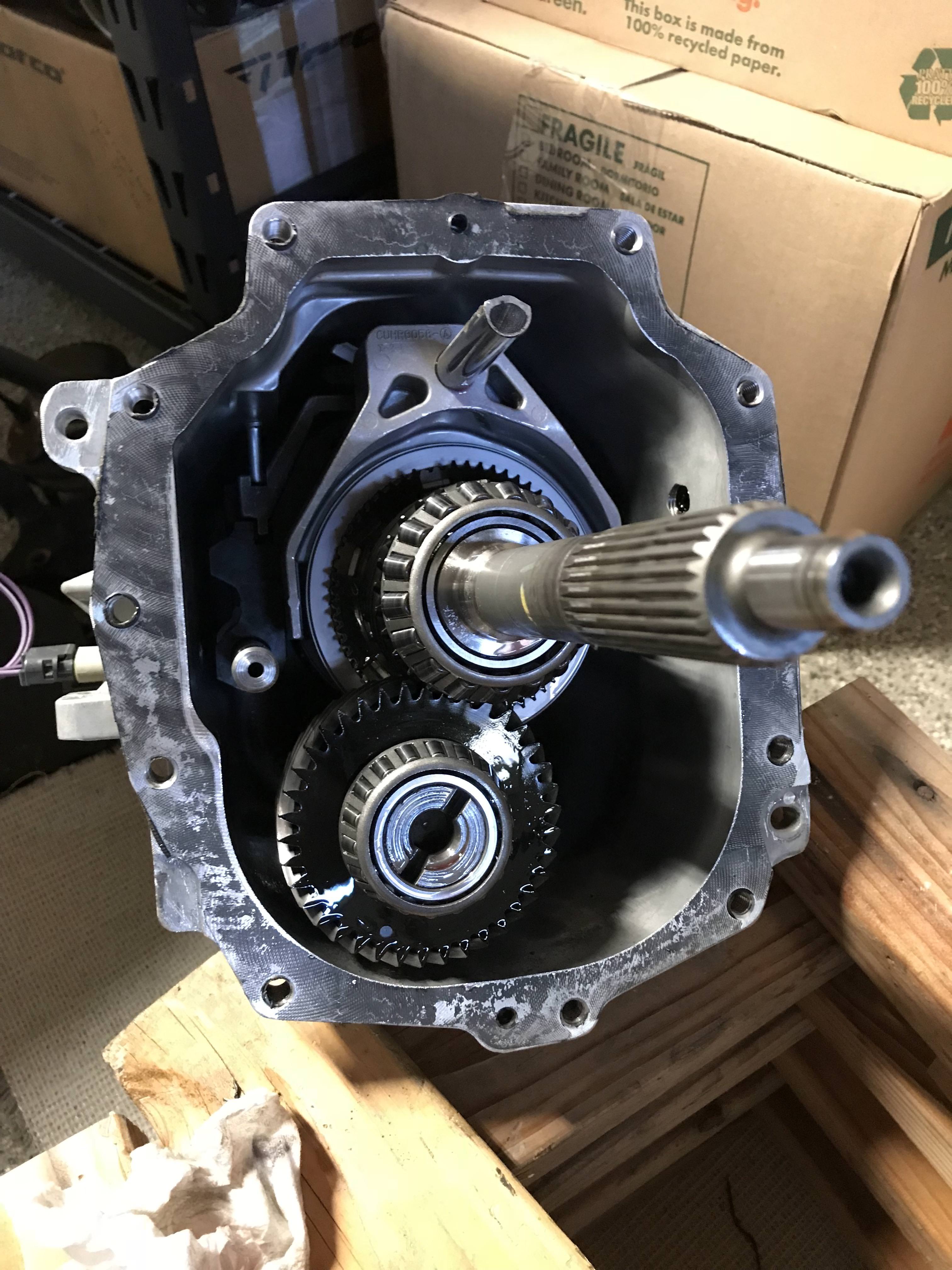

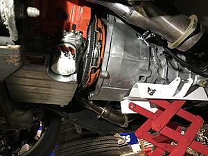

I have the transmission back in one piece and back in the truck. It was installed with a new Centerforce throwout bearing and a bronze pilot bushing. While I had the transmission out I took the time to pull the front cover off the transmission and make sure the nothing else was damaged when the pilot bearing failed. Everything in the front of the trans looked ok so that was re-assembled and I finished getting the output shaft bearing kit put in. One of the snap rings and a spacer were missing from the kit so I had Rockland send those out.

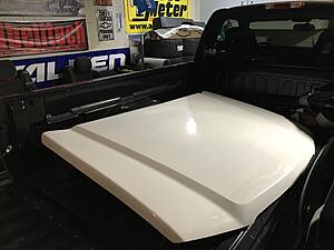

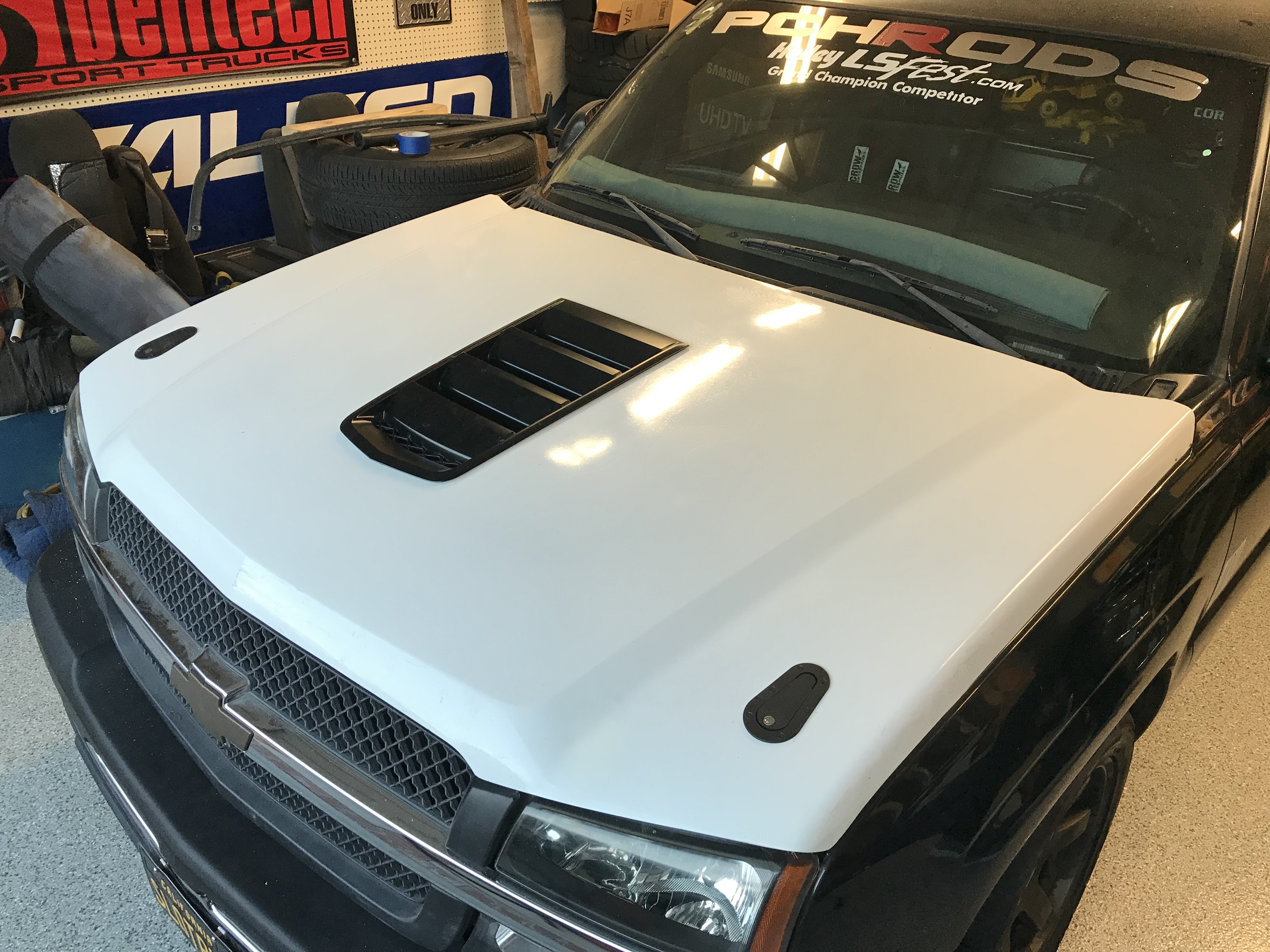

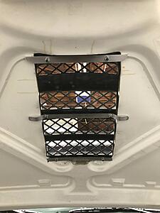

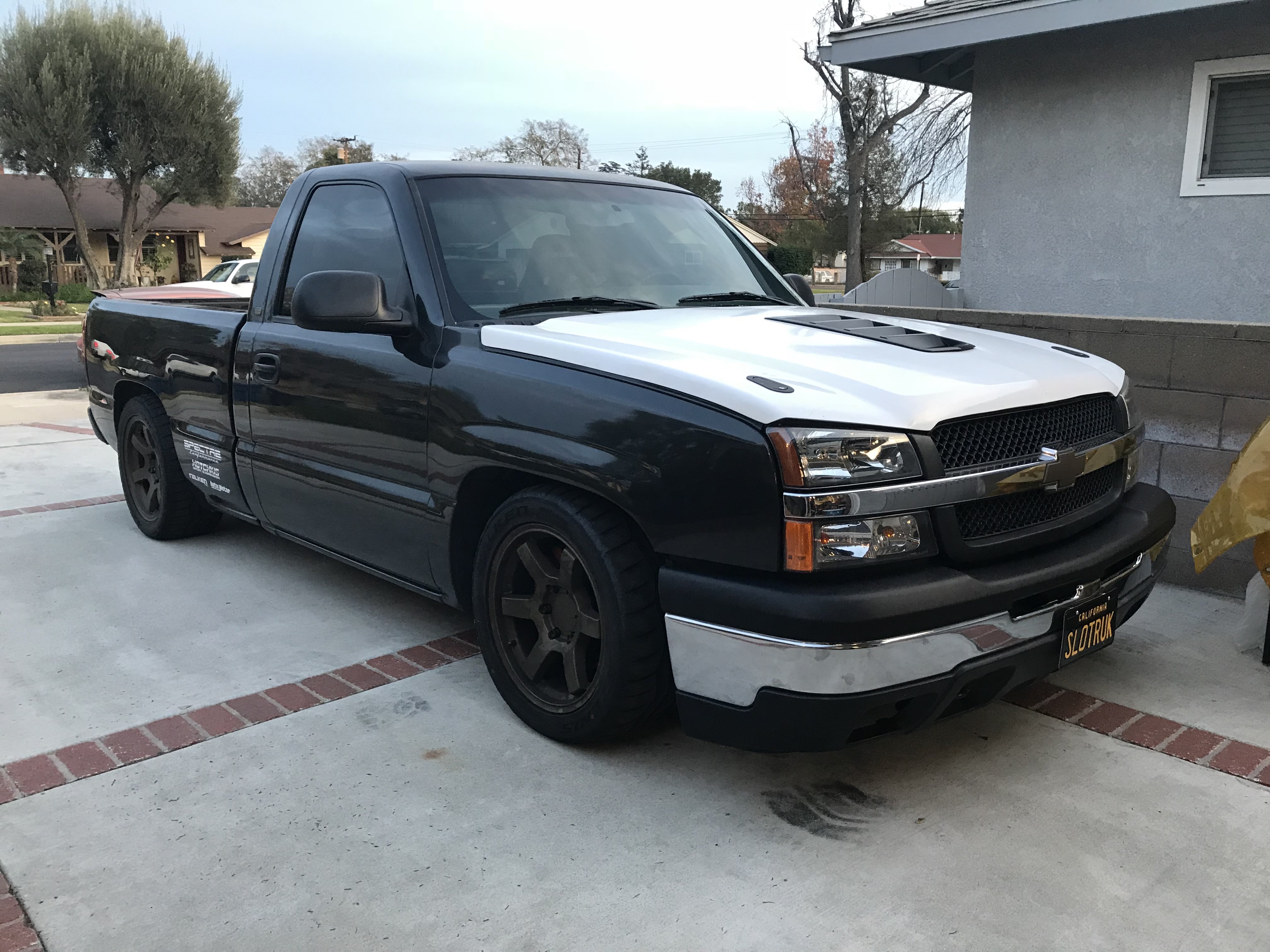

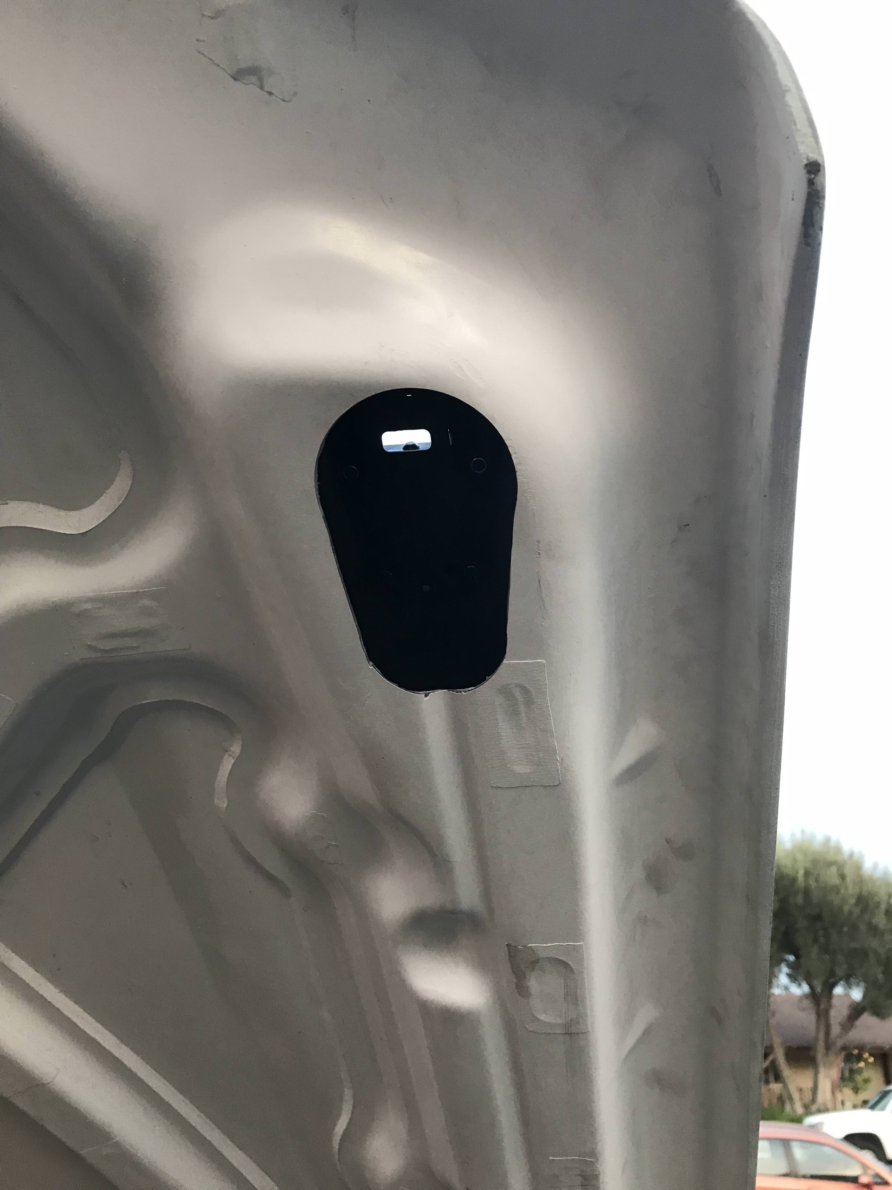

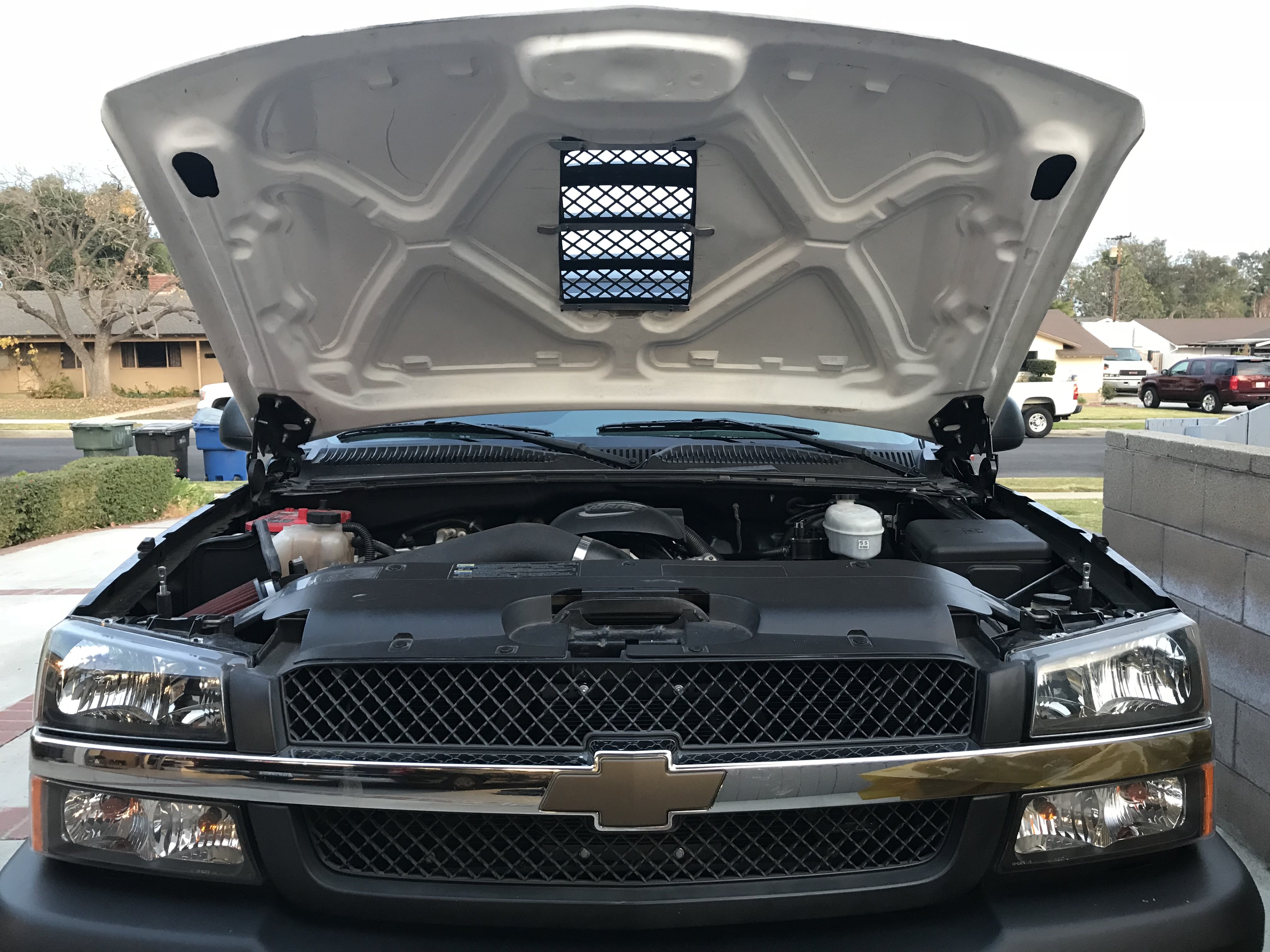

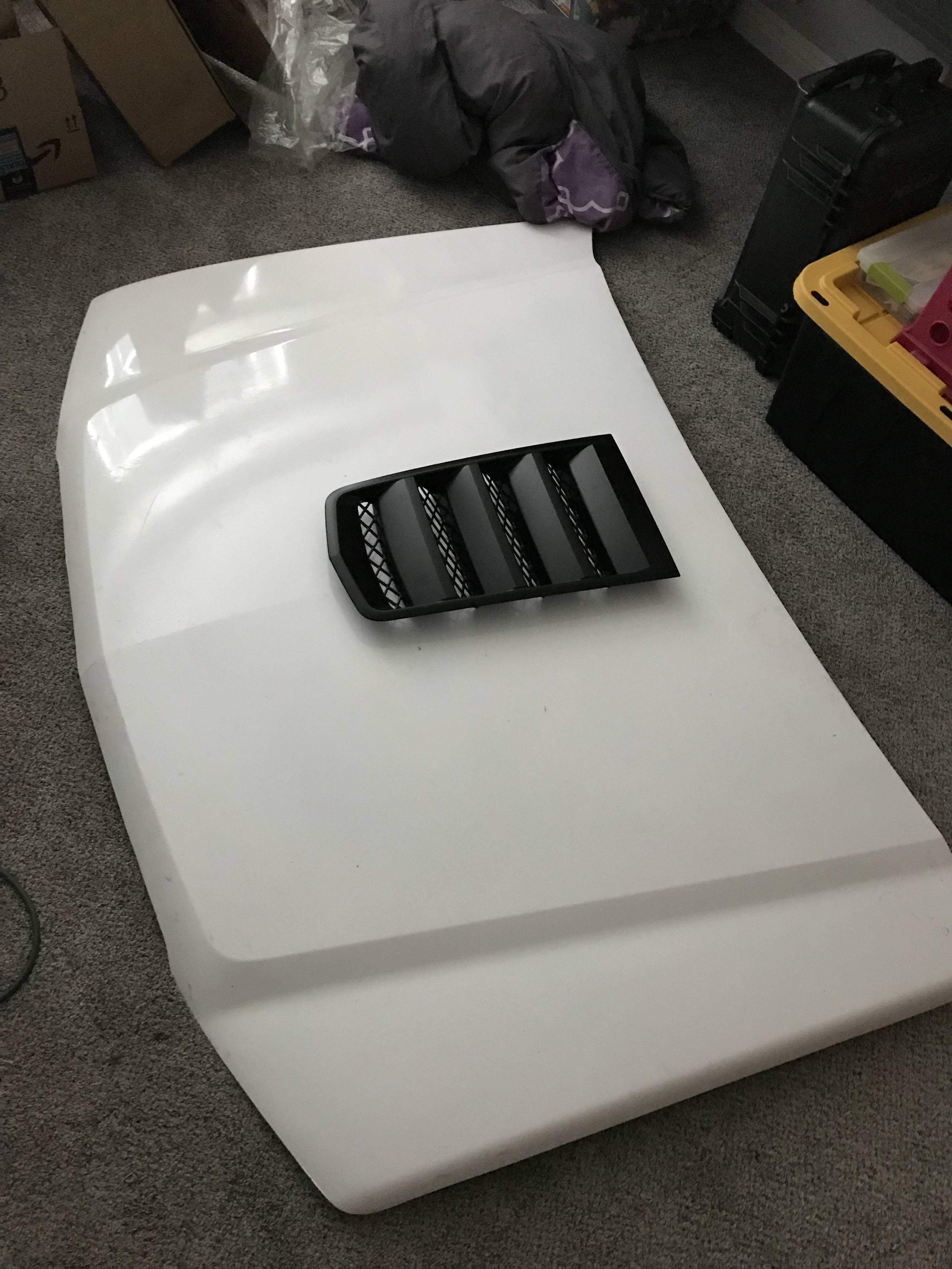

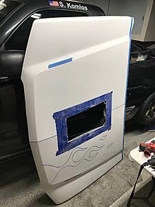

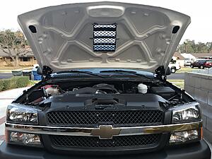

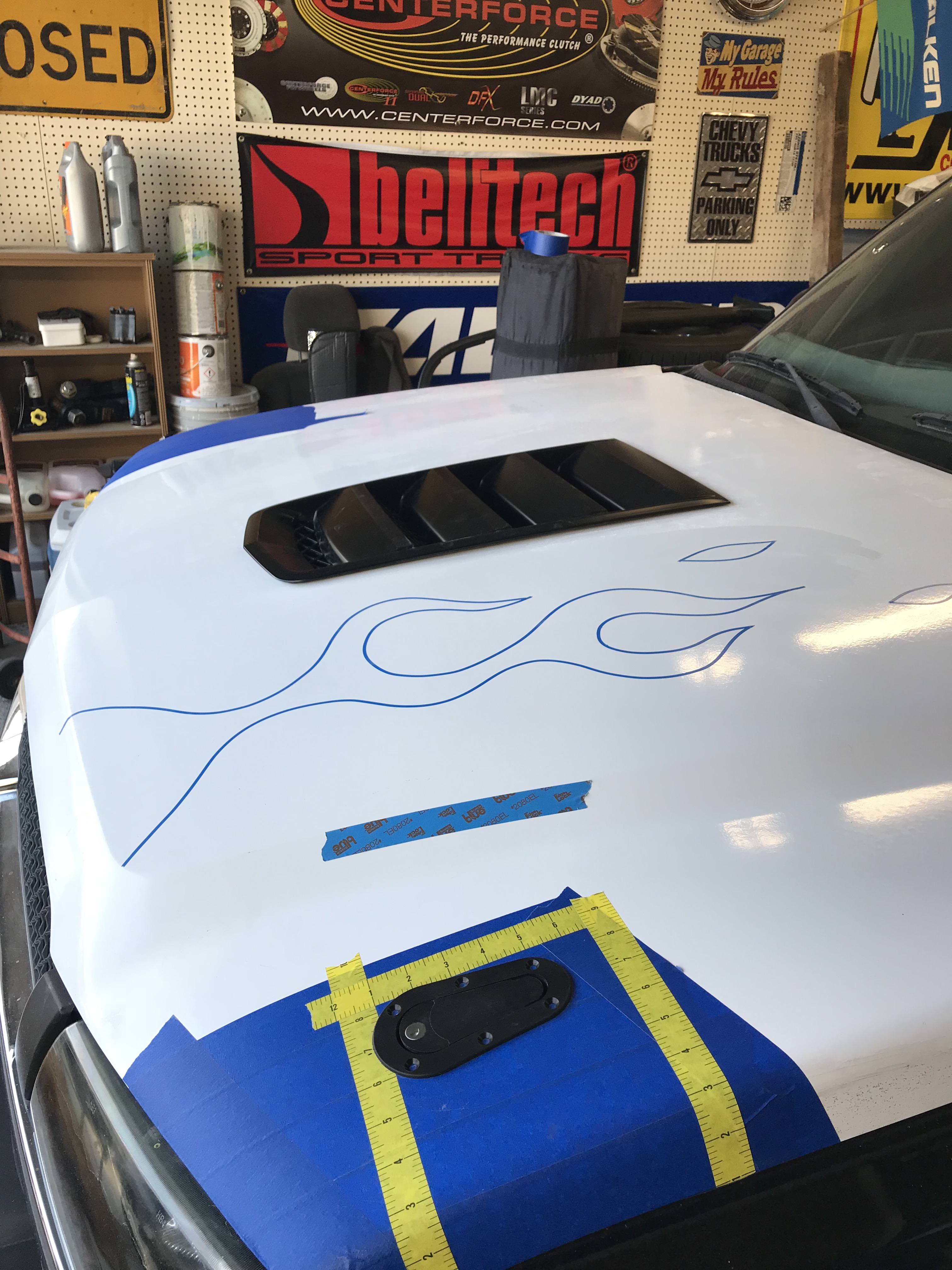

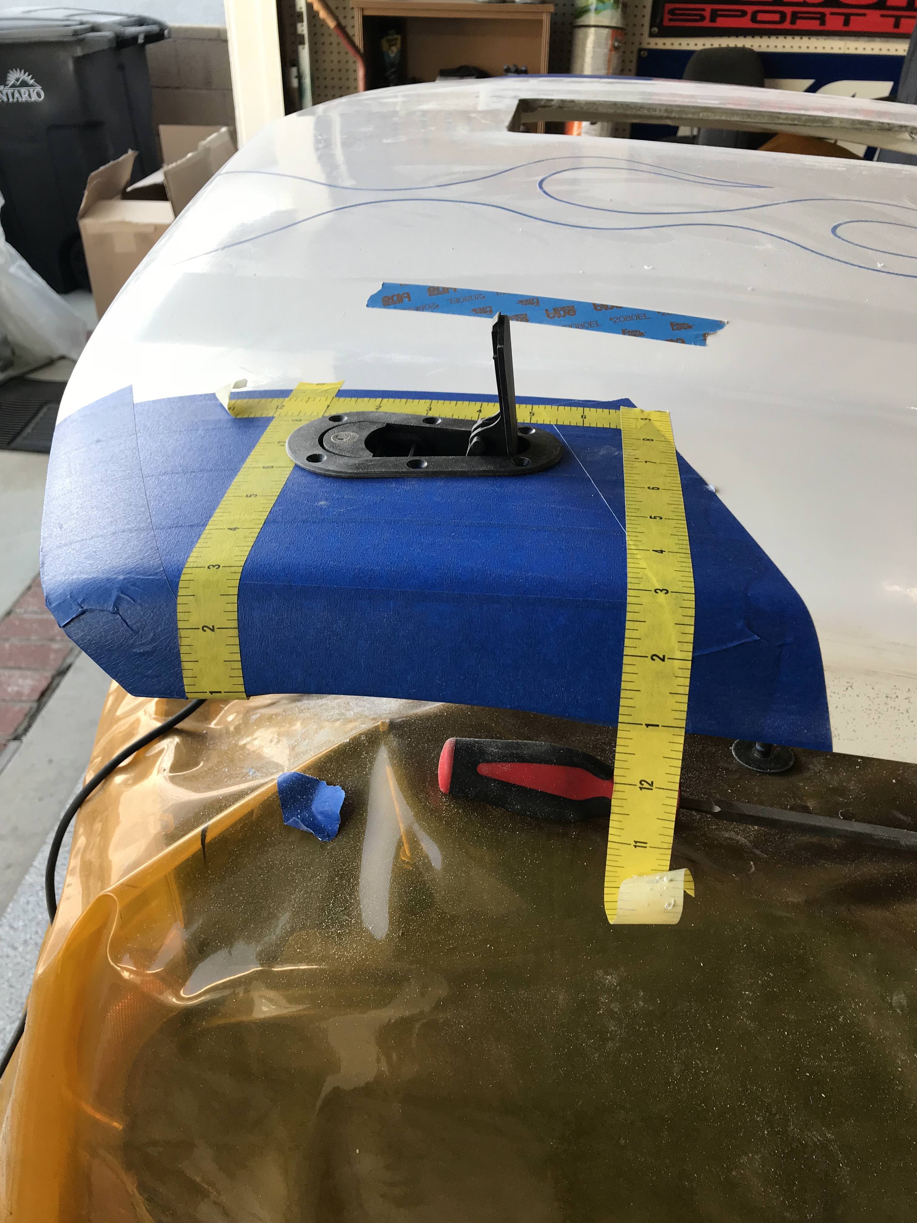

I also finally got my fiberglass hood on the truck. Not wanting a cowl/drag race style hood I ended up finding McNeil Off Road had a fiberglass stock replacement hood for the 03-05 trucks. The fitment is pretty good and it bolts up to the stock hinges. Mc Neil says it can be made to work with the factory latch as well, but I didn't want to cut the rivets off the stock hood hinge catch in case I had any problems with the glass hood. From the start of the hood project I wanted to install a Z28/1LE Vent extractor so I found a GM one while searching eBay.

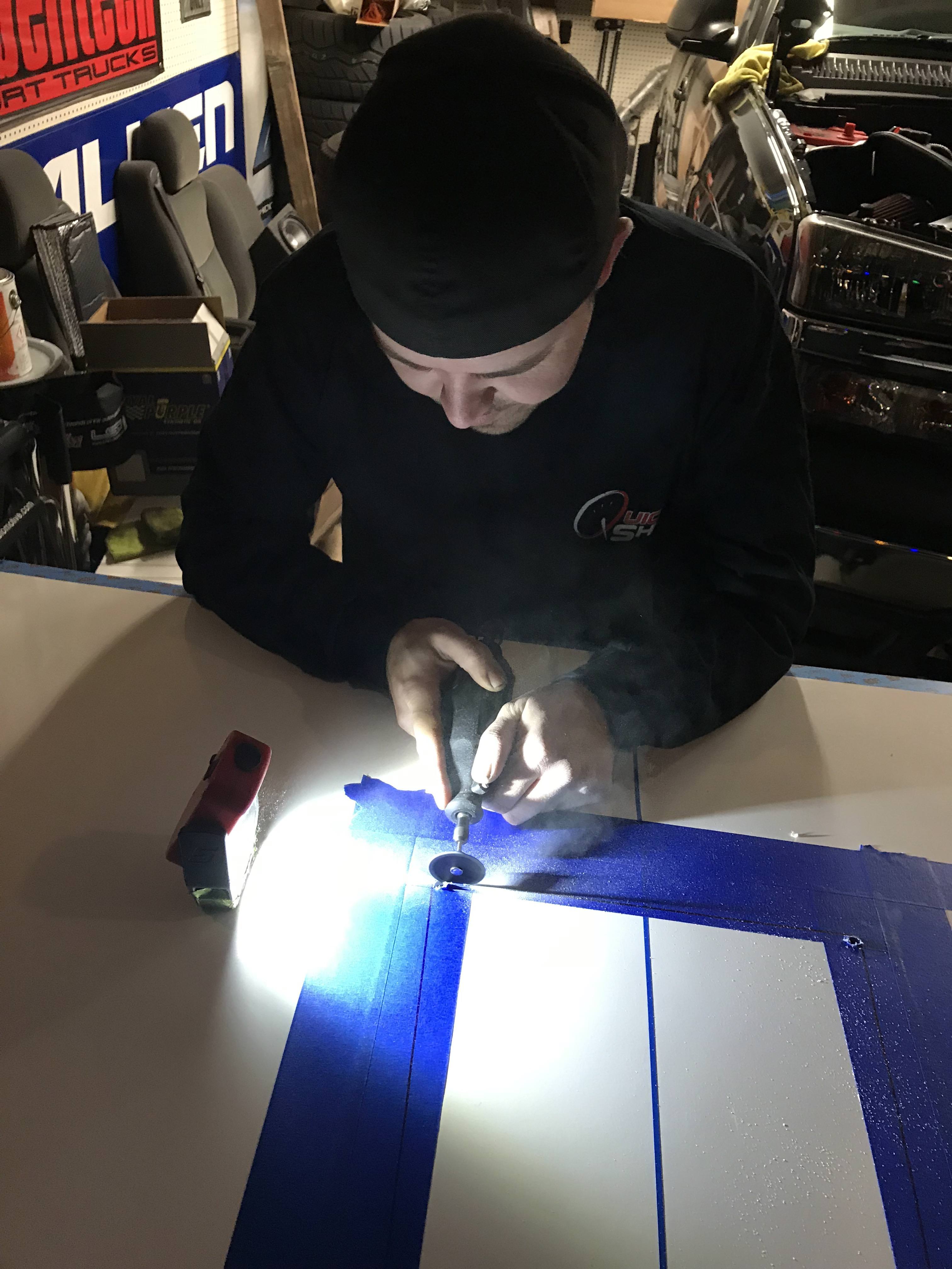

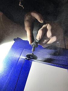

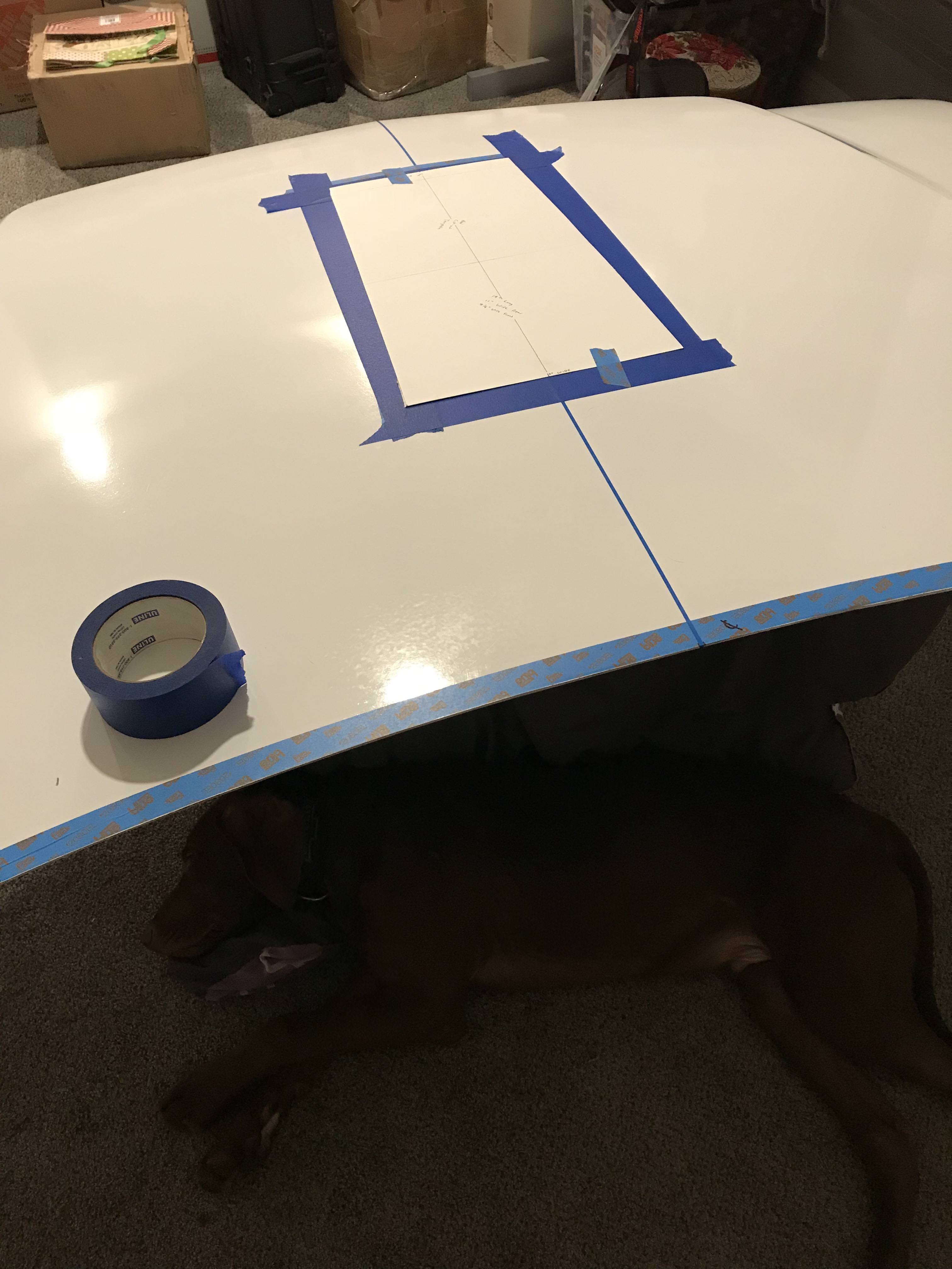

I ended up pulling the stock latch off completely and saving it with the old hood. I found a good deal on a set of Aero Catch Latches to keep it in place. I opted for the steel pin/locking versions for added security. Now that I had all of the pieces it was time to start cutting... Measure ten times and cut once.

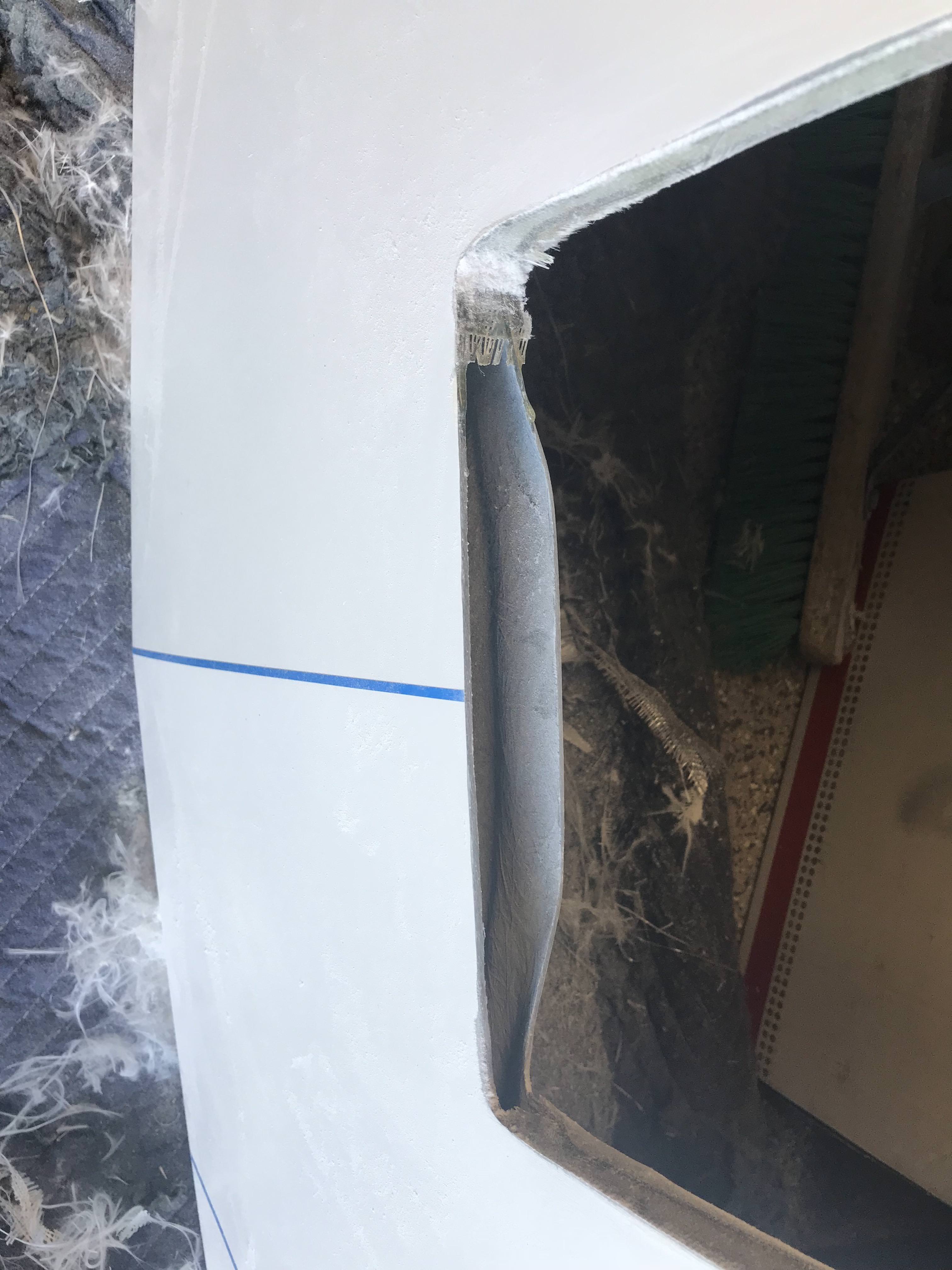

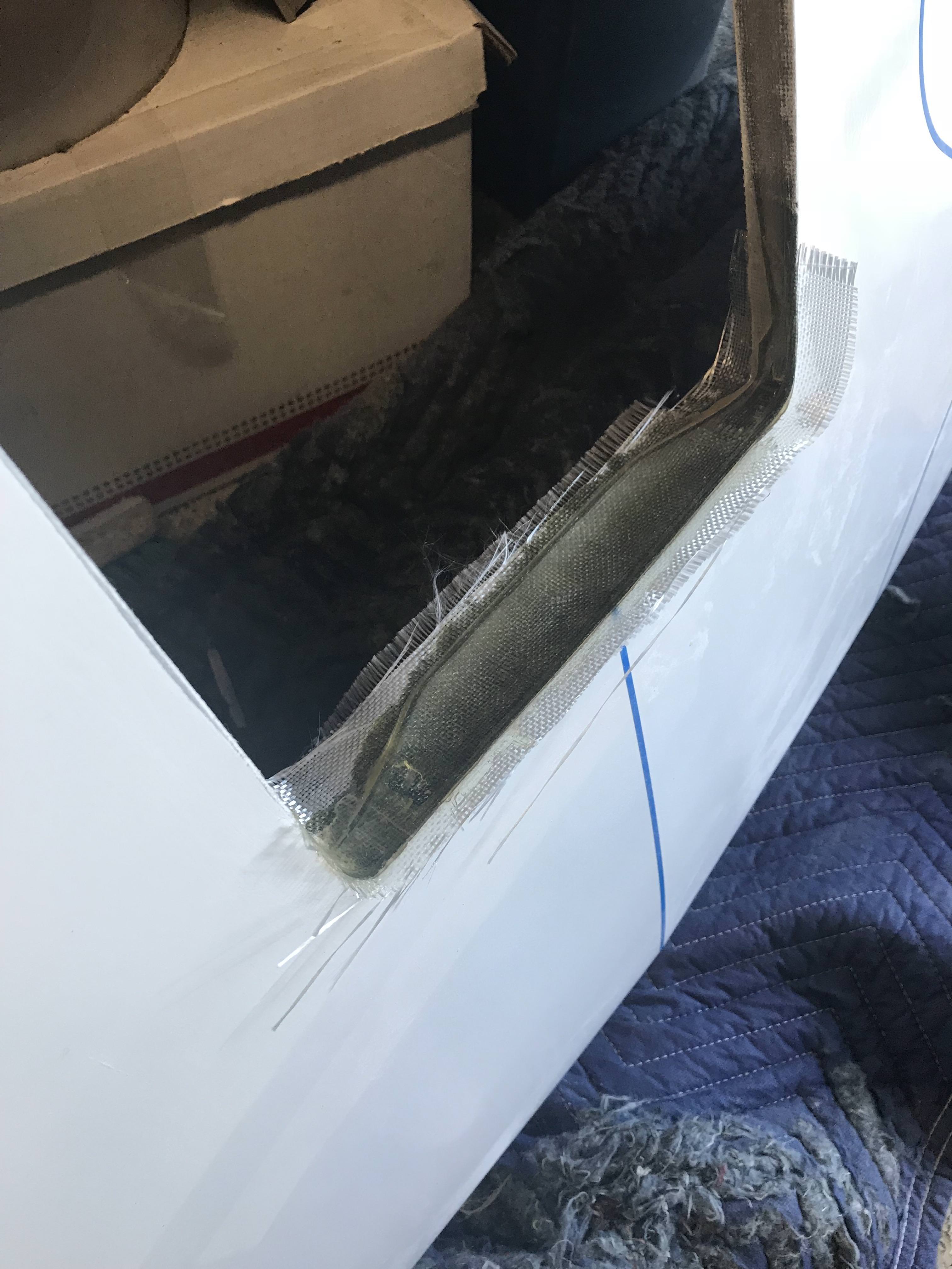

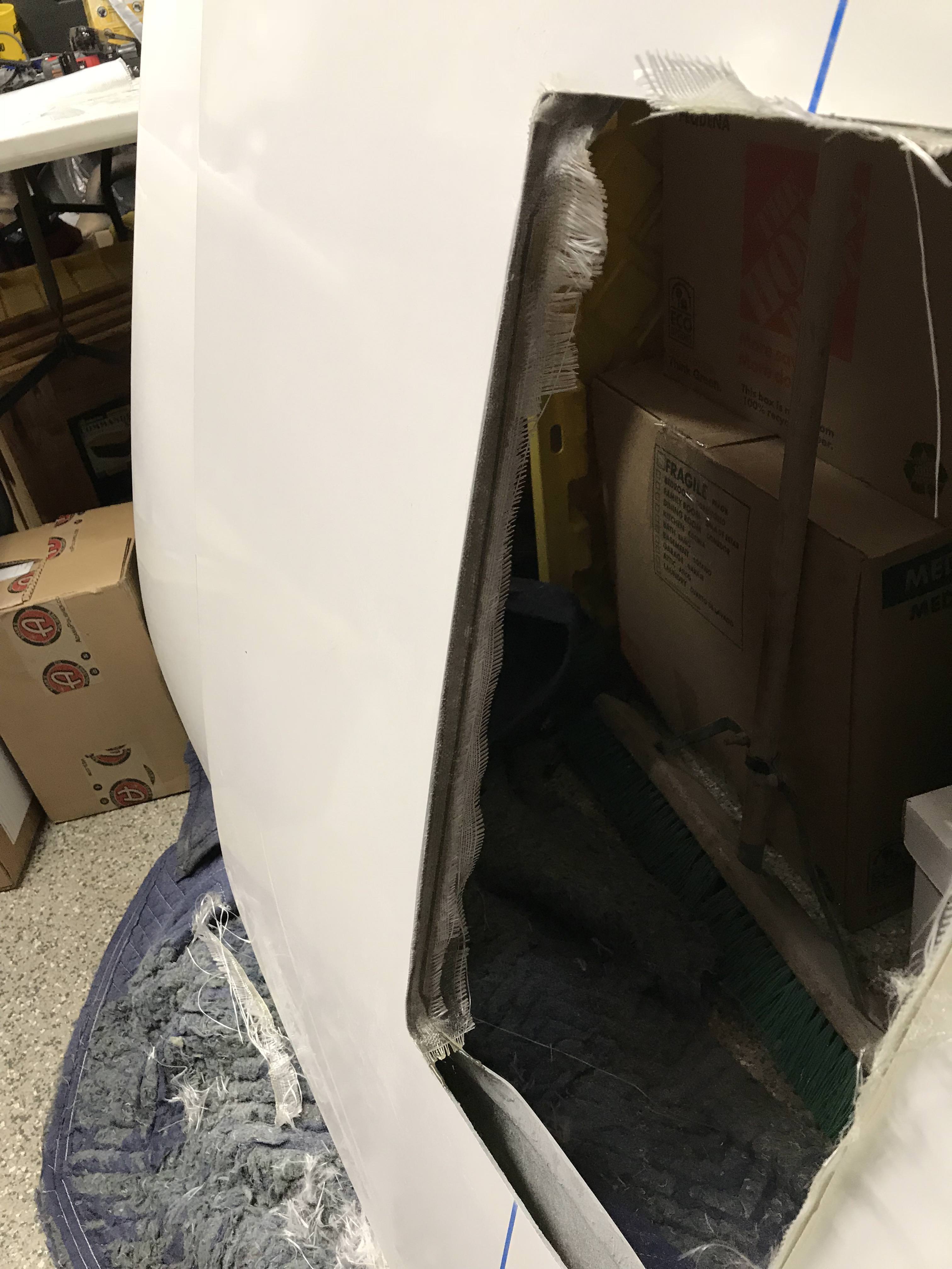

Not wanting the hole for the vent to look like an after-thought, I decided to fiberglass in the opening to help the hood keep it's shape and strengthen it back up. That was my first time playing with fiberglass and it wasn't too bad. knowing it was going to be a sticky, itchy process I kept covered up and it kept the scratching to a minimum.

I'm really pleased with how the hood turned out. Now I just have to figure out what to do about the mismatching color... Maybe a color change coming to the truck soon.
