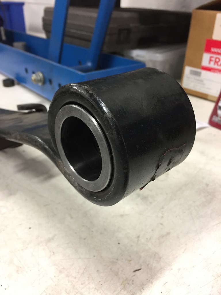

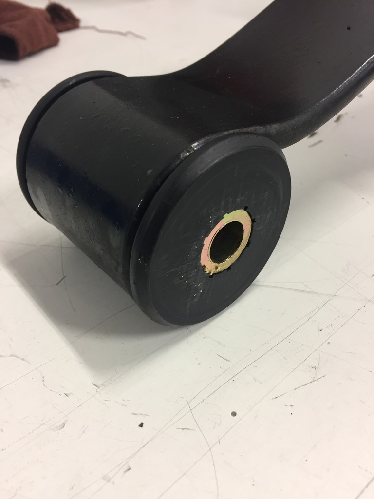

While I'm waiting on shocks I got started on the leaf springs. Sticking with the rear leaf springs for now. Just going to try and make them work as well as I can for what I'm doing with the truck. A 4 link and coil-overs may still be in the future, but for now they'll have to wait.

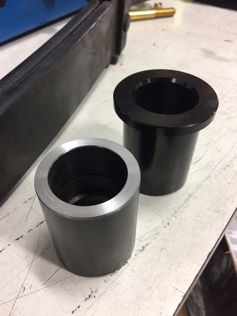

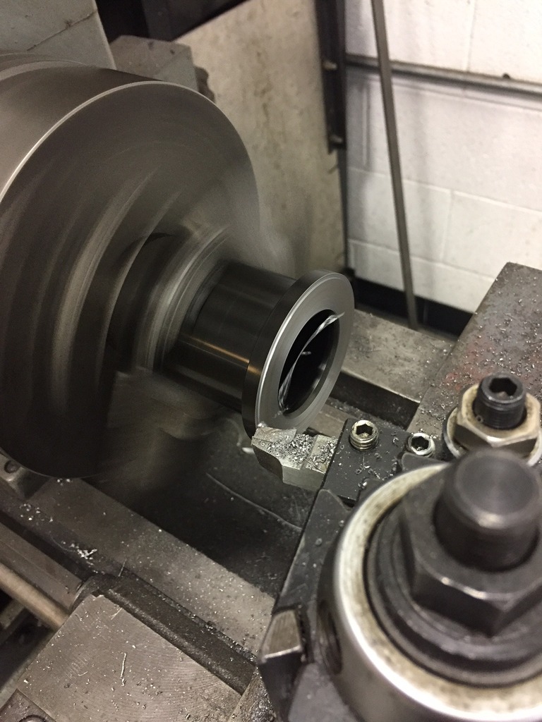

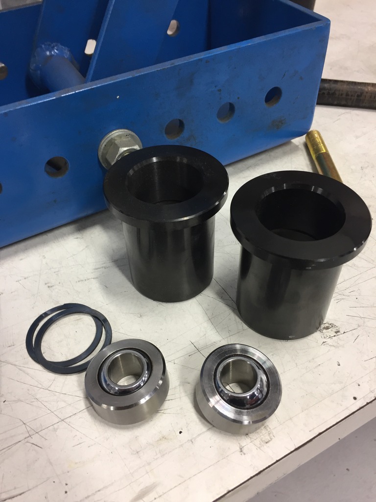

Going with a slightly modified version of our Hotchkis Swivel bushing kit and possibly adding a leaf from the set of dodge leaf springs I found along with the overload spring. The front of the leafs will get the modified swivel bushings, the rear of the leafs will have new poly bushings and I'm going to machine up some more delrin for the shackles.
Had to turn down the collars to clear the spring pockets.

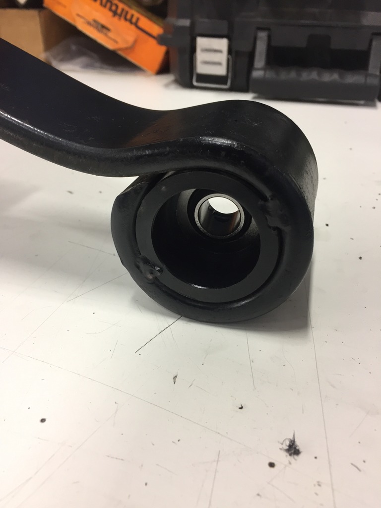

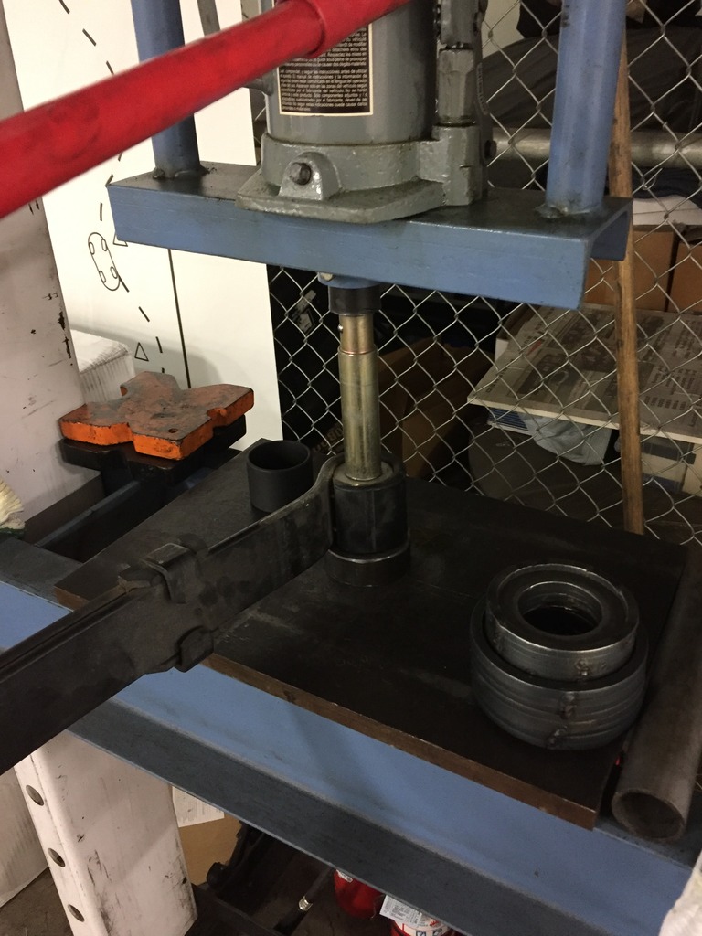

Pressed out the solid bushings.
And the new bearing retainers pressed in:

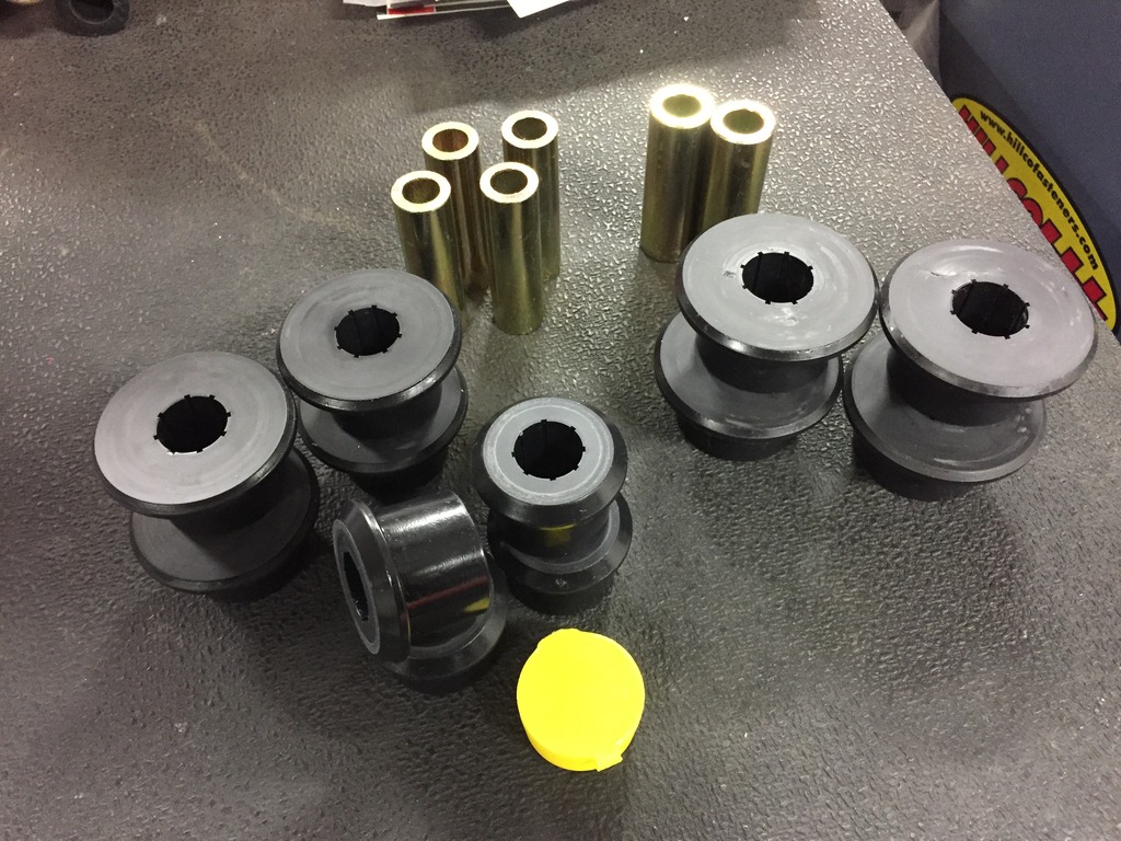

Energy suspension leaf spring kit, Sadly I'll only be using the rear leaf bushings and the sleeves.
Going to get the rear springs pressed out this week and then tack the front sleeves in place just to make sure they don't go anywhere. Then I'll get the passenger side spring back in and do the same to the driver's side.

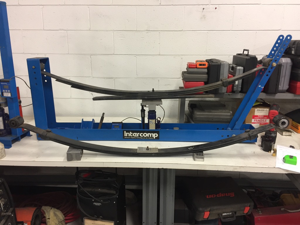

Got the other leaf spring finished up this week and ready to be installed. Hoping for a break in the rain we have been having to be able to install them.

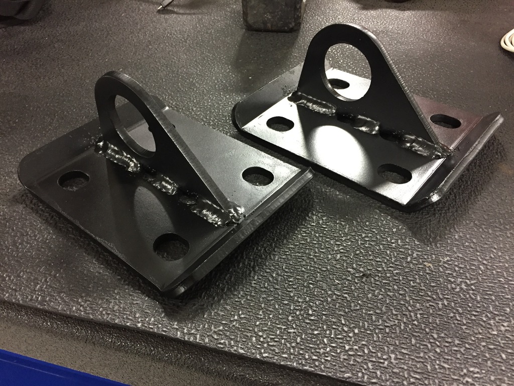

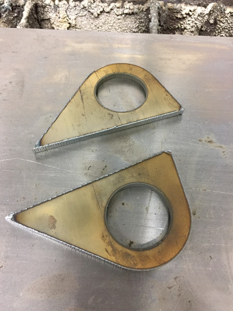

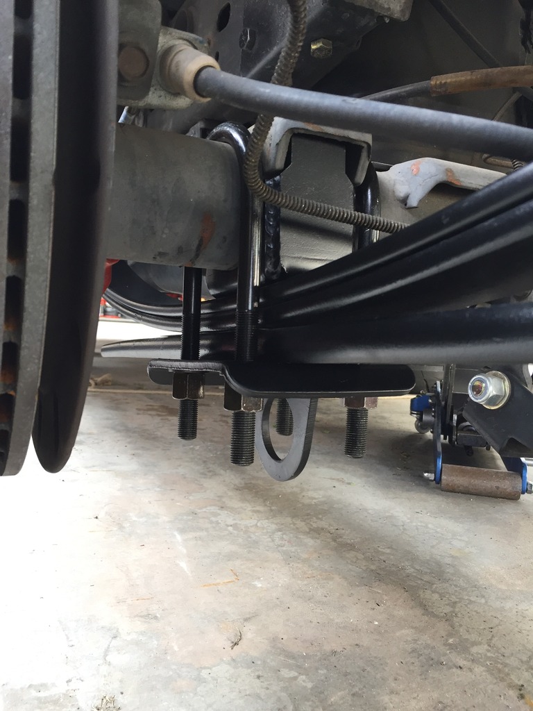

Also decided while I had the U-bolt Plates out that I would cut out some tie-down hooks and weld them on.
Luckily I had a few hours of better weather to work with and got the leaf springs back in the truck. Still need to trim the ends of the U-Bolts, but I am going to wait to see if I need any pinion shims.

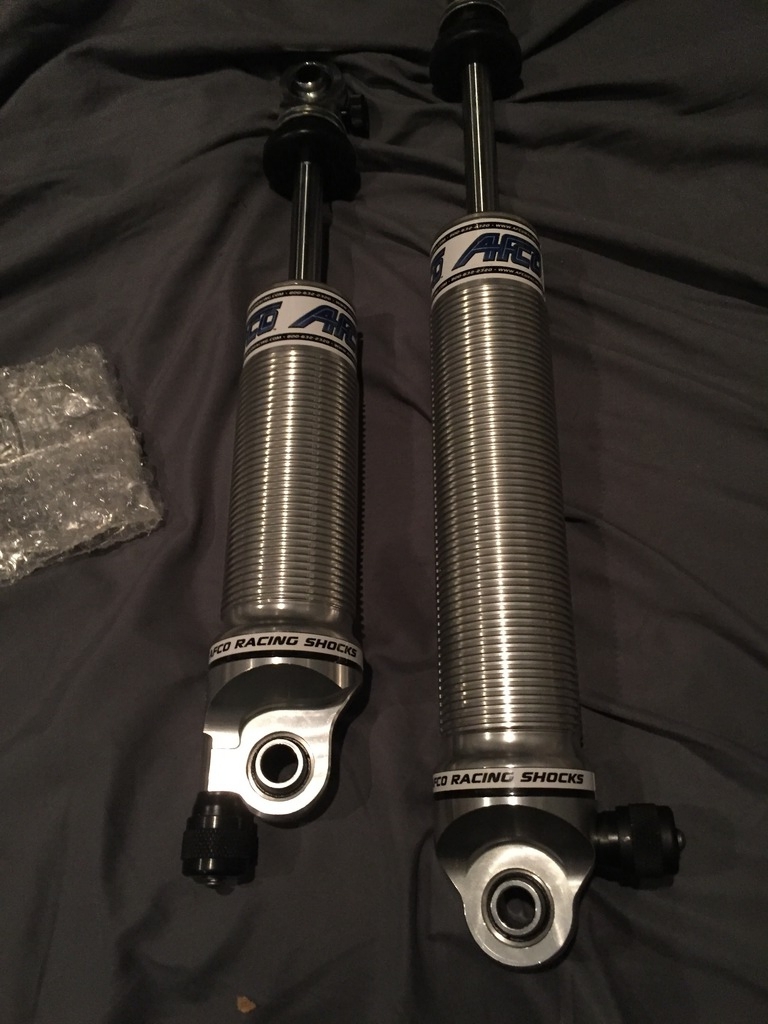

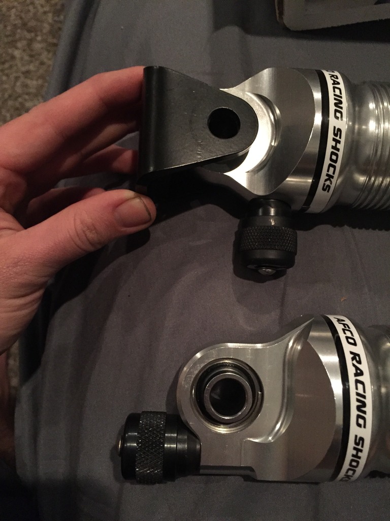

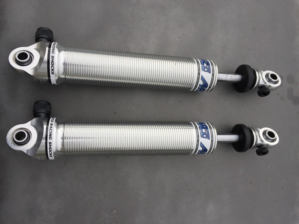

When I got the shocks in a few weeks ago I found that the fronts had the wrong bodies on them. (compression adjuster on the bottom instead of on the side) so I sent those back to have them swapped out. Still waiting on them to come back from Afco.

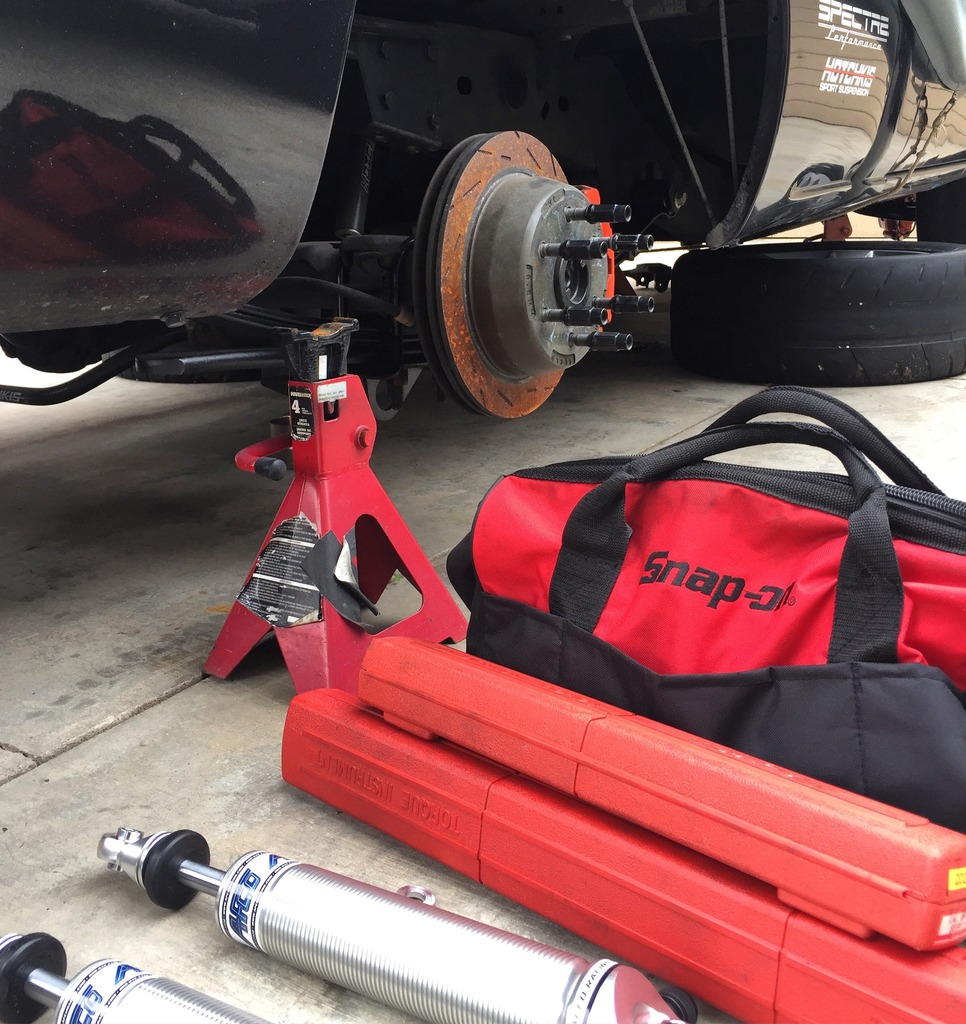

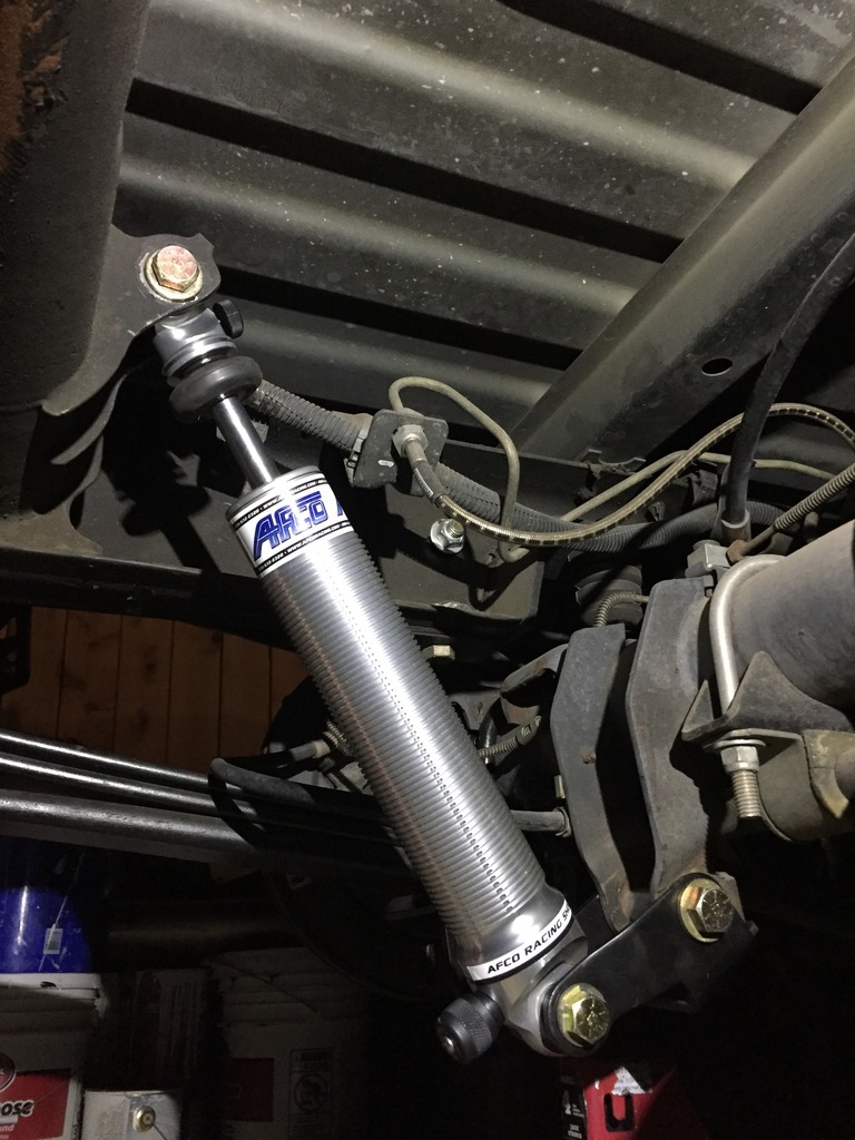

In the meantime I got the rear's installed after I made some reducer spacers for them. (1/2 bolts in 14mm holes) I still need to modify the shock extenders to make sure they don't loosen up again.

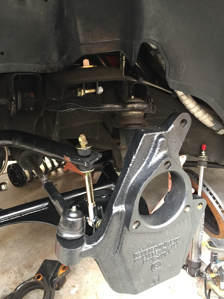

Once the front shocks come in I can get the new hubs on and take it to work and align it. Unfortunately I also have to smog the truck by the end of the month too... Also kinda hard to do without the truck drivable. Stupid California... End rant.
