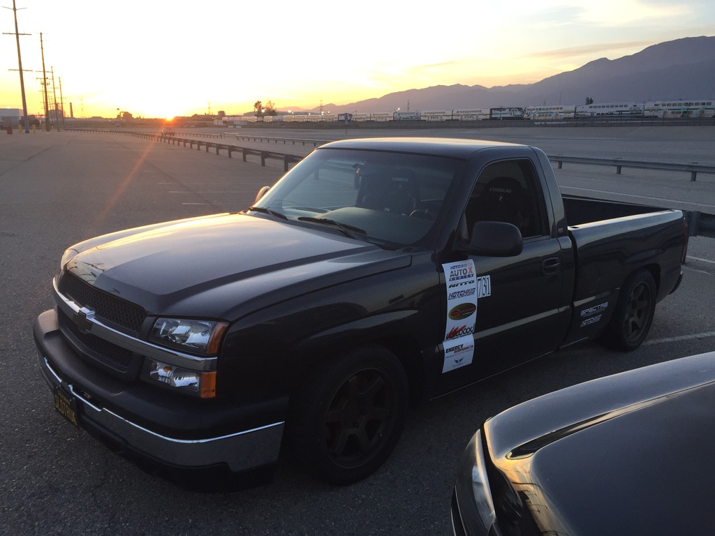

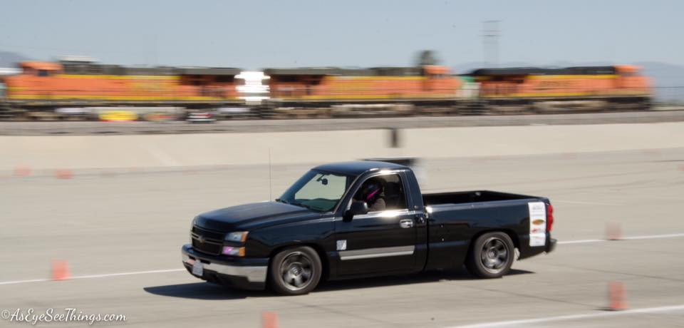

Belated update from last weekend.
Took the truck out to the NMCA event and got to finally push it. The truck was working pretty well (suspension wise) and didn't do too bad. Still need to spend some time dialing in the shocks, but overall she was working great. Now that all of the suspension issues have been sorted out, the next hurtle is the trans swap. I am signed up for LS Fest West and would really like to bring the truck out with the manual swap done. It's going to be a close one, but I'm going to try.
Here's a few pictures of NMCA shot from my phone. Still going through pictures on the nice camera. Those will be posted when we finish going through the cards.

Looks like you have a lot of negative camber on the front. Is that intentional? If so, how much?
The front's got about 1.8* negative right now. It is intentional. I would like an even -2*, but I'm limited with the stock upper control arm bushings and cam bolts.

How is the steering response with that much camber? I have mine set at one degree negative and it feels less responsive right off center then about a 1/4 turn in bites real hard. I did a lot of changes at once so trying to pinpoint what it may be.
Initial Turn in bites pretty hard. The stickier tire likes a little more camber than a normal street tire.
Wondering if you are noticing some slop in the steering rack. With the slower ratio I could see some of the lag. I would like to quicken up the ratio on my steering to help it out a little more. Another one of the many projects.
