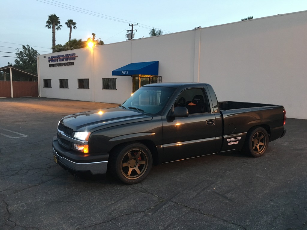

Finally made some progress on the truck this weekend. After waiting on parts and being preoccupied with house hunting and working on other projects, she's finally down on the ground again.

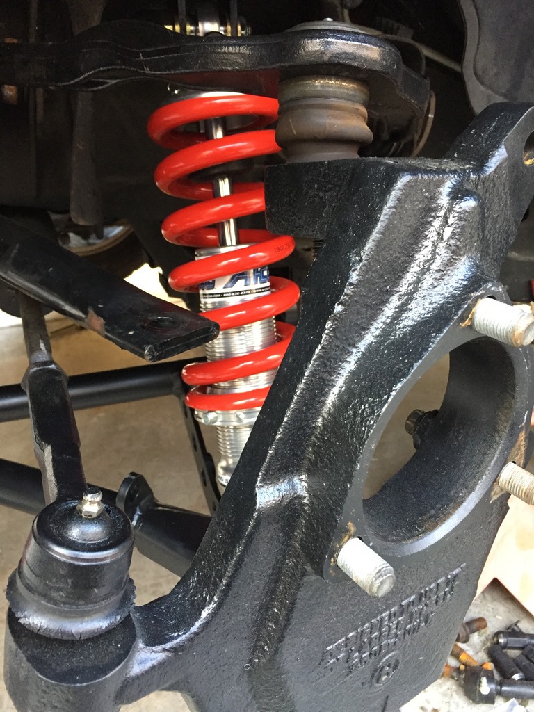

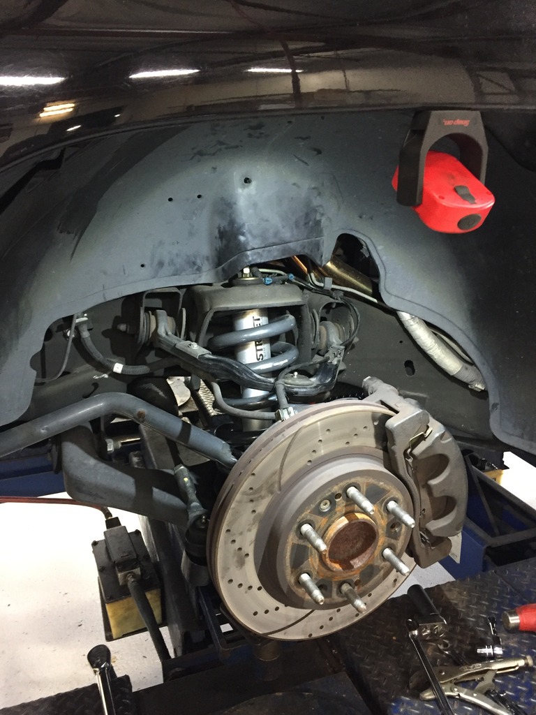

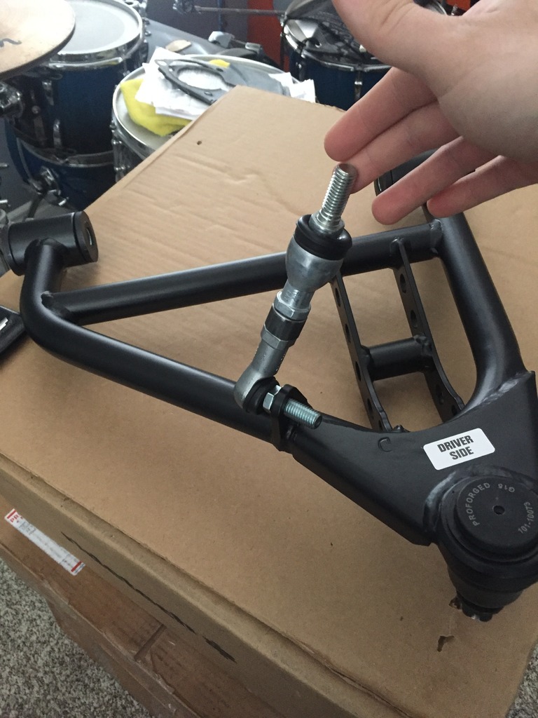

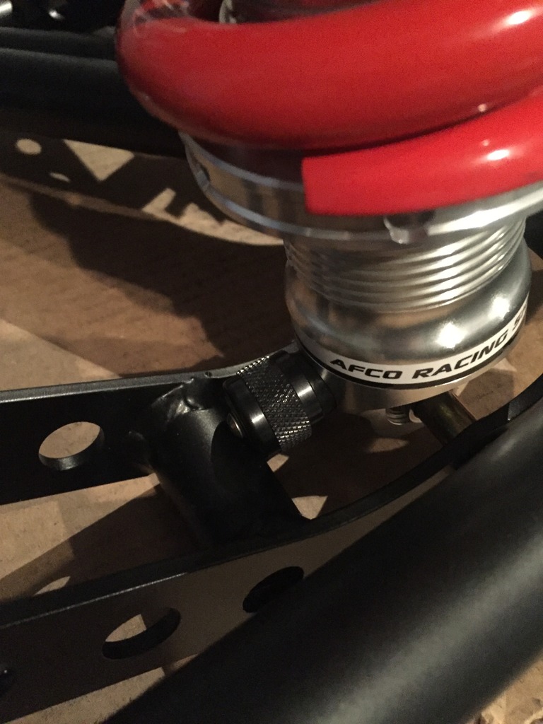

Ended up finding an issue with my modified DJM control arms. I wasn't happy with where the shock was sitting at the desired ride height. So I bit the bullet and ordered a set of RT Strong Arms. They were delivered on Friday along with a set of Atomic's seat brackets.

Had a clearance issue with the adjusters on the lower arms, but cut out the brace and replaced it with a grade 8 bolt and sleeve.

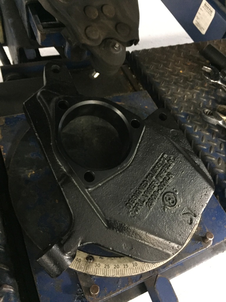

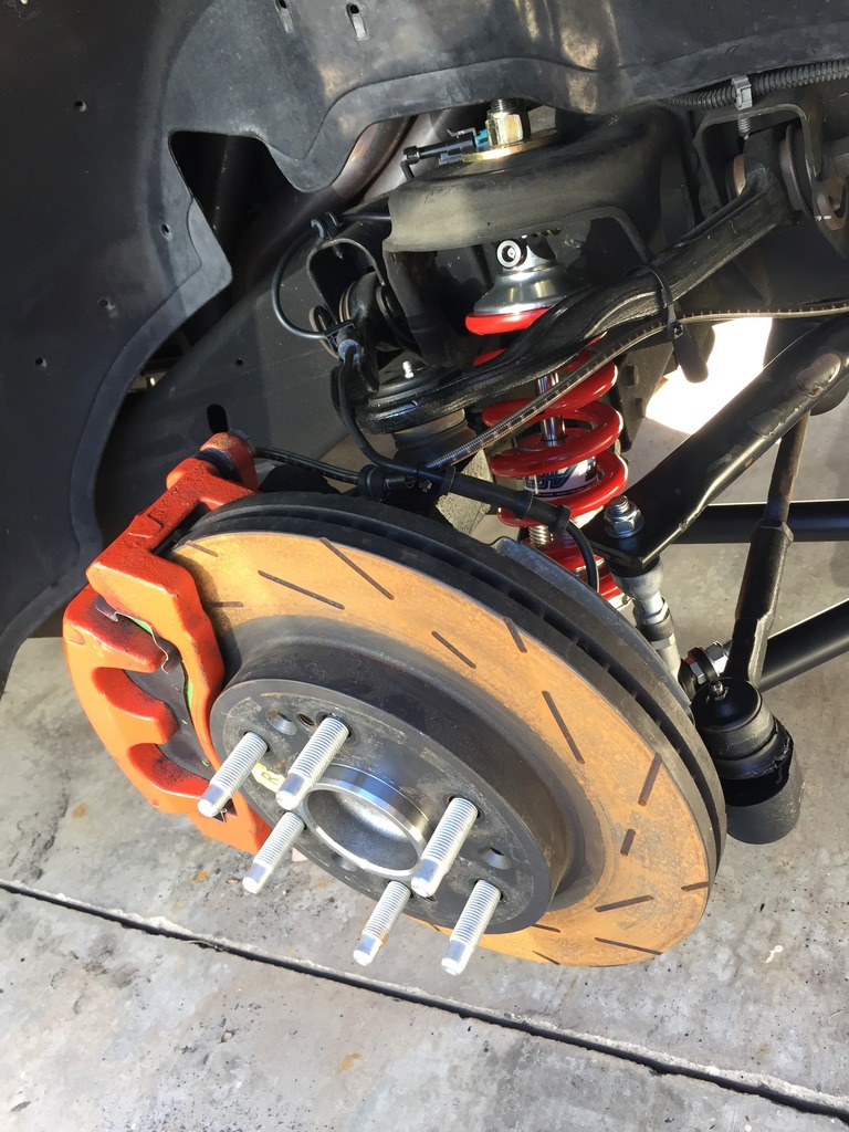

Got everything installed and torqued up. New hubs and Belltech spindles installed with the coilovers. Just need to fine tune the ride height and take the truck into work to align it.

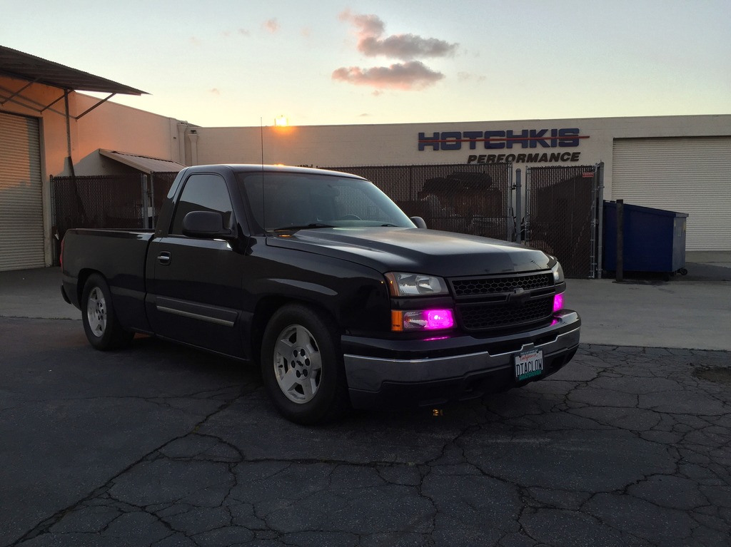

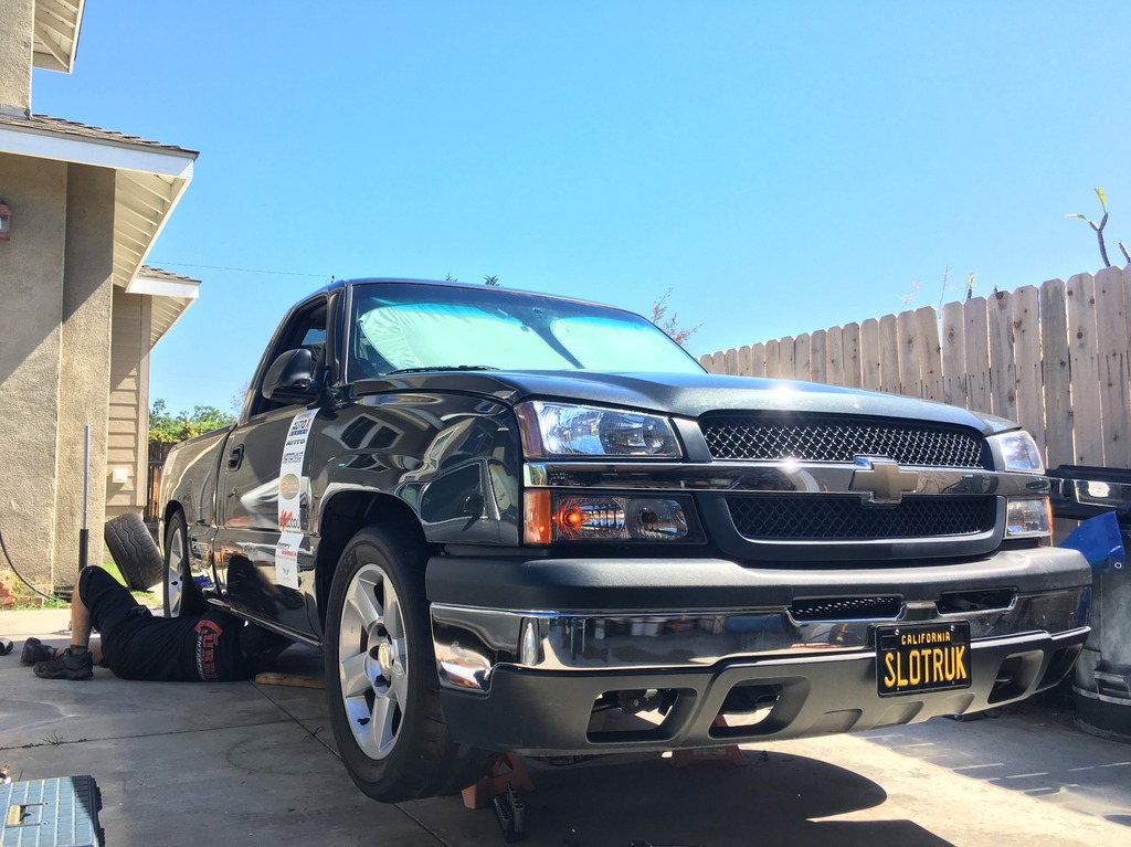

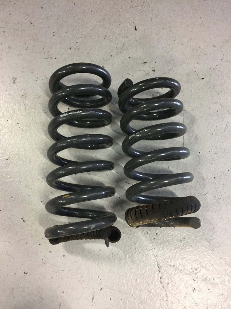

Claudia's truck got some love too. Different springs up front along with a set of Belltech Spindles are in the truck now. Just waiting for her shocks to get here and we'll get those installed. Would like to make it out to an autocross next Sunday, but it's still TBD.

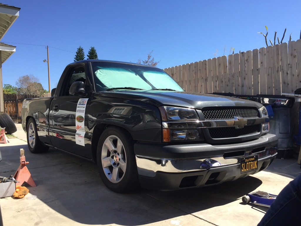

Got to drive the truck for the first time in what seemed like forever.
Very happy with it so far. I brought it in to work to get the alignment done and get a few other things checked off the list. Re made a different exhaust hanger and turndown for the magnaflow and trimmed and welding the shock extenders in place to keep them from moving around.

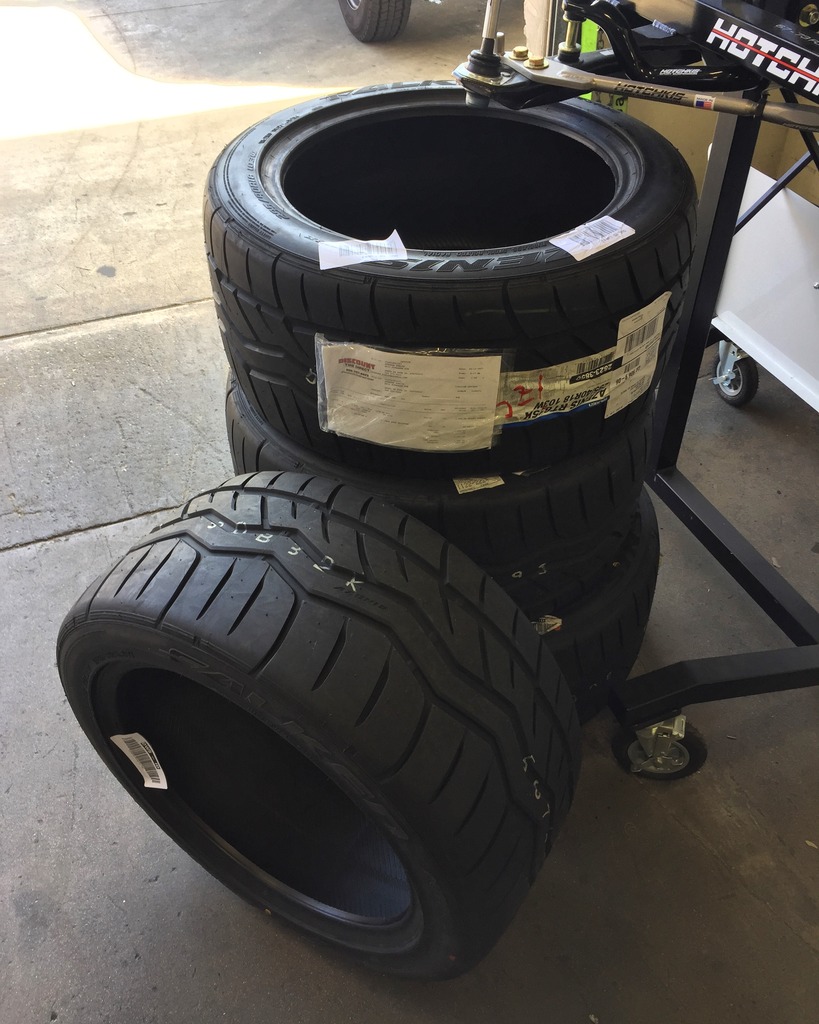

My new tires showed up and I was able to get them mounted and installed right after I was finished with the alignment.

I'm very happy with how the truck feels right now. Front spring rate seems just about perfect and there is still a lot of adjustment in the shocks to get it fine tuned.

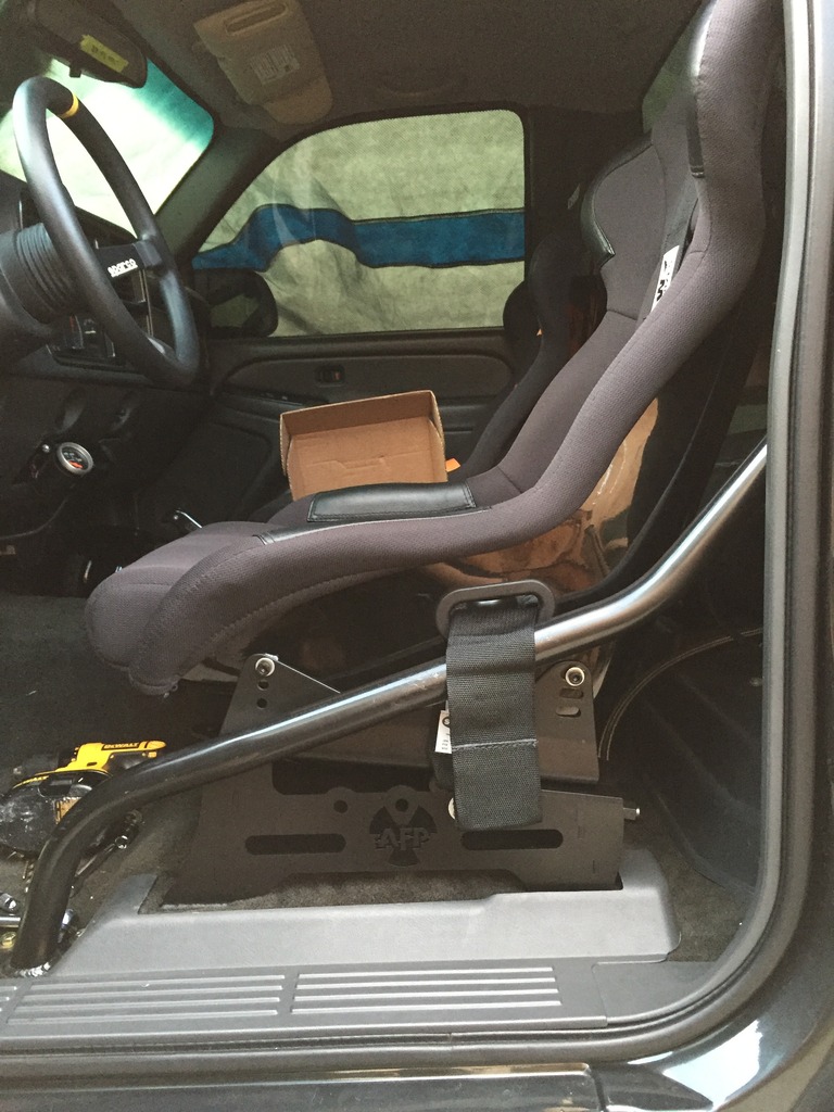

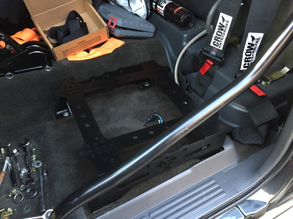

Got the driver's seat brackets in and the side mount brackets bolted up. Decided to drill another set of holes in the Atomic brackets for my side mounts. I may still do another set of side mount plates, but the old ones will do the job for now.

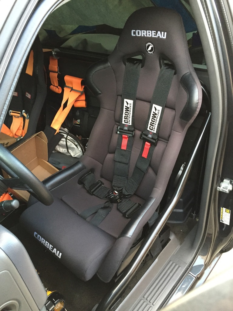

Also ditched my orange (now peach) latch-type harnesses for the set of Crow cam locks that Claudia got me for Christmas. Just needed a couple bolts for the brackets and I'll have the passenger side in too.
