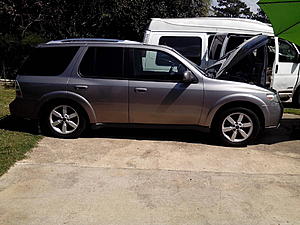

Sounds like the rear air bags leak if they drop 8in in the back when you shut the truck off.
The airbags are factory, it's a SAAB thing.

here she is just after turn off.
I removed intake manie/ all but 2 dir. side header bolts , none on Pass side.
removed wiper resuoir it had a bunch of hindin attachments
remove center rad. core surport.
