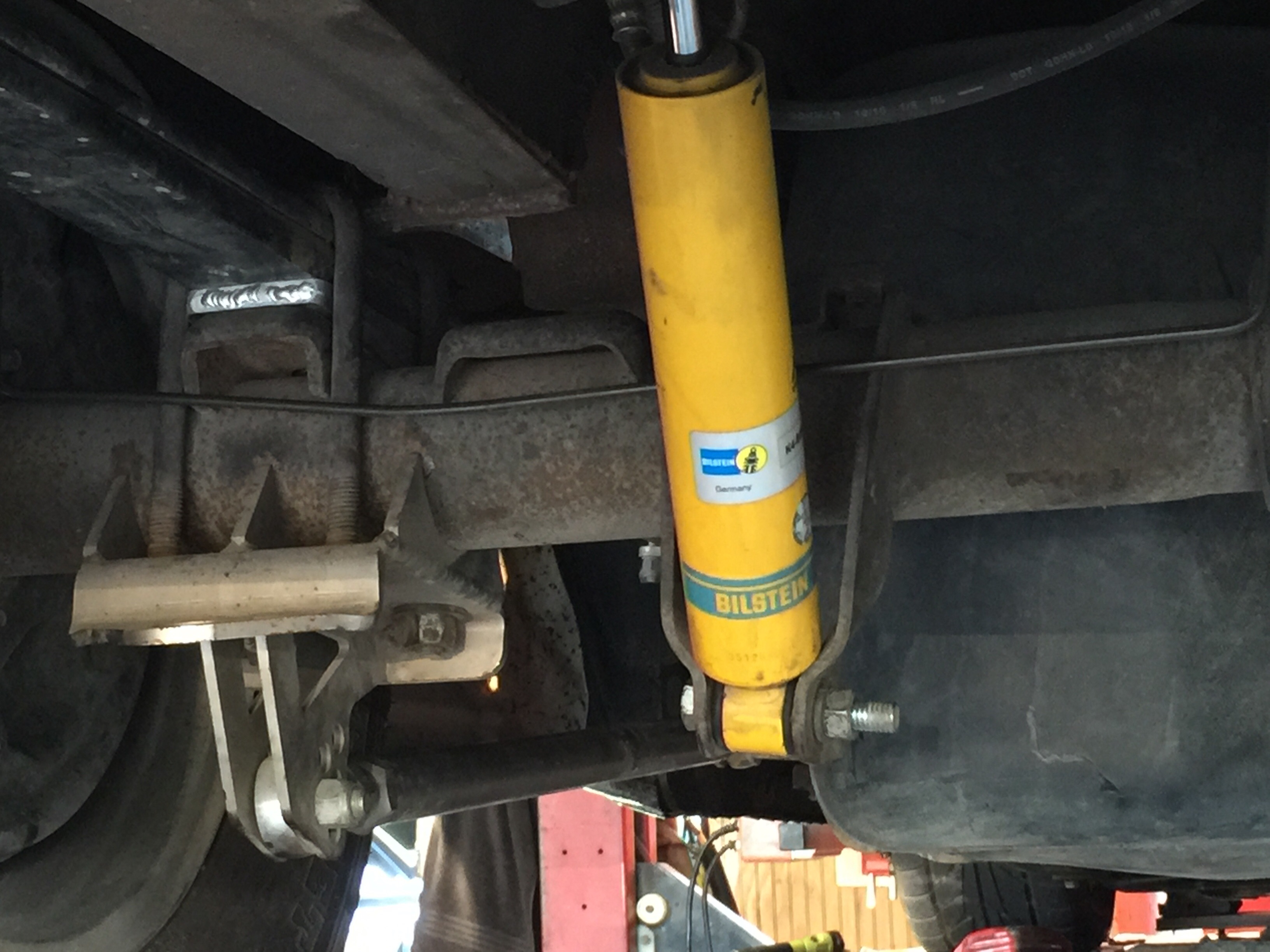

I got the suspension straitened out today.. The shims I originally installed to set pinion angle were throwing off thrust angle so I had to do something else I ended up. Getting some 4* shims from speedway here locally. I stacked them and welded them together.. Then I got a 9/16 bolt and trimmed it to fit so the rear end had something to center it. It actually worked like a charm and got the thrust angle straitened out. And I feel more comfortable launching now it has somthing to hold the rearend instead of u bolts and hopes and dreams.. Then I'm going to recharge the ac, and hopefully tuned by the end of the week. Also put some preload in the rear with the assassin bars it's finally coming together.
