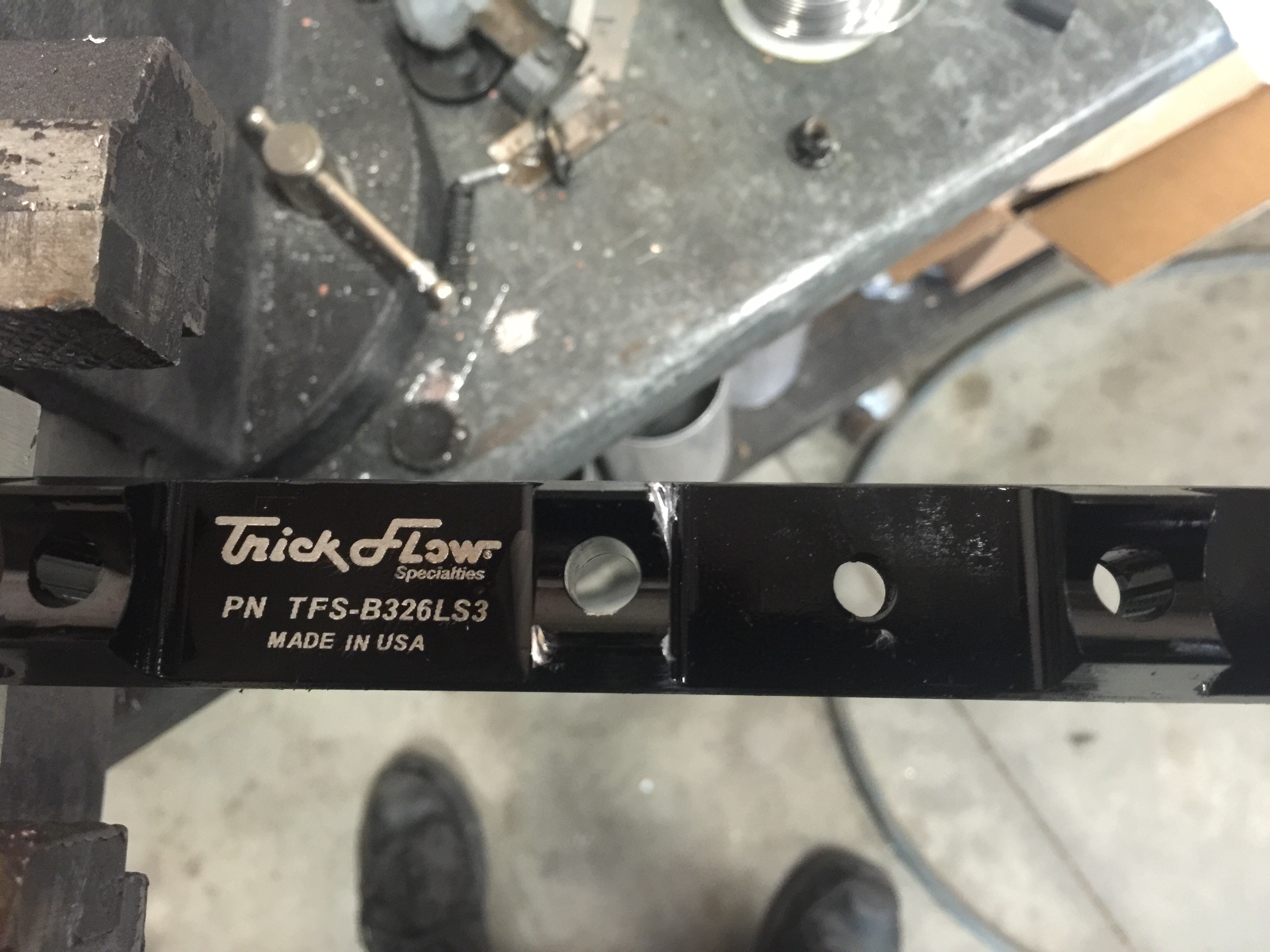

Went to a couple friends with the truck on the trailer and got some new eyes on it.. We all agreed it was on the drivers side and valvetrain related and I took it home and tore into it.. Didn't take very long to find it, luckily caught it early #6 intake rocker was loose and it had a couple burrs on the stand because it was one off the offset ones.. I took the remaining rockers off and pulled the stand off and deburred the damaged pedestal and re installed.. It all seems to be ok.. I caught it early and fixed it I'll probly buy a new stand although it's not really needed, I'm kicking my self pretty bad because I let the new shop hand do that side I watched him use the torque wrench but I didn't go back and check his work.. Oh well it was an easy fix I'll just have to give him hell about it.. I'm gonna get it on the Dyno do a 4 wheel alignment, set up the suspension and probly buy a set of axles for it and put my new diff cover, 4.10 gears in.. That 4k t brake launch is gonna be kinda harsh on that ten bolt..

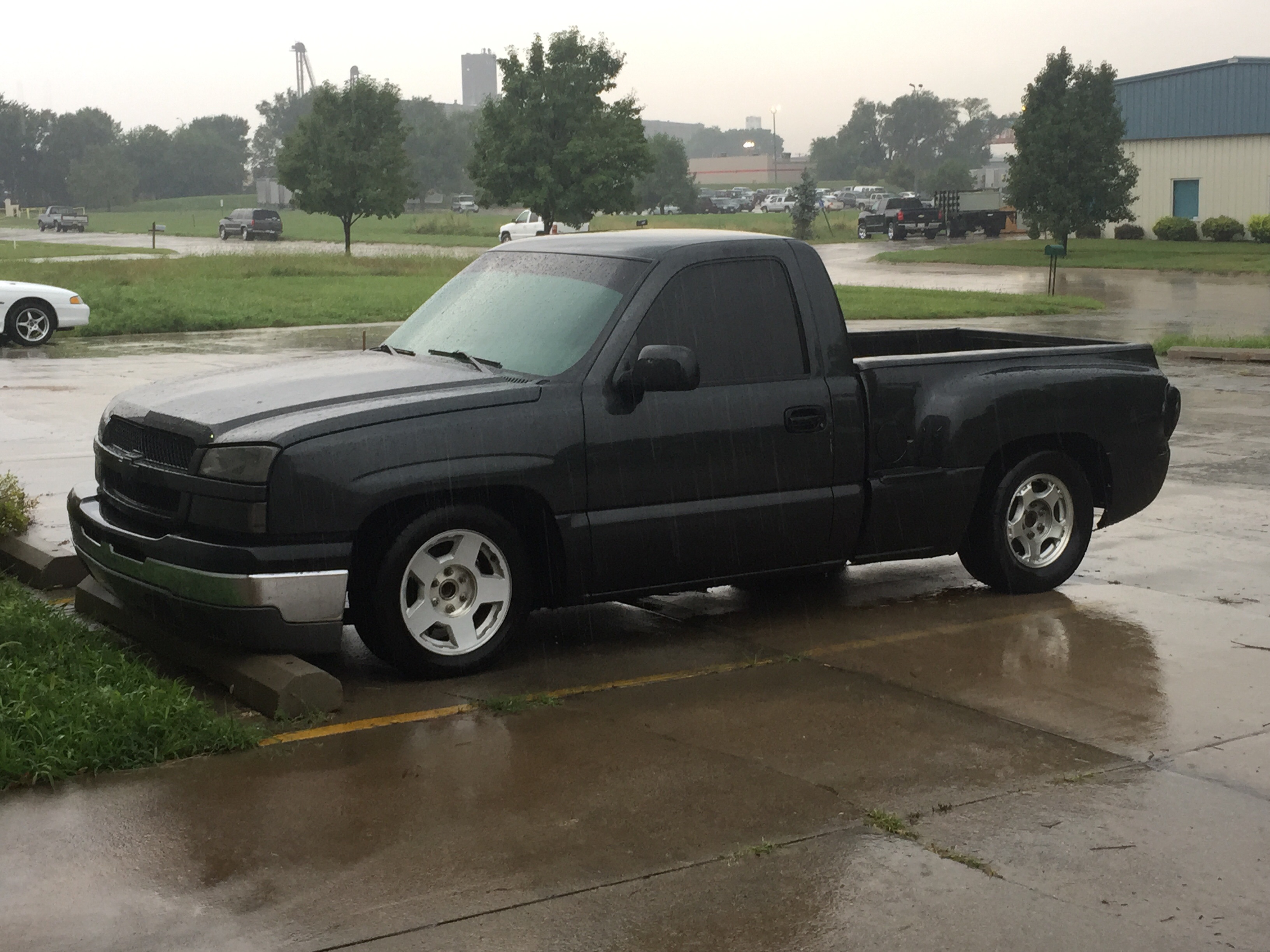

Dropped it off at the Dyno shop.. Gonna just put it on speed density tune.
