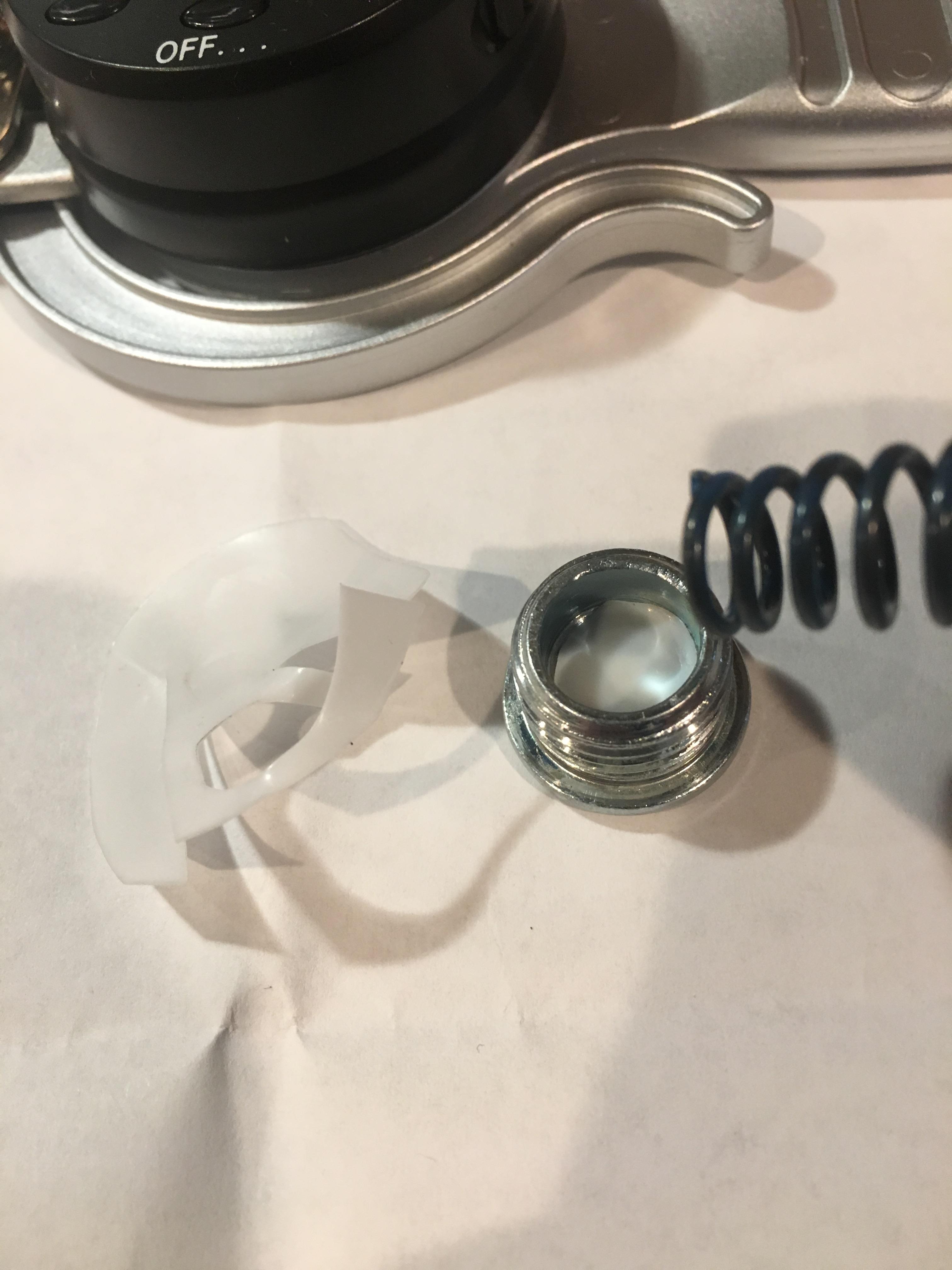

Been trying to figure out how to allow the oil pump spring to rotate freely as it cycles and came up with .010” thick ptfe homemade shims. If you’ve ever changed springs in one of these pumps then you know how much they bind and chatter.....damaging the spring, causing it to have different rates, and creating metal shavings.

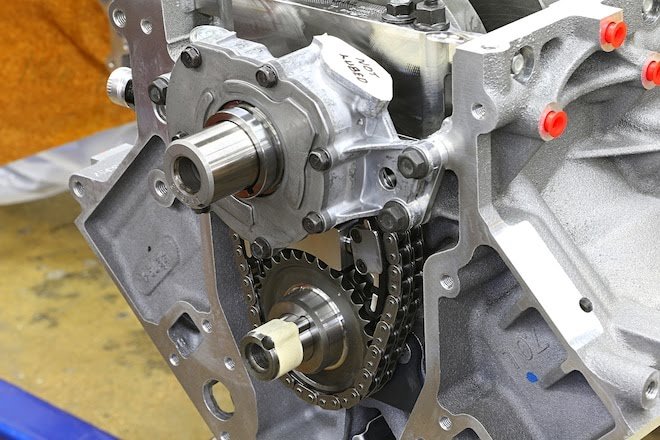

I have been busy designing a better chain dampener and have a couple of different hydraulic versions I’ve been tinkering with. I was looking up some other stuff and ran across this image..sb4 Dohc ls7 with a really nice chain dampener. It caught my eye instantly. I know I know dohc etc etc but still a nicer dampener

Soo you're going to make you own tensioner? That's f**ken neat.. how do you plan on doing that?

I have coyote engine style and Harley type hydraulic dampeners. Just modding mass produced parts is all as I have no fabrication ability. Small orifices vs larger ones to damp the oscillating pressures etc. Using different nitrous jets to play with it kinda things

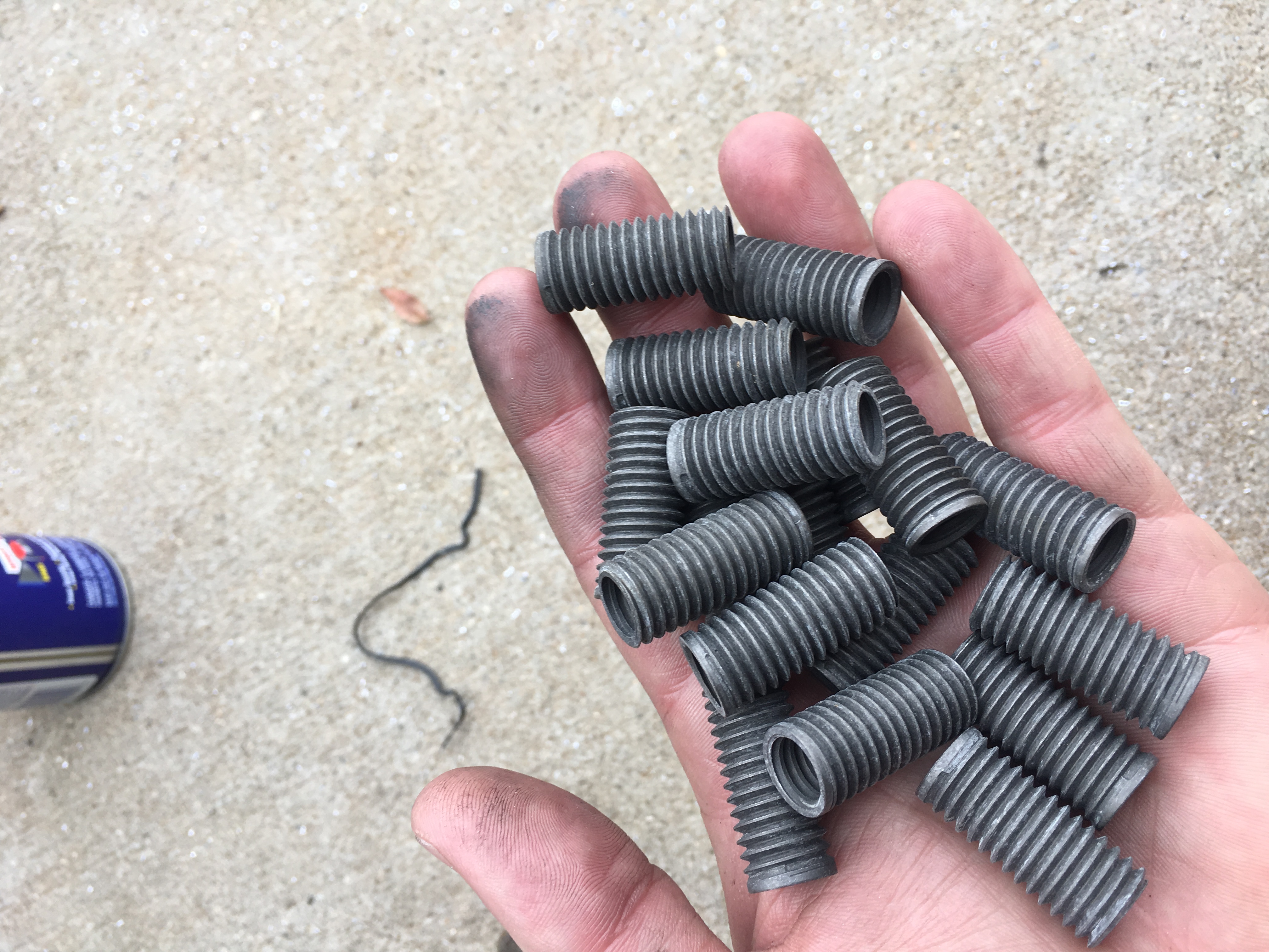

Started putting the timserts in each head bolt hole to add strength for the increased clamping force of the CA625+ studs and developed torque angle method.

Did you drill out the block holes with a hand drill? How do you know your hole is plumb and the studs won't be slightly cocked, not allowing the head to bolt back on?
This just seems risky with all the big HP engines that are only using ARP hardware on stock sized holes
