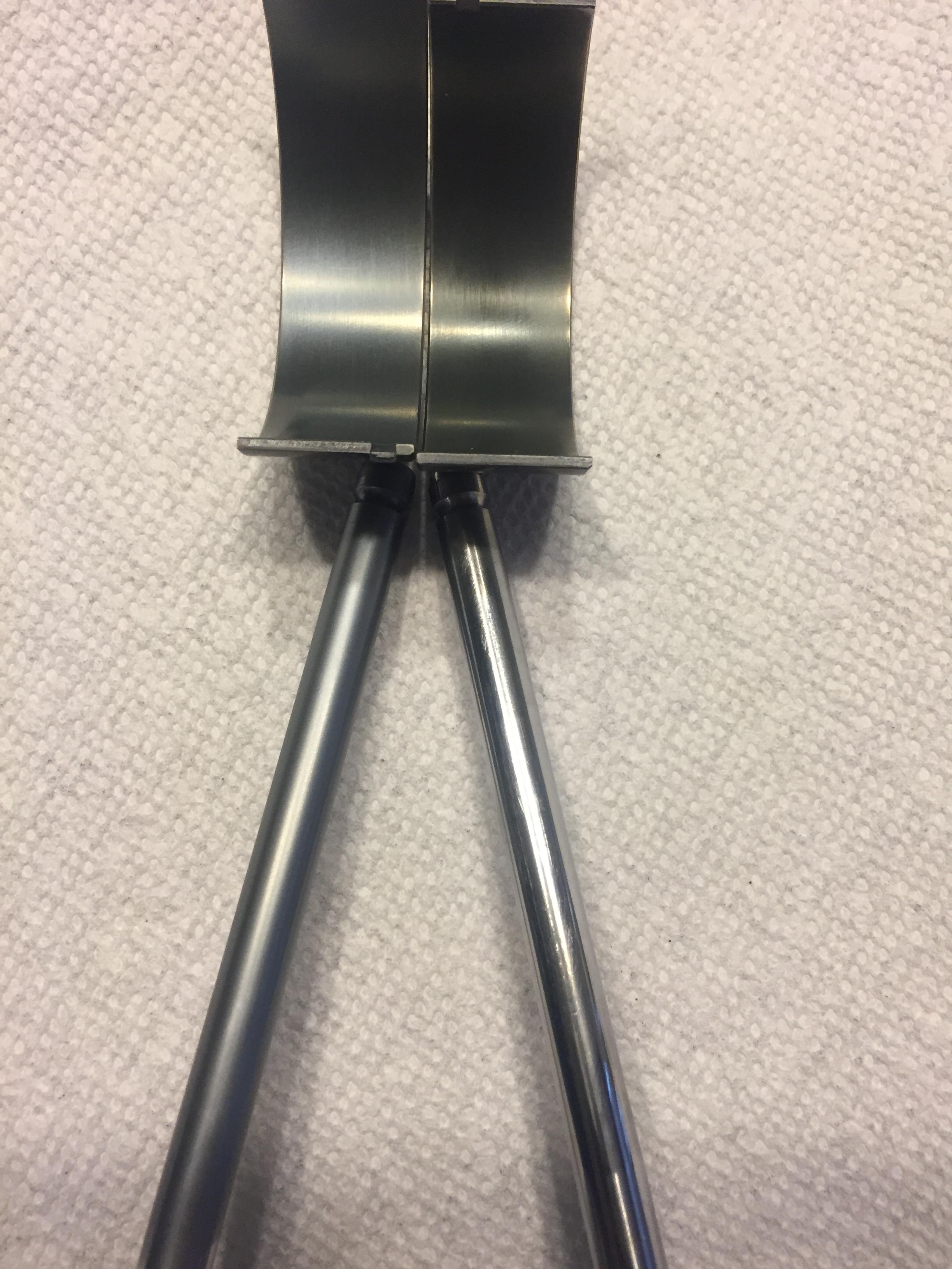

Bearing and valve coated with mircoslick and tungsten left .....uncoated valve and microslick coated bearing right
Petro's Project ERL Superdeck 427 w/ Whipple 2.9L-kqvspqv.jpg

I believe Microblue applies it with air. Not sure if it is a high or low pressure system.
Either way, he made the comment to us several times that once the product was on, it was impossible to remove by any conventional means...
Some of the **** rinsed right off in my parts washer. I was a little more than disappointed in his entire job.
Old Jul 12, 2017 | 10:49 AM
  #407
Petraszewsky's Avatar
iTrader: (28)
Joined: Oct 2008
Posts: 1,137
Likes: 22
From: USA
Yeah they use high pressure blasting (they call it impingement) to apply the tungsten. It probably washed off the extra residual tungsten as it doesn't not adhere to itself. It goes on 1micron thick (.00004"-.00005") And I agree that it is impossible to remove from the substrate unless you blast, machine, abraded the surface. Strong bases or acids will remove it but normal oils , fuels, cleaners etc won't. Even a strong cleaner like acetone won't remove it. The thing with Mircoblue is that they don't use any binders like how the Cerakote Mircoslick does. Mircoblue also REM polishes the parts which just enhancess the WS2. Hell they use it spacecraft bearings etc. I just mixed a little of the tungsten powder with a few ounces of oil and squirted it the crankcase of my Silverado. At .6micron the filter won't catch it. It should burnish itself into the moving parts.

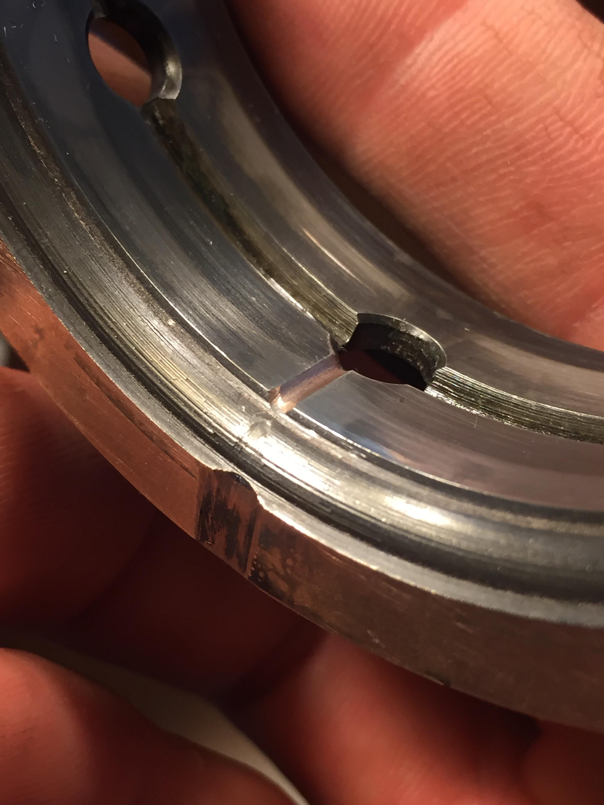

Filed a groove to pressure feed the rear thrust face...
Petro's Project ERL Superdeck 427 w/ Whipple 2.9L-iikbpnh.jpg

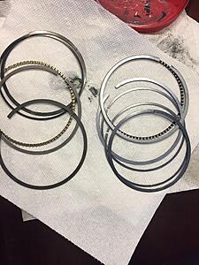

Here's a better pic of the uncoated and coated rings
Petro's Project ERL Superdeck 427 w/ Whipple 2.9L-lskkfgf.jpg

I dont really understand the benefit of coating the rings?
