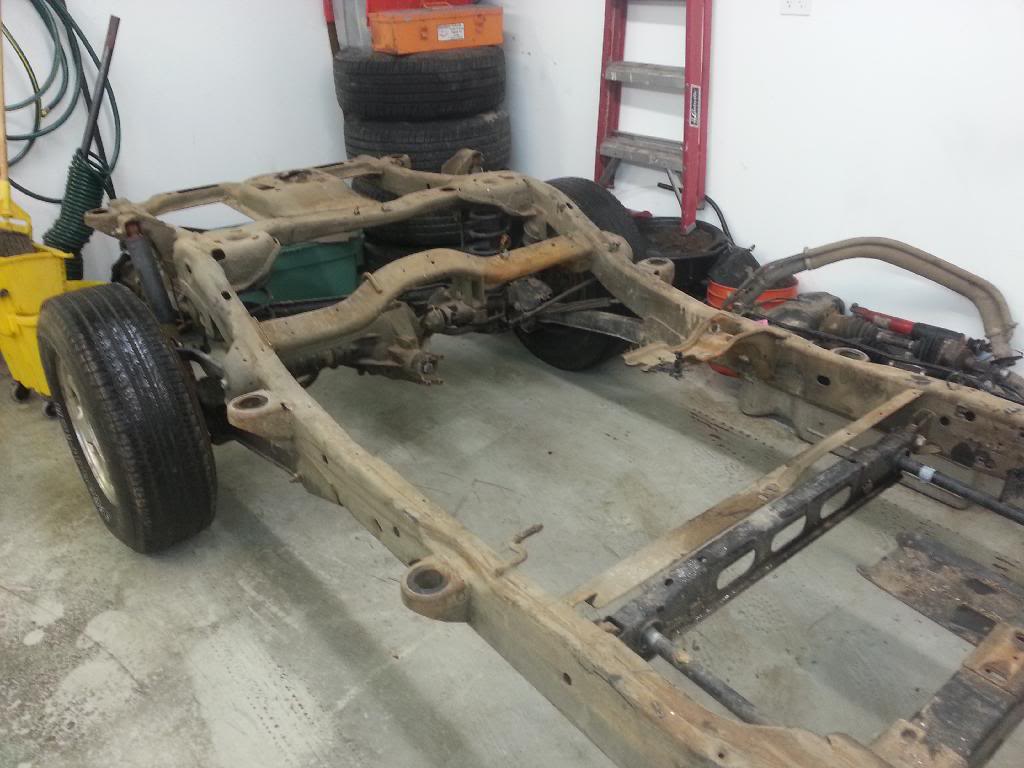

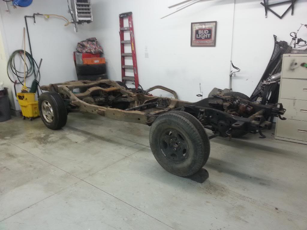

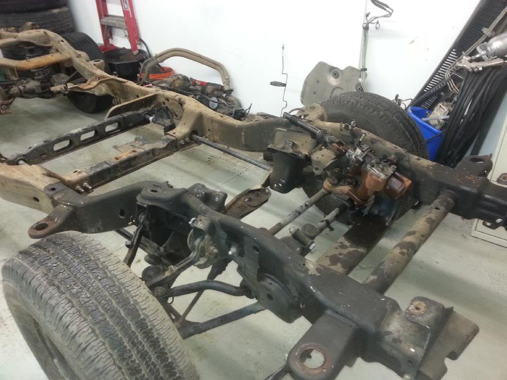

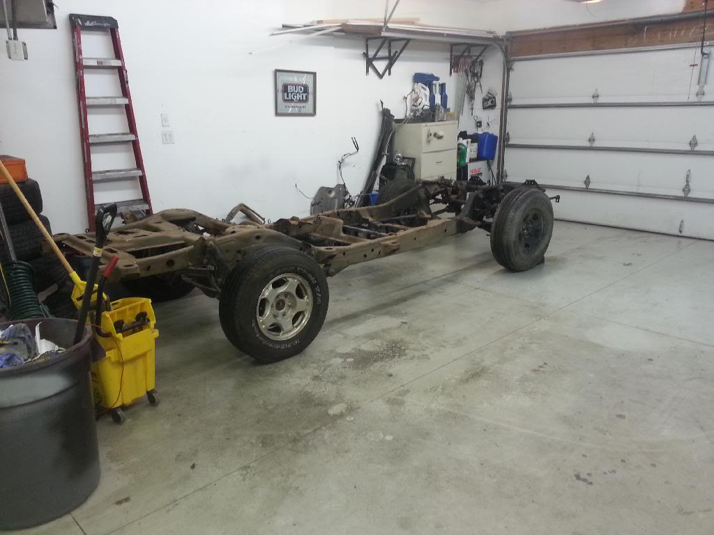

Got it all stripped ready for sand blasting next weekend as long as there is still not a foot of snow on the ground still!

So your gonna modify the Tahoe frame to fit the truck???
Old Feb 2, 2014 | 12:21 AM
  #64
Mortiz's Avatar
Formerly PurplePearl (2014-04-06)
Joined: Dec 2011
Posts: 262
Yes that is the plan! Cab will bolt up. Running into problems figuring out what tcase to use.
