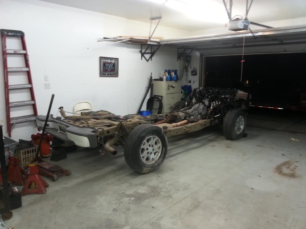

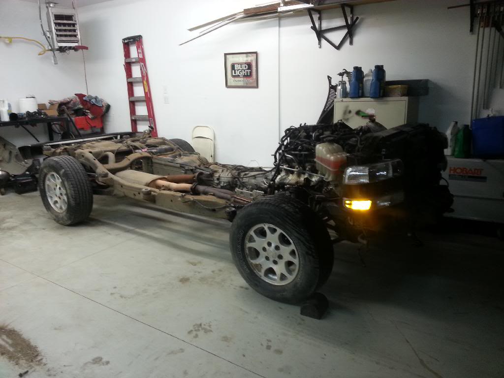

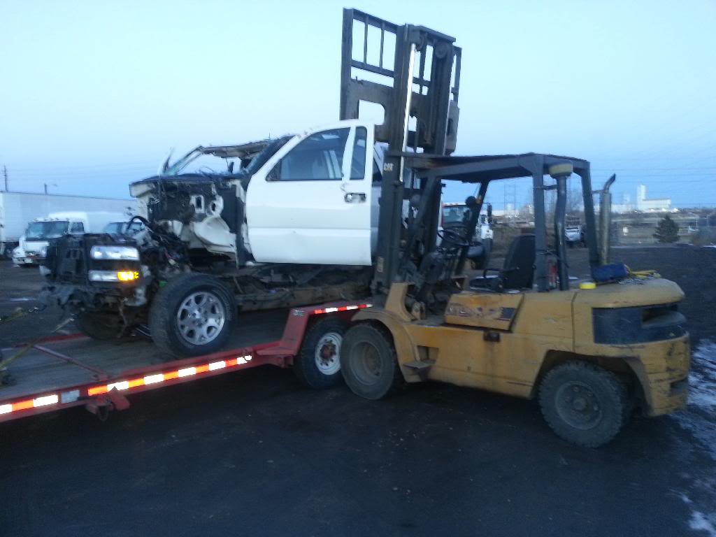

I got everything stripped off the tahoe today. The 5.3 was oil locked. Pulled the plugs, made a mess and a smoke show but it runs great! The body pulled off.
I am trying to decided to shorten the bed 3 inches or strech the frame. I think since I have to do so much modifying to the bed it would be easier just to shorten the bed.
