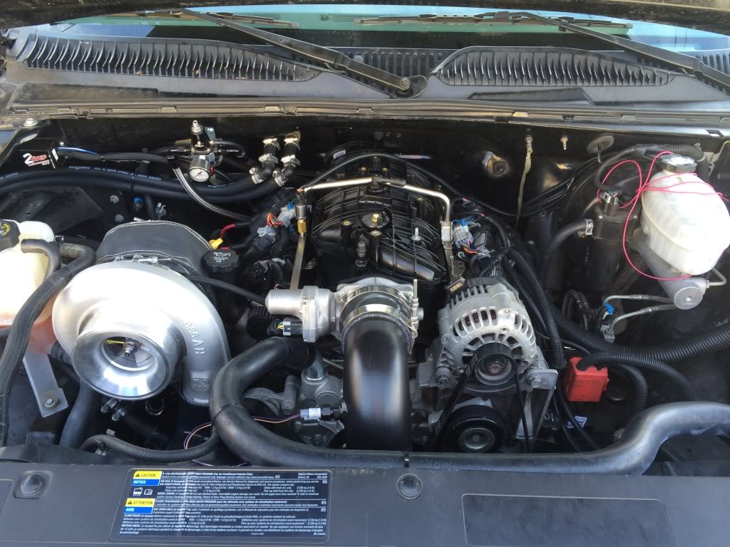

She is alive! Very happy with everything. I have a lot of under hood cleaning and tidying up to do but I'm glad it is running. I might get my boost gauge hooked up so I can take it for a drive today. I do need help setting up a spark table before I do that though. If you can help with that, check out my thread in the tuning section.
