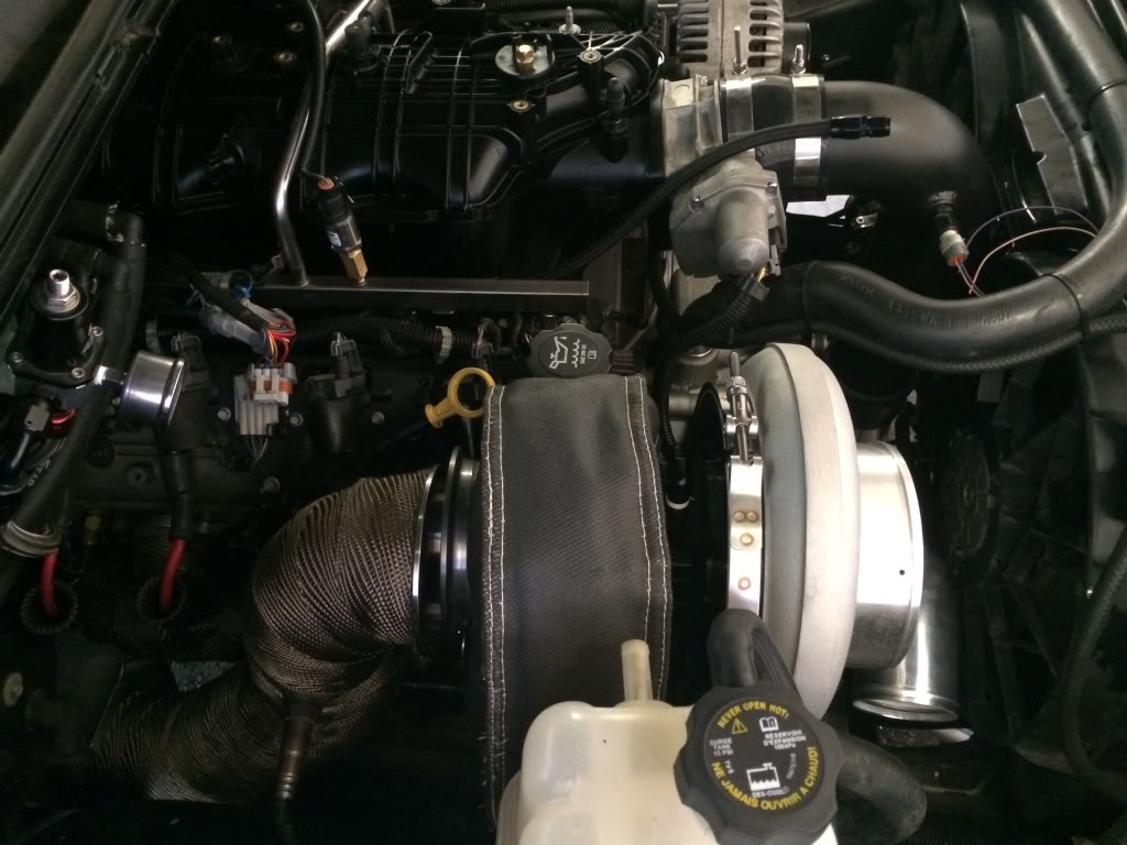

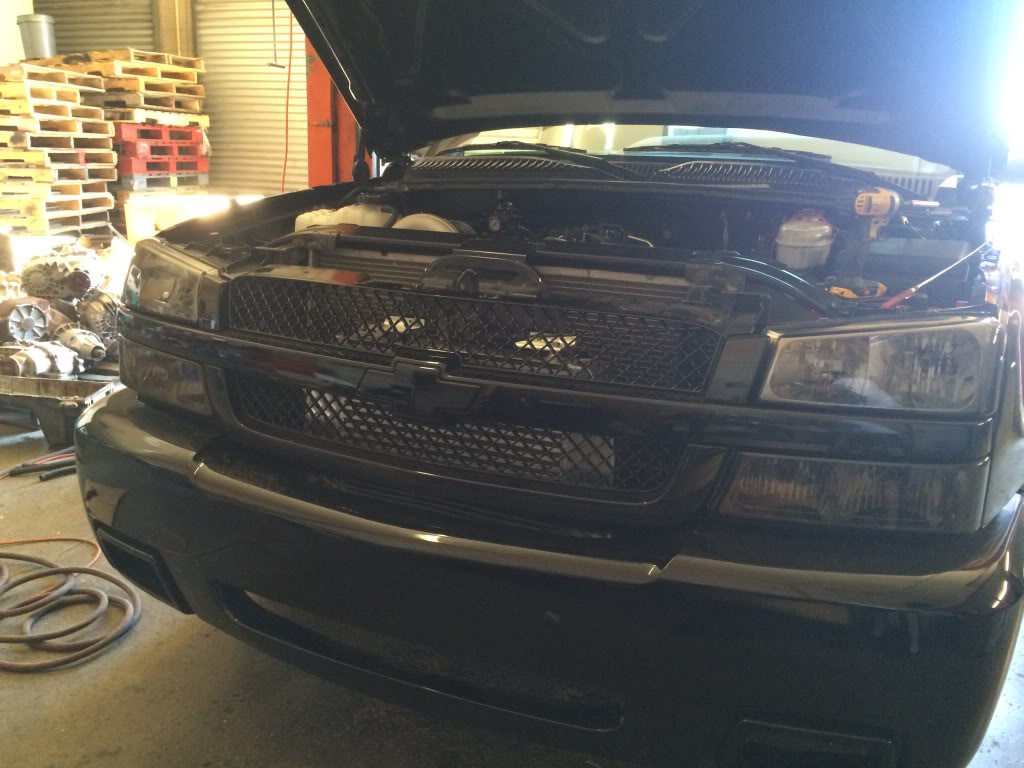

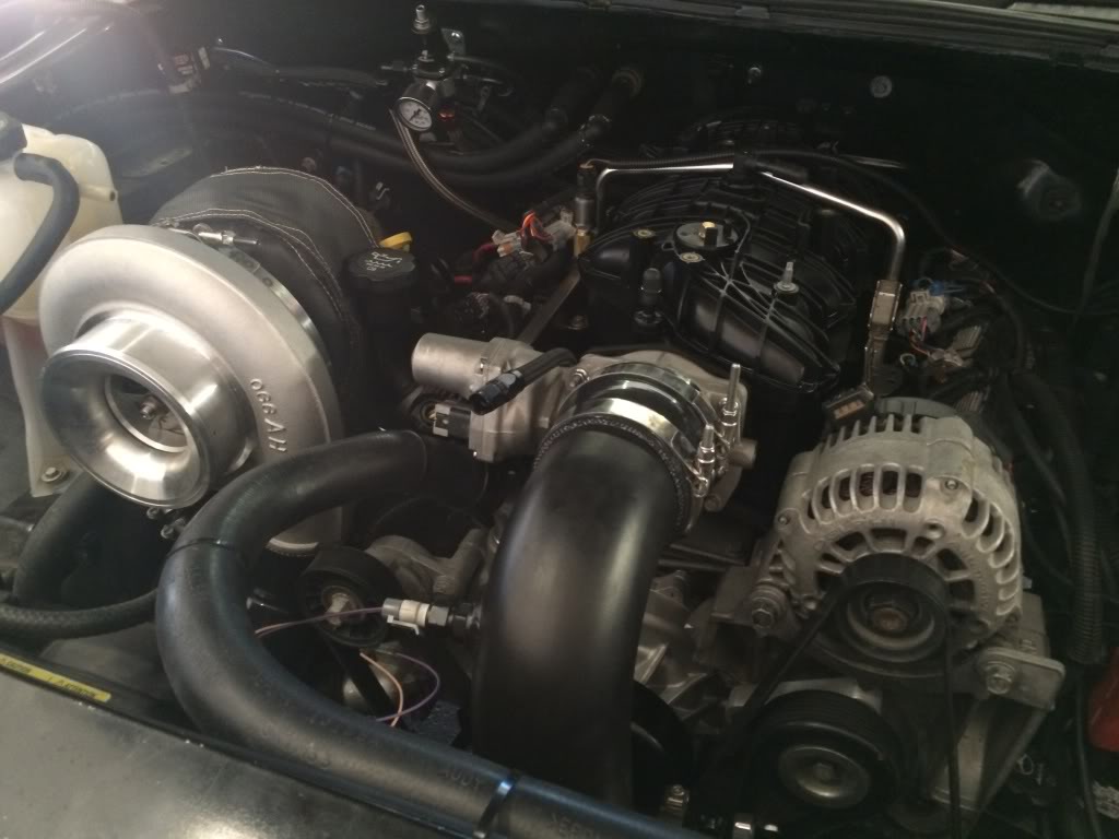

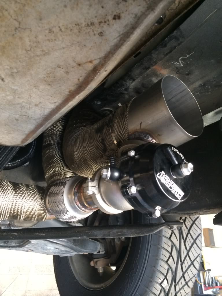

Today I had a few hours and pretty much buttoned it up except for the damn turbo gasket.. I went all week and forgot to order one. So I guess this week I will get a gasket and be done. Just need to run some vacuum lines and put the boost gauge in.
