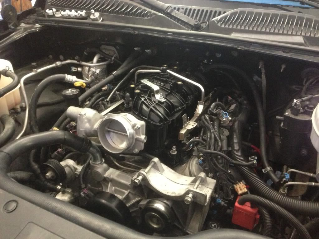

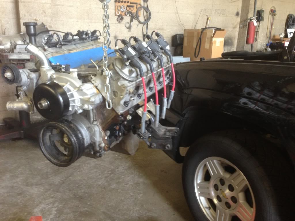

Here is the engine before dropping it in. I had the engine hanging from the hoist for more than a half an hour before putting it in the truck, and then it decided to give out as I was lowering it in.

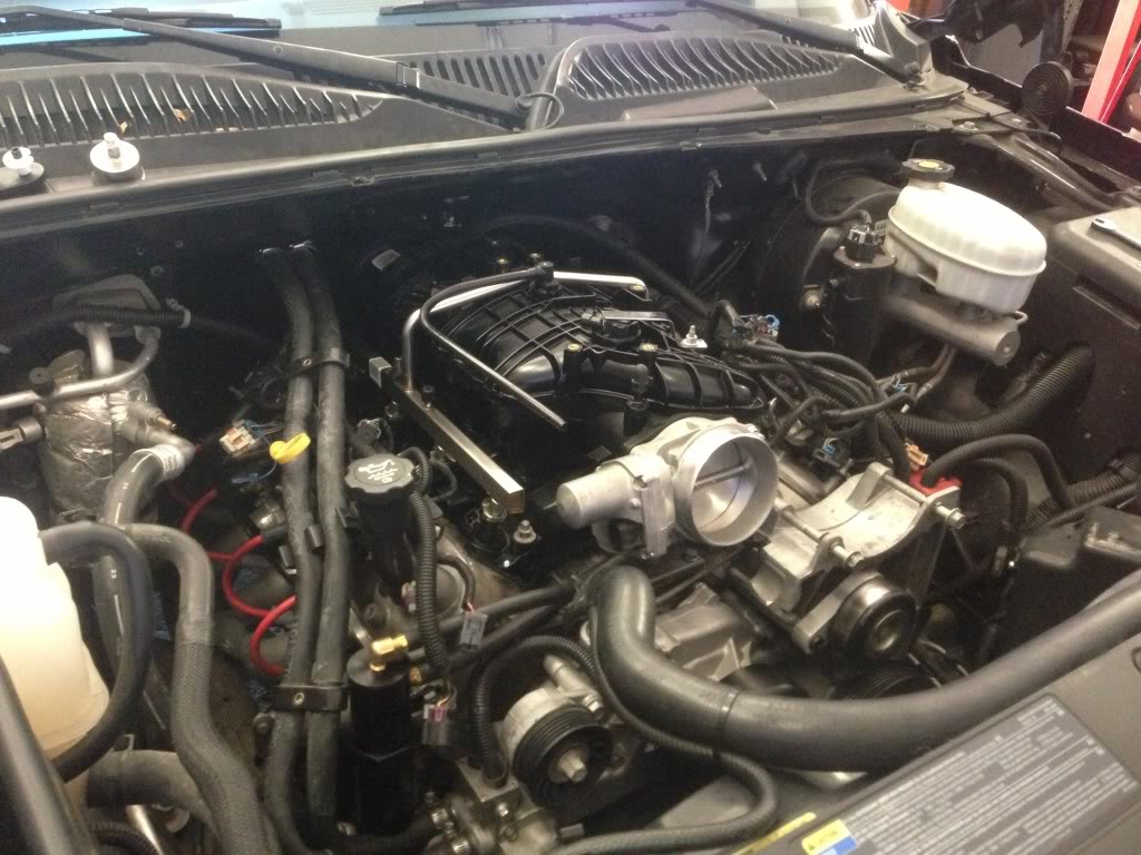

Here is how it sits now before I left work. Just need to tighten the intake down and plug the injectors/coils in. I'm waiting on a damn fuel rail fittings so I can fire it. Will be here tomorrow morning so I should be able to drive it in the afternoon. I just need to figure out a cold air intake. Not sure what I'm going to do yet. And I need to get rid of that damn heater hose holder that bolts to the valve covers. Do I even have it in the stock location?
those damn quick connect fittings are so fragile that you probably would not want to leave those hoses unsupported. Stock location is between cylinder 2 and 4 on the passenger side VC.

yeah, looks to be in the right location. you could run them right along the intake manifold then down, or route them out around your overflow then to water pump. Put a couple 90's right at firewall location then re-route them.

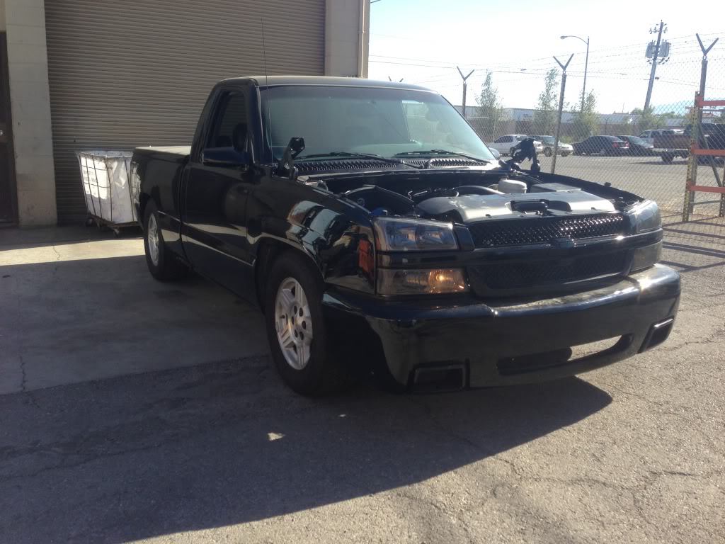

The truck runs really smooth. There is only one problem. It is incredibly slow . Sucks to go from the 408 to half the horsepower. Can't wait to get the turbo stuff on. Won't be for a while but it will be fun when its all together. Here are some pics/vids from today.
