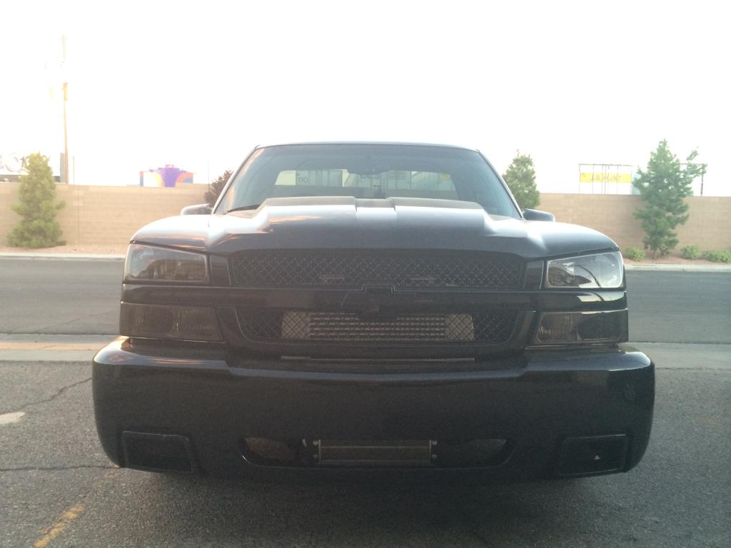

I finally got my trans cooler from UPS today. It looks like a real nice unit. I spent the afternoon putting it in the truck so I could drive it home. I've been waiting to drive the truck after I put the A/C stuff back in because I couldn't find a place for the 40K. Soooo, here is how it turned out. It fits perfectly between the frame and bumper mounts. Only problem is the limited airflow it will get where its mounted. Sucks but I wanted to get the truck back on the road. I'll just have to keep an eye on trans temps.

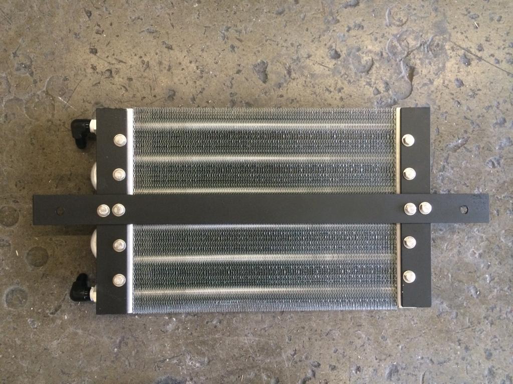

Here are the mounting brackets I made for it.

Mounted below the intercooler in the bumper.
The A/C blew cold as hell all the way home. It was 112 today here in vegas so it was much needed. It's sure nice having cooling regular cab. It cools down a lot faster than my 4 door car does. After a 30 min drive from work to home the trans temp was 205. I'll have to drive it more and see if its going to work out or not. After reading that trans temp, I will probably end up building some brackets to put the 40K in front of the intercooler and use this new cooler for oil. Should be more than enough to cool the oil.

I would be leery of mounting a trans cooler that close to the ground and exposed. Be extra cautious of road debris as one little nick in that cooler and it will empty your trans pretty quickly. I previously had my trans cooler low in the grill and behind the bumper when I had a little fender bender denting in my bumper. It nicked the cooler and hemorrhaged the fluid out very quickly so I had to leave it at the scene and go get the trailer to get it home.
Old Jul 2, 2014 | 11:58 AM
  #604
oakley6575's Avatar
Joined: Dec 2010
Posts: 5,235
From: Las Vegas, NV
Yea thats definitely something I thought about before mounting it there. Since it is just a tube and fin cooler, something would have to pierce the tube for it to **** anything and the tubes are pretty thick. They are close to 1/8" thick or more if I remember correctly. If something had enough force, it would rip the cooler out of the truck before piercing the tube.
I drove it back to work today and trans temps were 195* when I parked it. It just doesn't get enough airflow from that little opening. Its only getting air through about 1/3rd of the cooler so I'll probably end up getting a small fan to mount on the back side of it. 200* temps don't really scare me in this climate but it doesn't leave much room for beating on it. I could probably get a couple WOT pulls in before I would need to let it cool down.

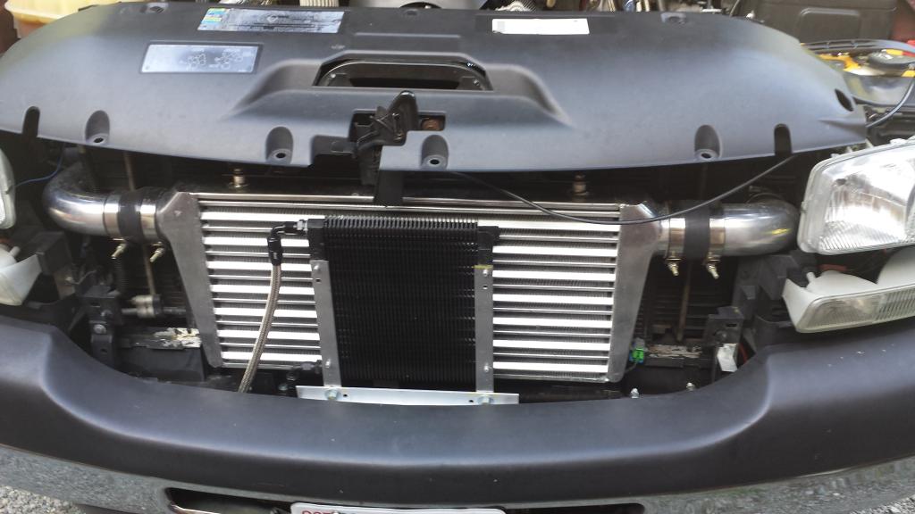

I just slapped mine right in front of the IC and nobody has told me yet its a bad thing, I know it does sacrifice some of the intercooler but lose a few horsepower or lose a trans....
