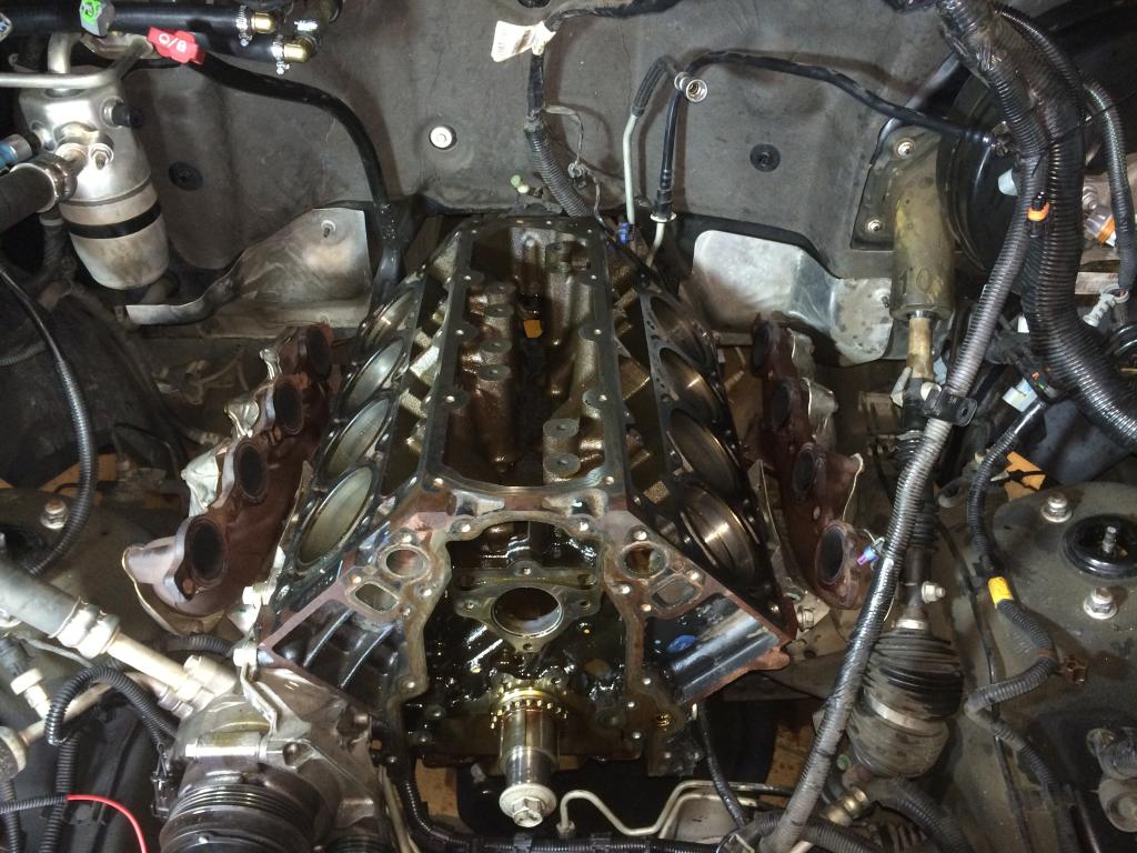

I'm about half way done with the cam swap and dod delete on my truck. I started yesterday and have about 11 hours into it so far. I must say, this is no easy task. I am doing more stuff than I need to and without the best tools, it's a slow process.
So far I've done all of the disassembly. I just need to clean the heads and block surface, replace the springs, drill and tap the oil pan, and do the trunion upgrade. Then it's just a matter of putting it back together.
I am also preparing for the turbo while I'm in there too. I already rerouted the heater hose. I also pulled the oil pan and I'm going to tap it tomorrow.

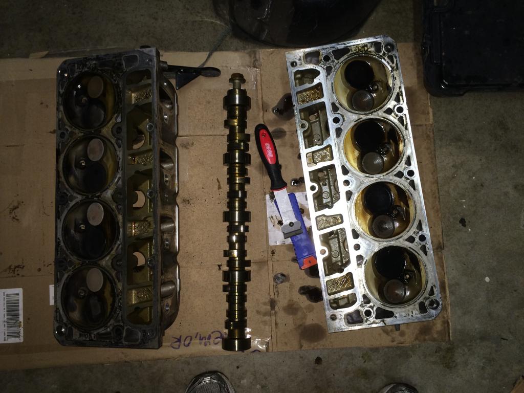

I was hoping to get more pictures but my hands were dirty and phone has no storage.. Yadda yadda
Box of some of the new stuff.
Bed of parts.
