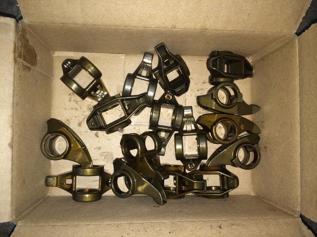

Well I didn't get much done today. I had to go back to work. I did get the old needle bearings pressed out of the rockers which was pretty easy. I also installed the springs in one head. I bought one of those cheap $15 screw type compressors. I would highly suggest anyone doing this with the heads off to get a manual c-clamp style compressor because this was ridiculous. I was trying to save some money and skimped out, but it's definitely worth it to get a nice one.
In the morning I'm going to do the other head and try to get them on so I can start buttoning things up. I'd like to get it running on Friday so I have the weekend to troubleshoot anything/drive it.
I still need to do a little cleaning on the heads. Probably just hit them with brake parts cleaner and mineral spirits. The gaskets are already scraped off.
