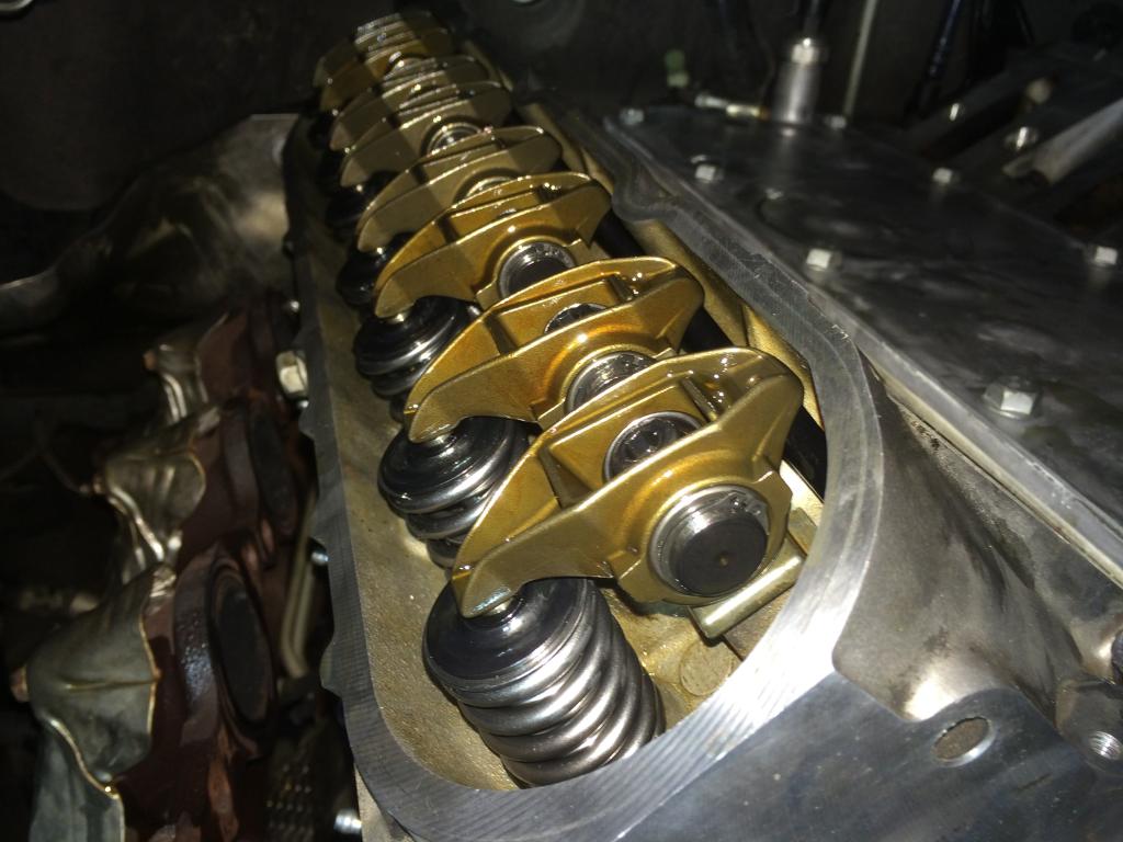

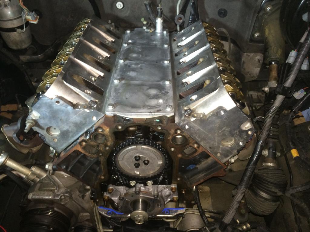

I feel like I made big progress tonight! Got the heads on. I doubted myself but you can in fact drop the heads on with all studs in place and the exhaust manifolds still on the y pipe. I had to do some redneck engineering (ratchet strap) to hold the passenger manifold out of the way while I dropped the head on. I torqued them down and then put the pushrods and rockers on. I was hoping to get the front cover on also but ran out of time. I also realized my torque wrench only goes up to 150ft lbs so I'm not sure what I'm going to so about the arp crank bolt that is I think is somewhere around 240 (still have to double check). I wish I would have just bought the stuff to key the crank.

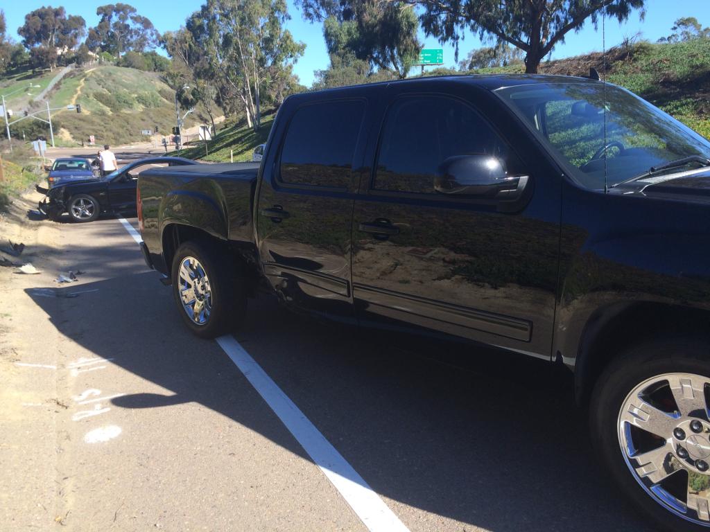

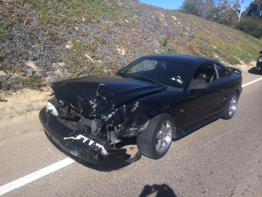

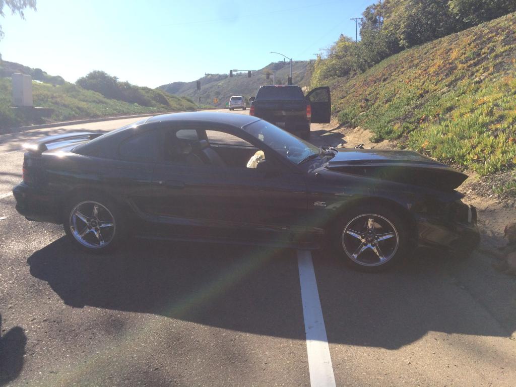

Well. I've been driving the truck today. It runs great. Very happy with the results. I wish it had a little more lope though. I think I'll get justin to durn down the idle a little.
Then I had a stroke of bad luck. A mustang was getting on the interstate next to me and lost control and hit me. I am praying it's not totalled after all of this work.

What do y'all think? 2007 121k miles and it's in great shape. Totaled or no?
Bed, c-pillar, rocker and door all need to be replaced.
