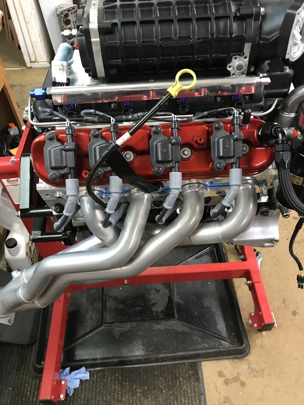

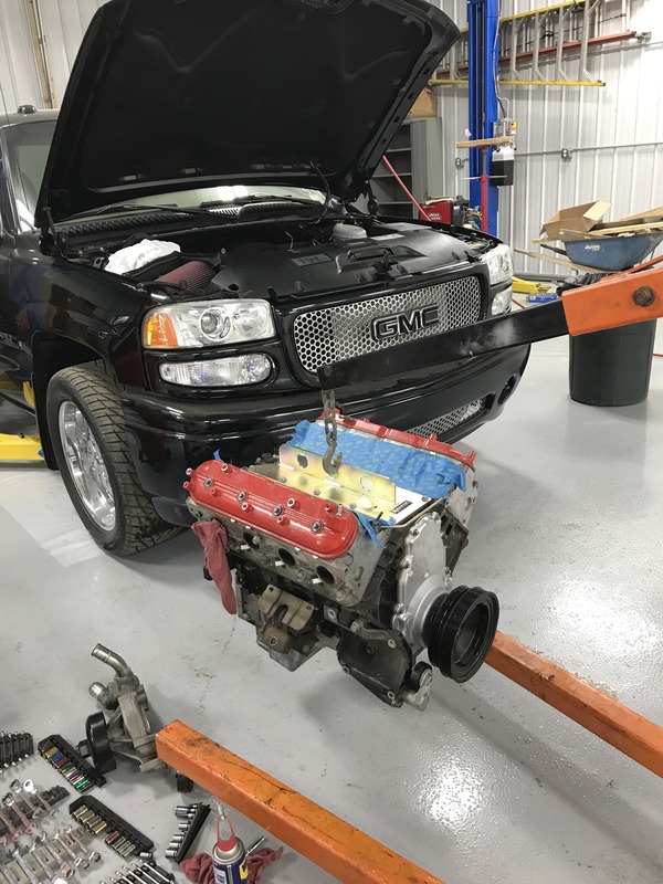

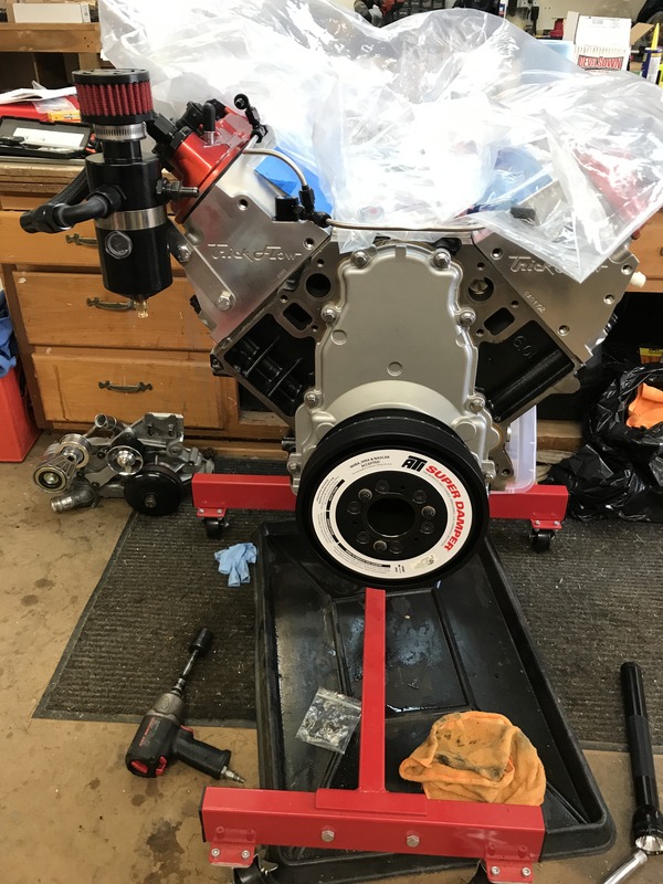

Engine is all together and pullies aligned. I am working on cleaning up some wiring and gonna make some brackets for some of the nitrous stuff while the motor is out. Here's some random pics

Looks great..!! Did you paint those headers..?
No I bought them ceramic coated a couple years back. Someone had a special going, I forget who at the time. They have dulled a bit but still look good inside and out.
