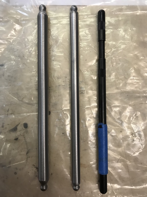

Pushrods will be 3/8-11/32 taper on intake and 7/16 on exhaust.
7/16 clears on the exhaust with plenty of room.
7/16 left, 11/32-3/8 middle and a 5/16 checker on the right for reference.

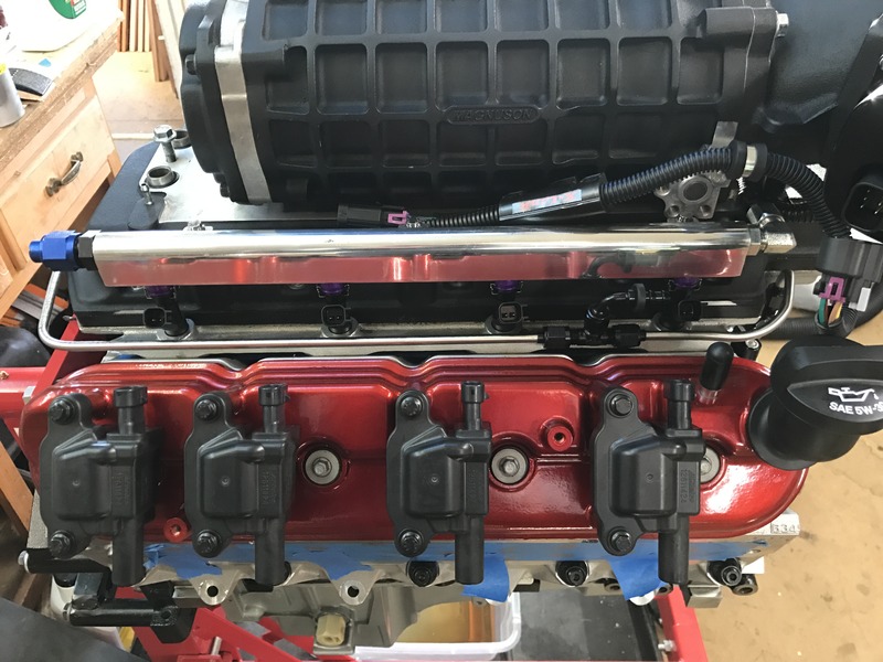

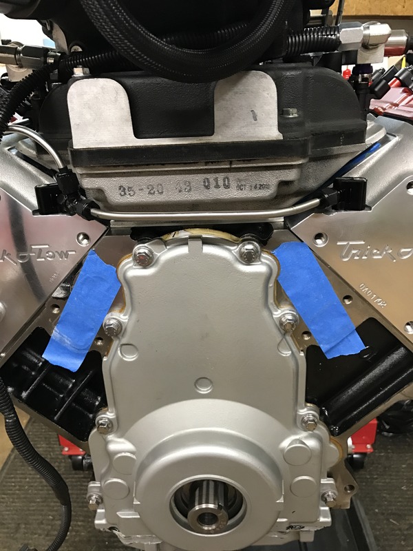

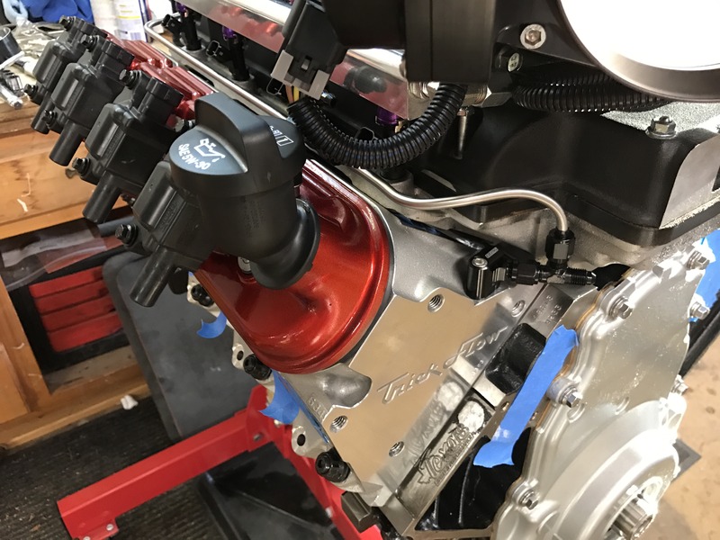

Finished building my steam vent lines.

Thats sexy

ARP coil pack bolts
Old Mar 8, 2017 | 08:19 PM
  #150
Atomic's Avatar
I have a gauge for that
Posts: 16,282
Likes: 438
Looks nice!
