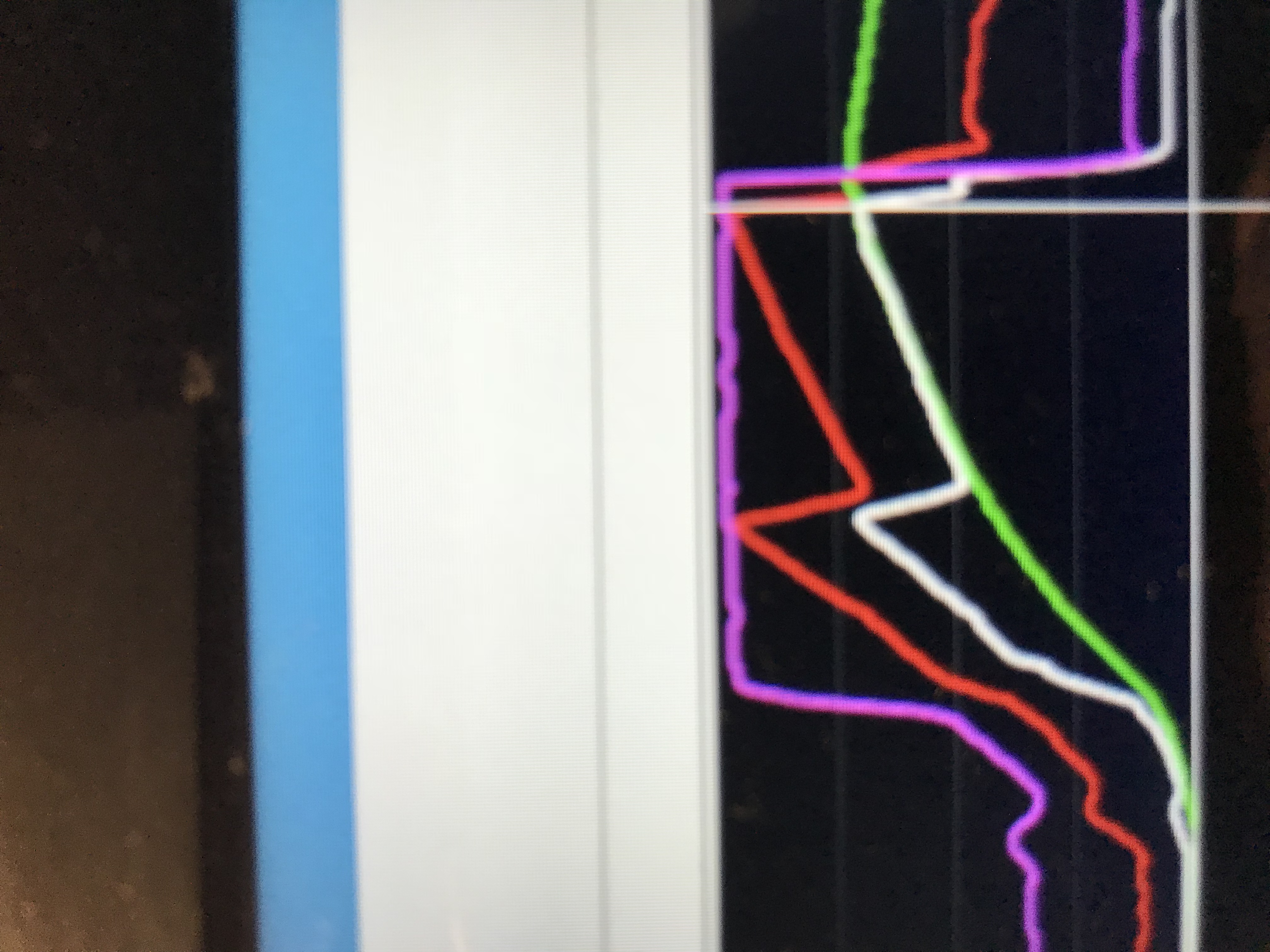

With a 2.8 pulley shifting at 6700
4” intake showed 201-202kpa and would taper off to 200-201kpa above 5800rpm
5” is 204-205kpa across the board.
With the 4” on the one time I spun it to 6900 boost fell to 197kpa by 6900
Generic pic but you can see Map Kpa barely moves.
Pink-Kpa
Red-rpm
White- idc
Green- speed
