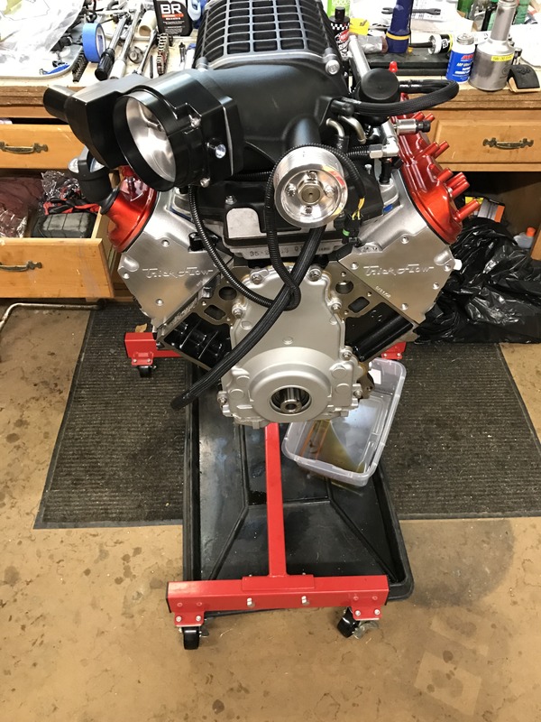

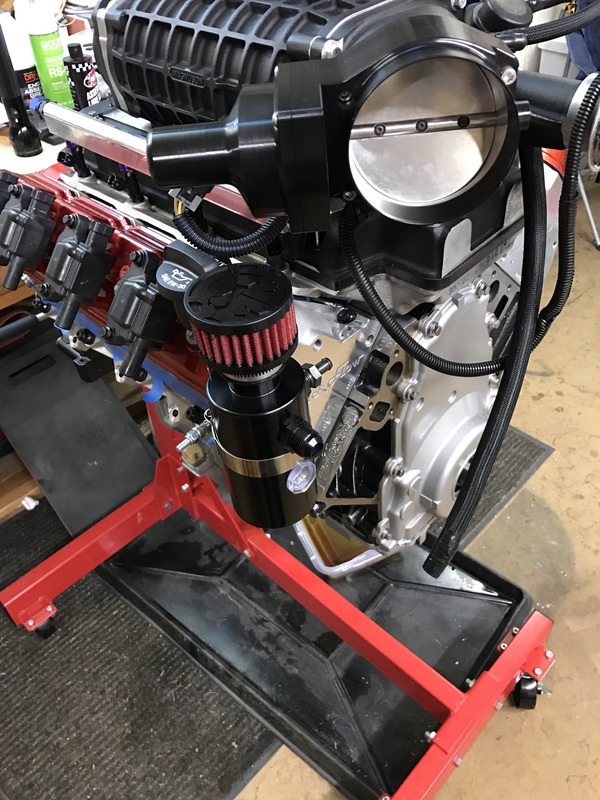

More test fitting.

Nice. VC Color reminds me of the turbo denali that burned down
That's true. Forgot about that, that was Mark. 2004Denali if i recal.
