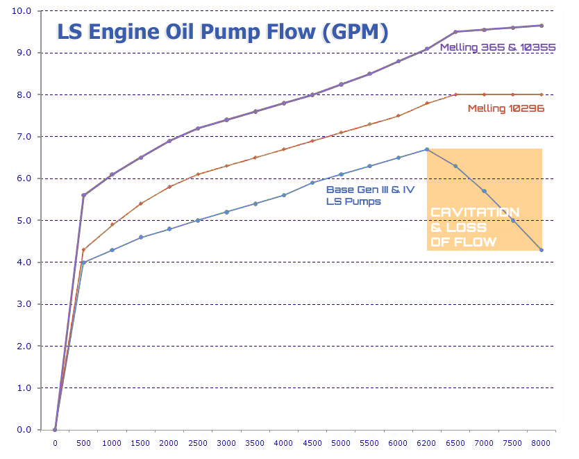

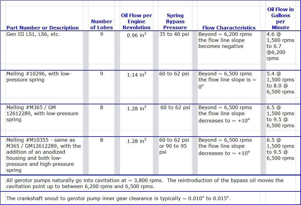

Got my oil pump, it's a Precision Oil pumps blueprinted Melling 10296. At least at this point I think I'll run the low pressure spring.

Reference for those interested.

I have not seen that info on the gm pump dropping flow at 6200rpm but find it very interesting. Do you mind sharing your source?
Old Aug 6, 2016 | 10:55 AM
  #58
03sierraslt's Avatar
Posts: 19,007
Likes: 221
From: Western PA
1st one I forget, 2nd I think is from melling. Apparently Melling makes the Gm replacement pumps. I don't know.
