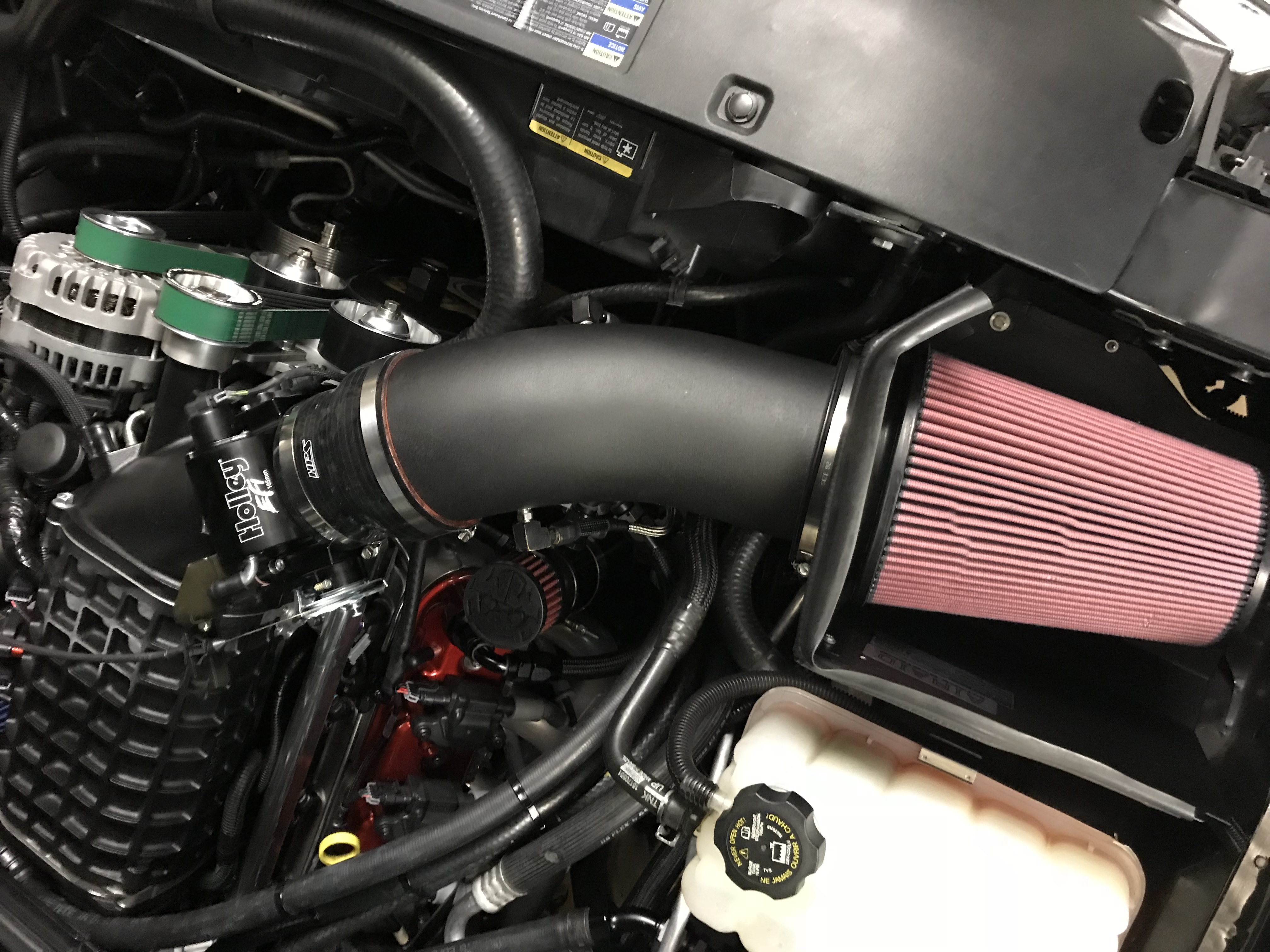

Couple weeks ago I took it to 6900 rpm, and my 4” intake needed help ( which I figured). So I started work on the new intake. New 5” intake is done, hope to test it out tomorrow. I already did a MOC test fit and run a couple weeks ago and 5” is what it needs but now I have the final version done.
After I mocked it up my buddy volunteered to smooth it and finish it so I let him. I was gonna do it but he is awesome with this stuff so it was too hard to resist knowing how good he is. I really like the finished product.

Very nice setup!!! Are you running 2 meth nozzles under that 5 inch pipe? If so, what kind of setup?
Yes two nozzles, 1x 10gph and 1x 7gph
AlkyControl kit and I run Devils own nozzles.
