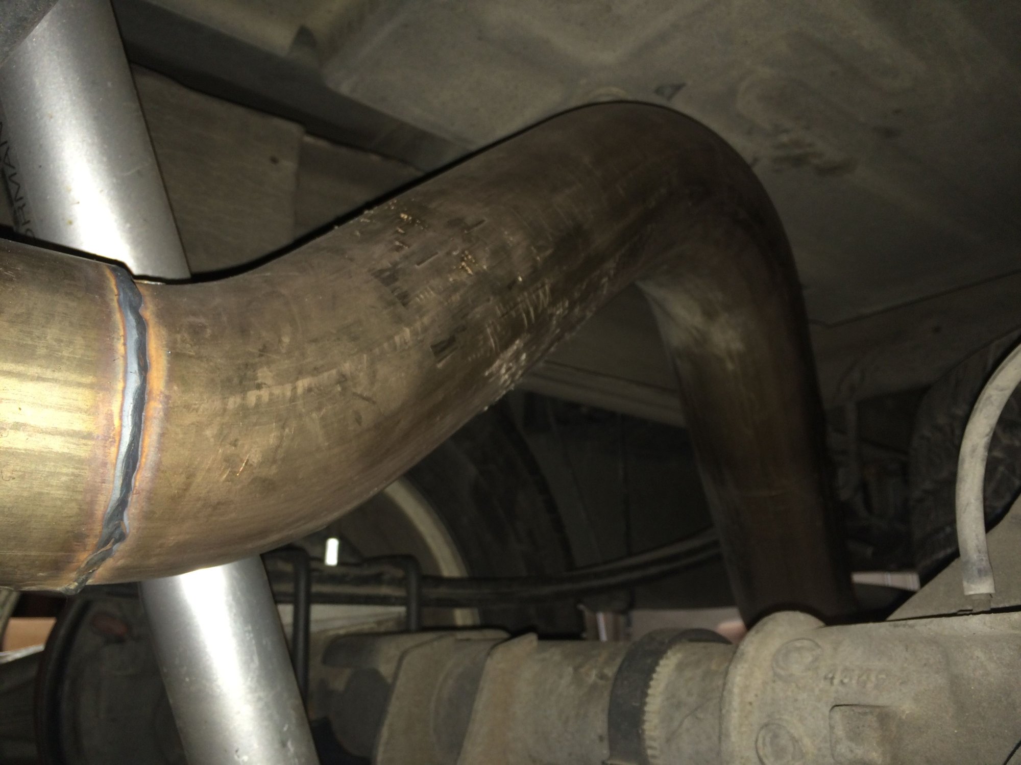

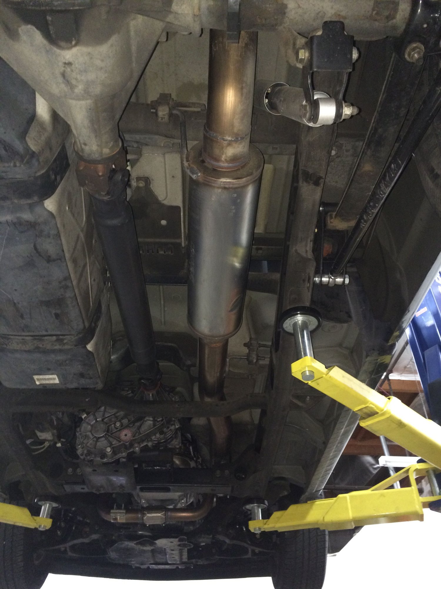

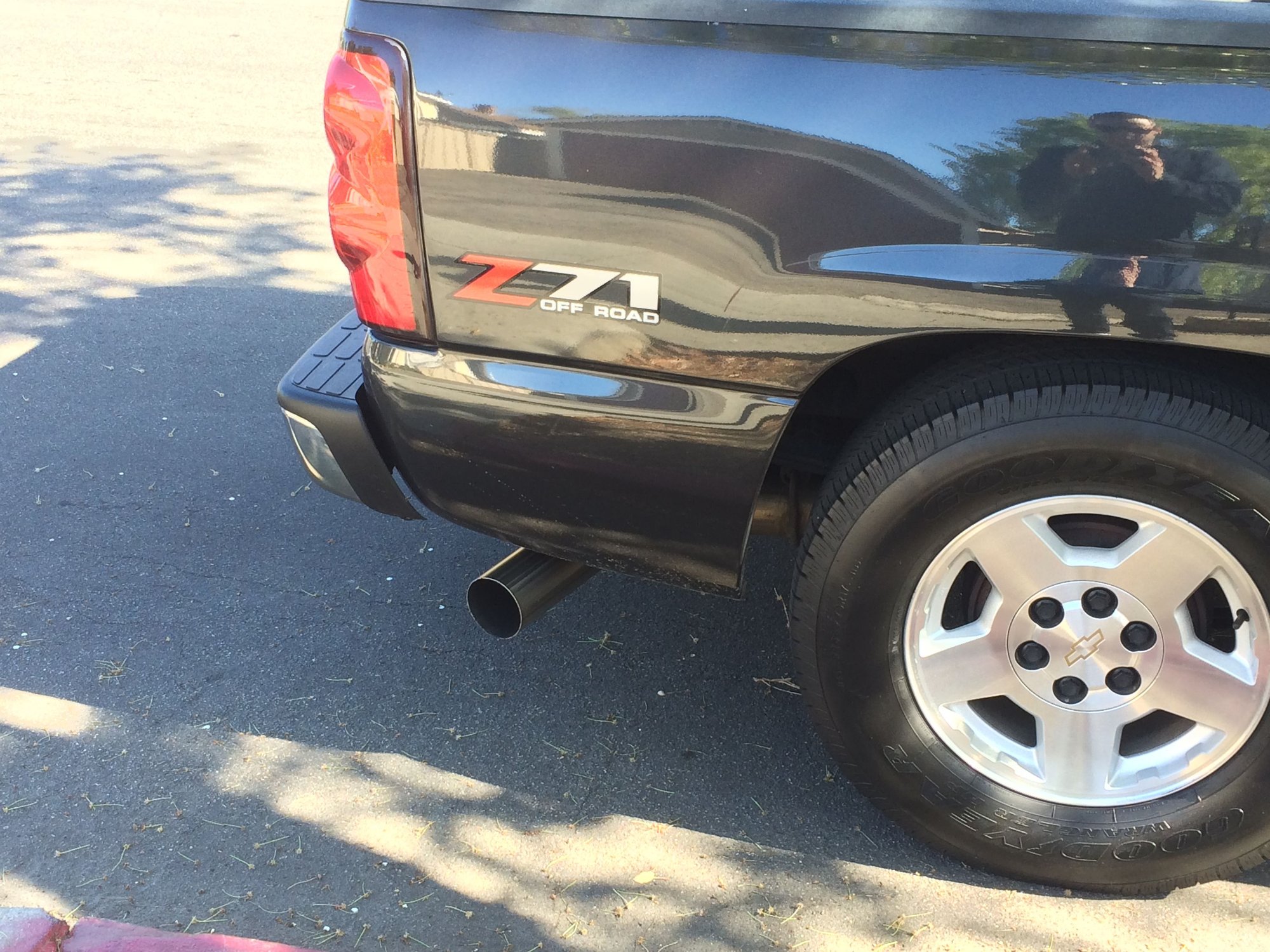

Anyhow I've put about 1000 miles on the truck, and solved quite a few bugs in the process, sorted out the suspension, etc. The closest mandrel exhaust shop is about 100 miles away in Bakersfield, so I took a chance and had the local muffler shop make me a 3" crimp system. Needless to say the 3" crimp system looked like ****, choked the motor, and I couldn't even hear the exhaust period or the turbo it was so quiet. I promptly drove to the mandrel shop the next day and had them make me a 4" system with a Magnaflow 30" long 12772 muffler that I brought along. For $200, I am pretty stoked. Complete back woods mandrel muffler shop that's been there forever, but they do really good work and everything is T409. I have some drone but seems like the more I drive it (maybe some of the fiberglass packing burned off), the drone reduces a bit. Either way I plan to do a j-tube here pretty shortly. I can't say I'm thrilled with the tone of the exhaust. It's decently quiet but it's also bassy and almost sounds like a turbo Supra under load. Kinda strange.

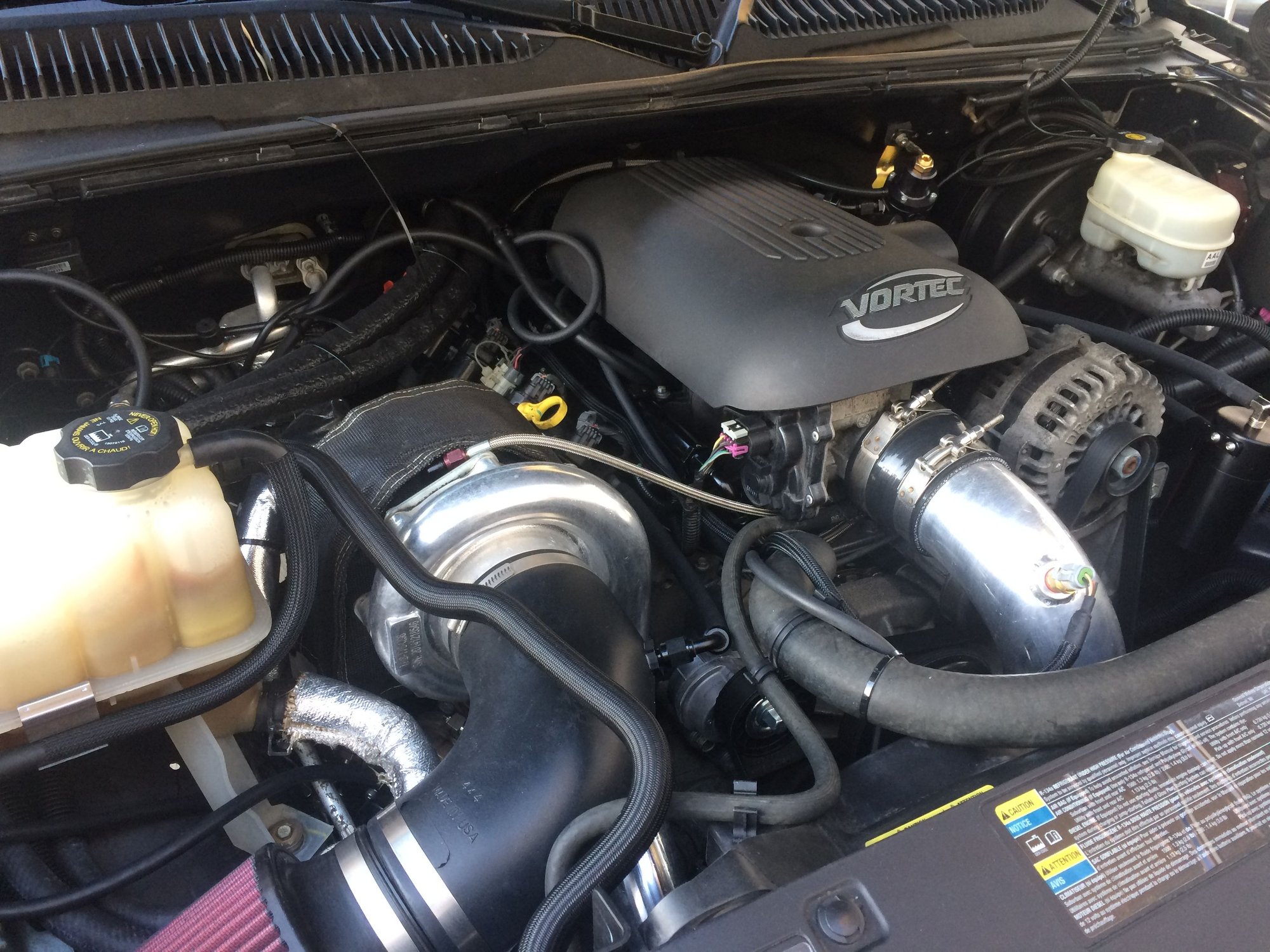

Anyways, a few pics. Had the chance to wash the truck and wipe down the engine bay finally. I need to clean up my vacuum lines, I'm still undecided where I want to mount the splitter.

That exhaust looks really good! I wish someone around here could do mandrel bends on 4" stuff but I thought you needed a $50,000 piece of equipment to do that, or cut up premade bends.

Yes, usually a Hines machine and then the different fixtures for pipe sizes. These guys use a different machine for every pipe diameter, not sure if that's normal or what. These guys are a complete anomaly...deeeeep in the ghetto, the original owner Bob passed away 8 years ago and now his son runs it and it's a real filthy place, they have 5 drive-on lifts and a crew of guys building exhausts, replacing cats etc all day long. There are two skilled builders that I ask for when I go in there.

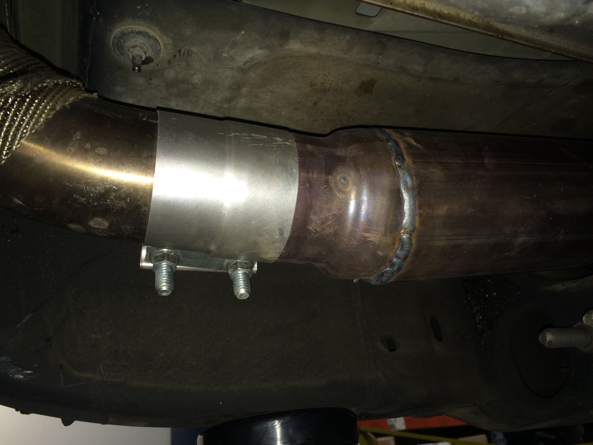

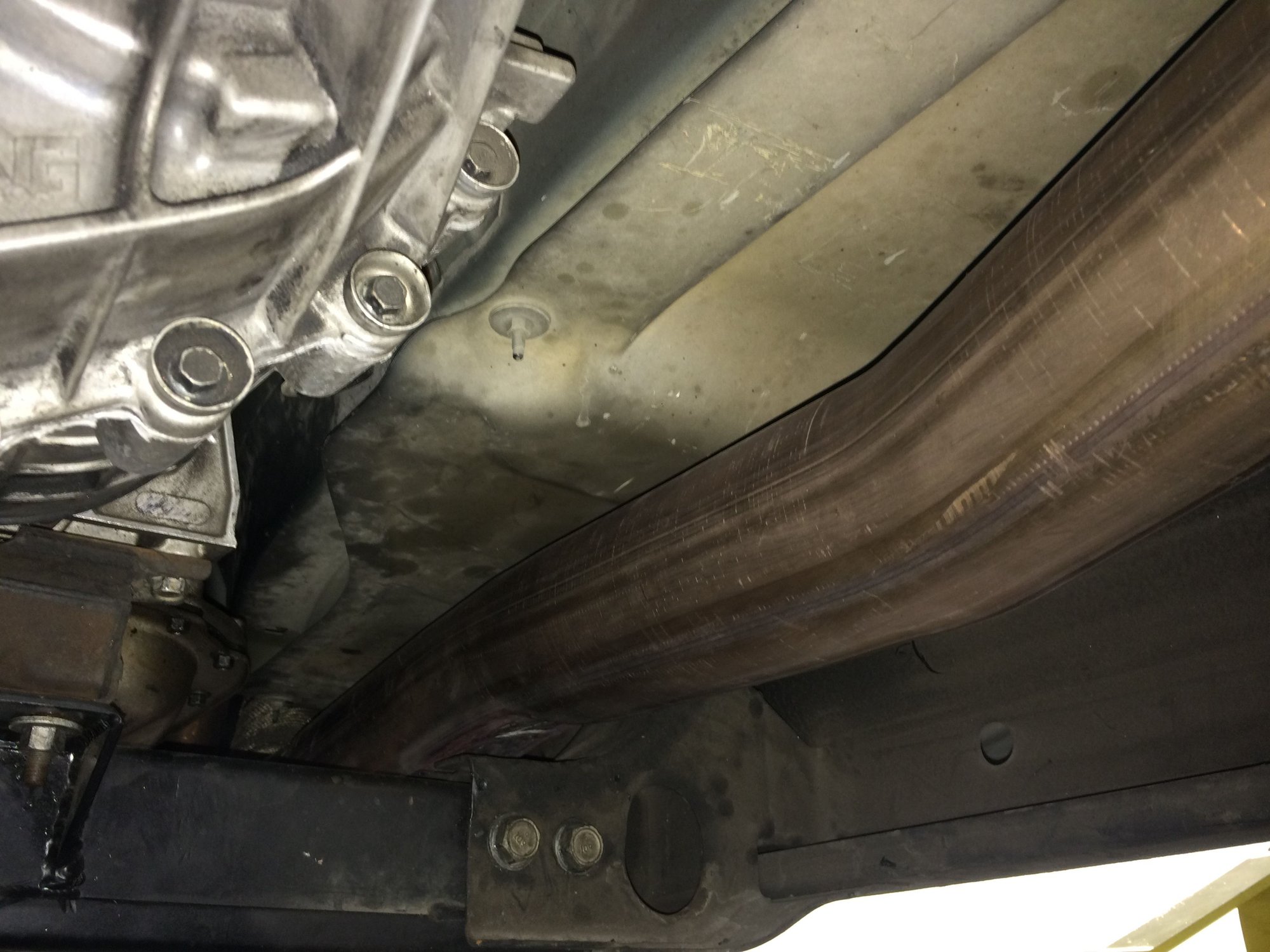

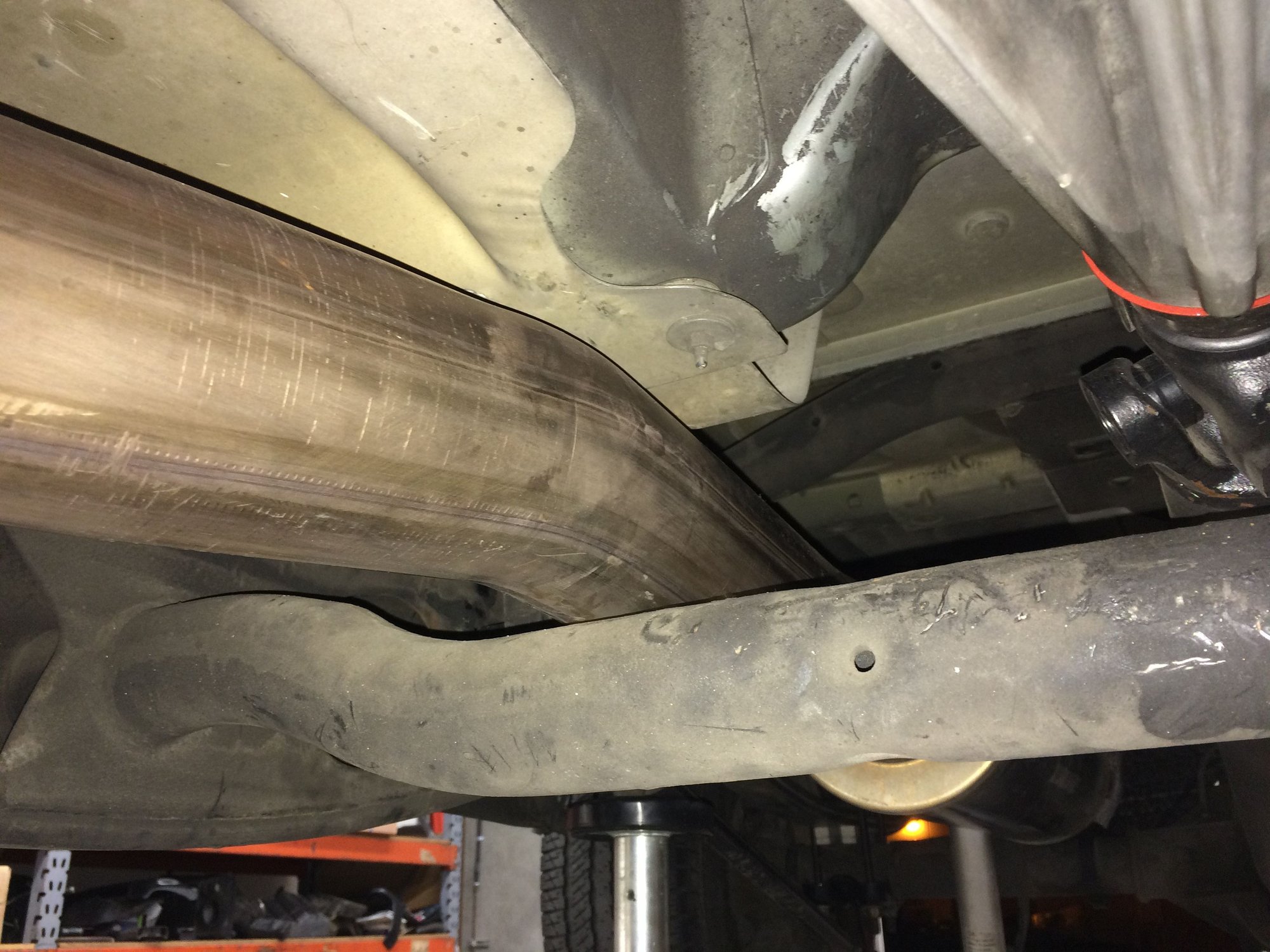

Looking over your pics very clean install.
I noticed a couple of things might motion to you.
The AC line can not touch the hot pipes even with wrap / sleeve. The silver sleeve is a reflective thermal barrier more then a contact thermal area.
The down pipe being wrapped that low will push it over towards the frame.
This will change its the rotation of the fownpipe at the turbo.
also pushes your waste gate vent tube over. To compensate for the fit the down pipe at the turbo will usually be down and towards the engine side slightly. Or there's a bind at the gate connection.
That also drops the down pipe a little in relation to the vband.
If you keep the wrap I would market the inside edge where it's close/touching crossover.
And flatten that area. Or dent that area to push the down pipe back over away from the frame.
