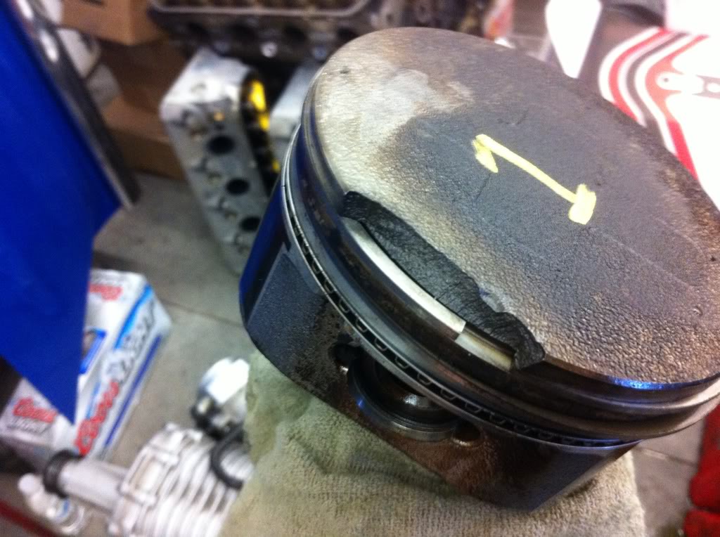

Proper ring gap is important. Just because many people get away without checking/adjusting ring gap, does not mean you will automatically get lucky also.
