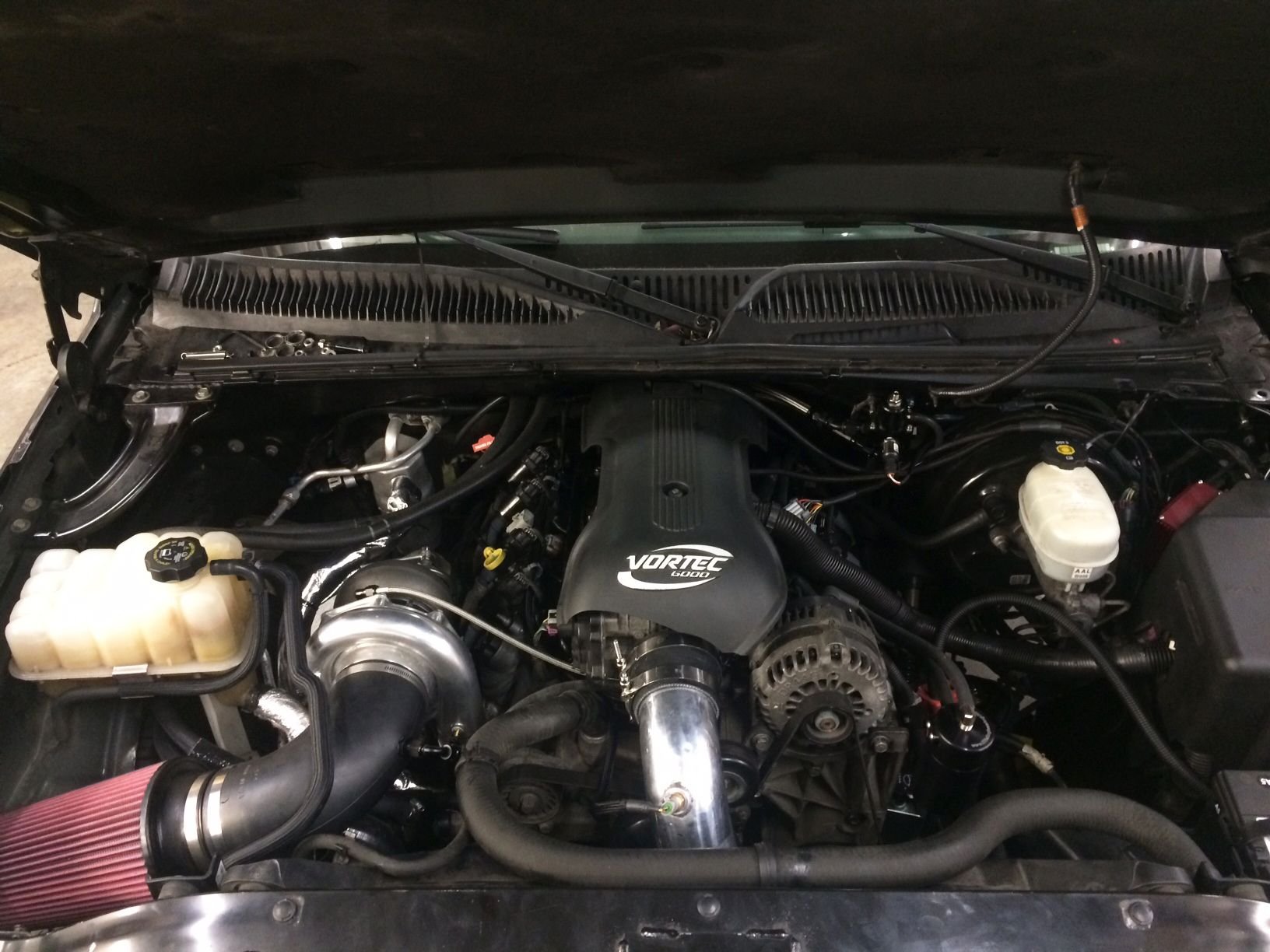

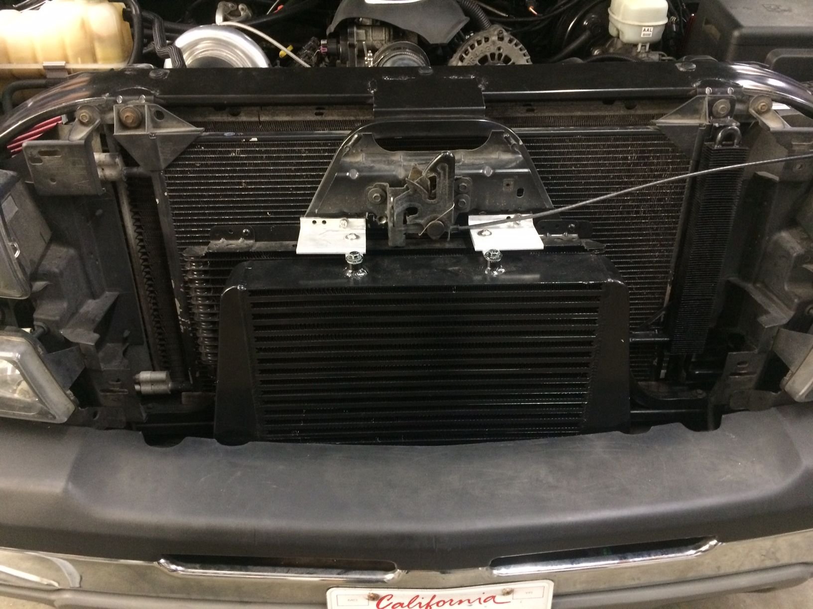

Ok guys I'm "getting close" lol. I still need to run my vacuum lines for bov, wg, fpr, bap, and boost controller. And I still need to tighten down all the silicone couplers. I had the intercooler in and out a few times when I was making the trans cooler lines to make sure everything had enough slack / clearance etc.
Once this thing starts, drives, and doesn't blow up on the lightest spring, I plan to takes a few more pics of everything This build isn't exactly unique, but each one is kinda unique in their own way. The only thing I am not fully stoked on is the oil cooler brackets. I just bent some stainless temporarily just so I could run the lines from the thermostat adapter. I plan to bend/ weld something proper shortly.
I tried to use an acceptable amount of DEI heat sleeve, DEI fire sleeve, and OEM type "techflex" sleeve without going over the top. I also like using heat shrink wrap and weathertek OE-type connectors wherever I can lol. However I also don't like overdoing the reflective sleeve so that it dominates the whole engine bay. I am still waiting on a 36" piece of DEI fire sleeve (black silicone looking) so I can cut it in half and slide it over the two heater hoses above the downpipe. I plan to list id's, lengths, and type of sleeve that I used in one of my next posts. I just need to go over my receipts to make sure the info is correct.
I may not have mentioned it in previous posts, but my fuel system to some will sound insufficient. A single Walbro 450, custom -8AN bulkhead, Fuelab inline filter, -8AN ptfe feed, -6AN ptfe return, Holley rails, ID1000 injectors, and a Kenne Bell 20V "competition" boost-a-pump which runs off a hobbs switch. My tuner has tuned a number of cars past 700whp on E85 using this setup, and I want to try it. If it proves insufficient, I will add the 2nd Walbro 450 and eliminate the BAP. I plumbed the flex fuel sensor into the return line, so I hope to be able to run 91 or E85 and if for some reason it turns out that I need to load a separate tune for gasoline vs E85, at least I'll have another cool looking gauge in the cabin to monitor ethanol content lol.
Note, the motor is not a 6.0. I haven't been able to find my 5.3 cover so I threw this one on to cover how dusty the intake is.

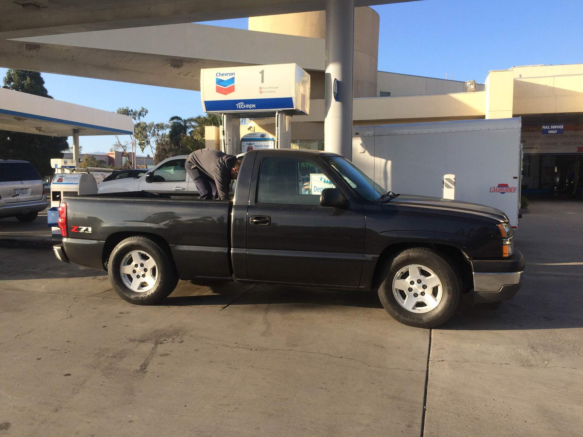

Anyways, here's the truck as it sits yesterday. Getting some gas for my brother's truck. Haven't washed it in 6 months. I need take a bunch of better pics when the lighting is better and I can get it up on the lift.
