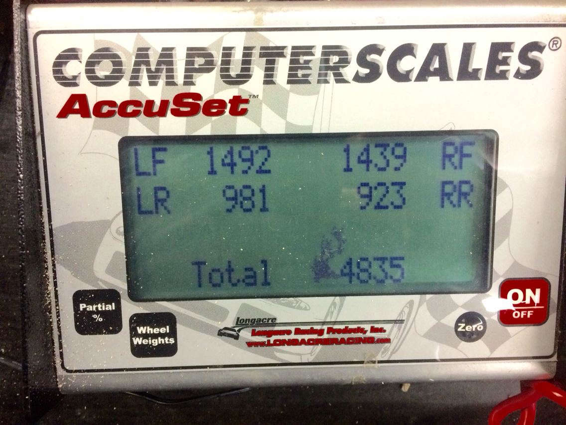

Ok guys thought I would throw the truck on the scales tonight just for *****. 1/2 tank, spare tire and hitch. The only weight savings on this truck are the diff cover and the coilovers. Added weight are the turbo, Cal-Tracs, 80e. Truck has stock 4wd wheels and 265/70/17 Goodyears. 4835lbs without me in it. Is this heavy or about average?
