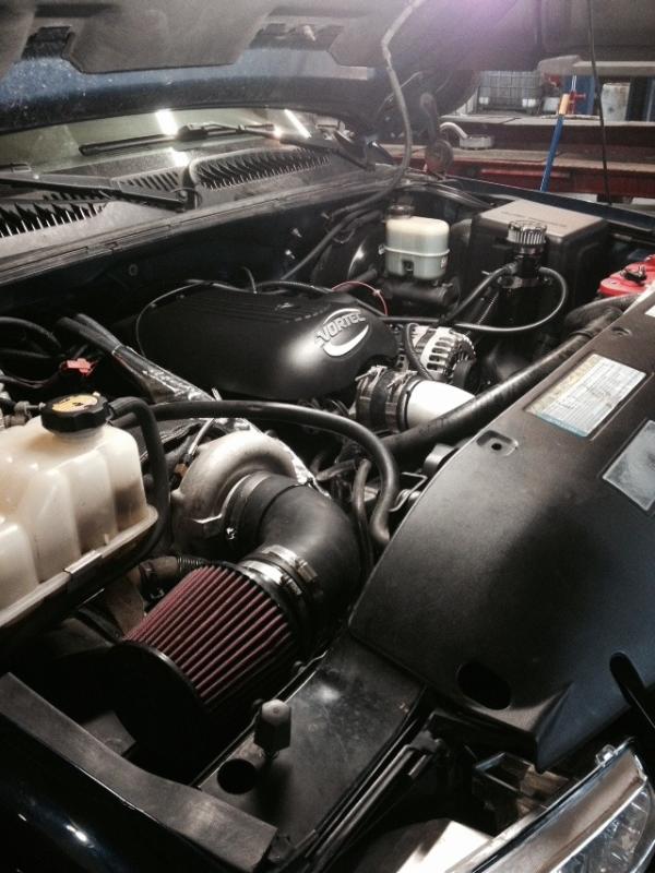

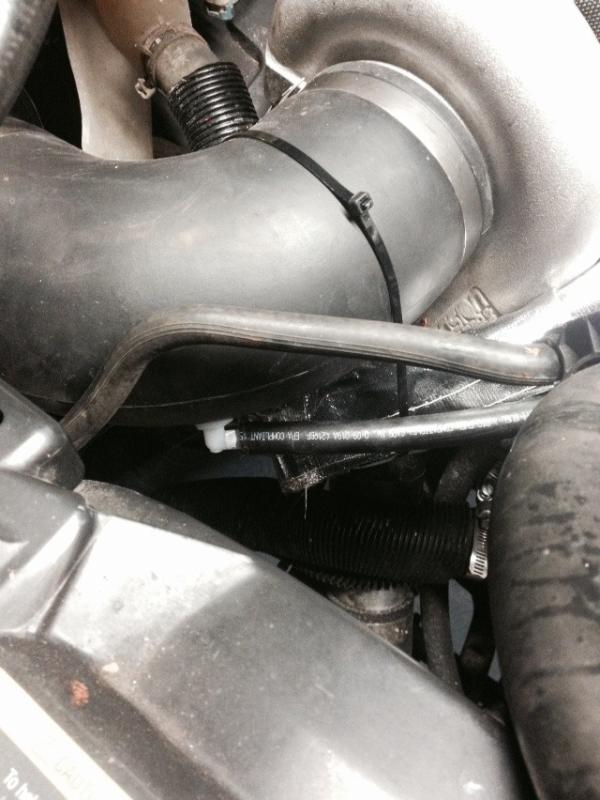

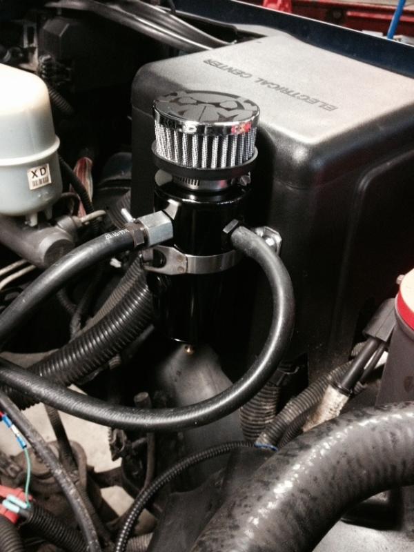

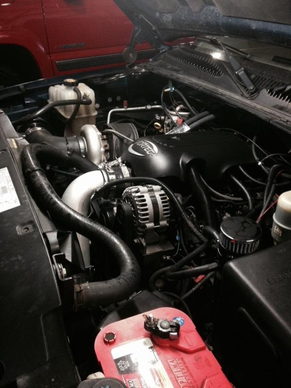

Few updates fixed turbo flange leak and installed a mightmouse catch can.

Passenger valve cover going into intake tube
