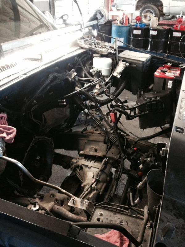

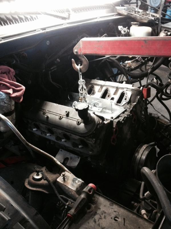

Hello everyone finally gathered enough parts for my lq9 swap and turbo on my 2000 Silverado z71 with 240k with lift keys and a 3in. Body lift on 33.5" tires
Lift of parts
-LQ9 6.0L stock bottom end with new bearings and rings
-Ls9 head gaskets
-ARP head studs
-222/224 112LSA comp cam
-comp push rods
-New gm lifters
-Summit Racing 1.7 roller rockers
-stock 317 heads cleaned PAC 1218 springs
-Trick Turbo kit with 74/75 precision turbo
-60lb injectors
-walbro 255 fuel pump
-circle d 3200 stall
-Justune pcm tune
Power goals for this setup is for 500whp on 9-10lb boost until more fuel upgrades and stronger trans
Motor came out of 2004 escalade with 134k

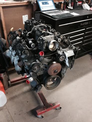

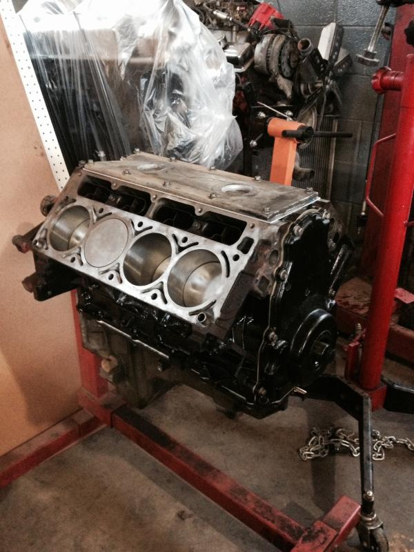

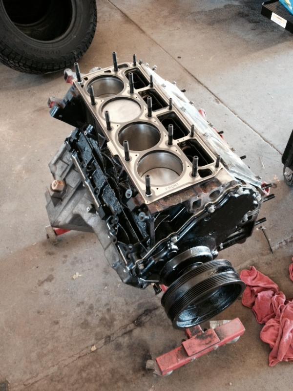

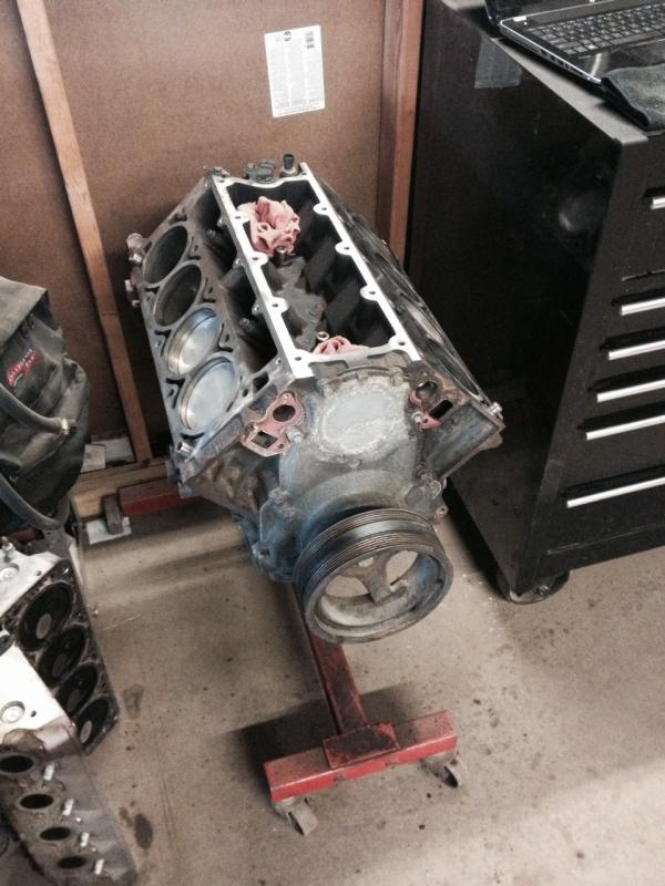

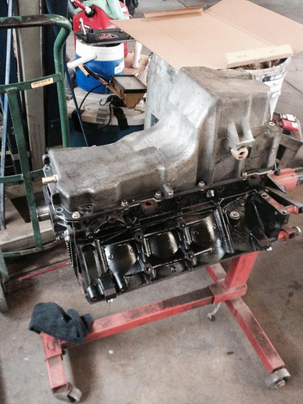

Tore down motor 134k

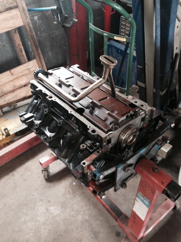

Cam bearings

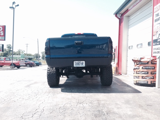

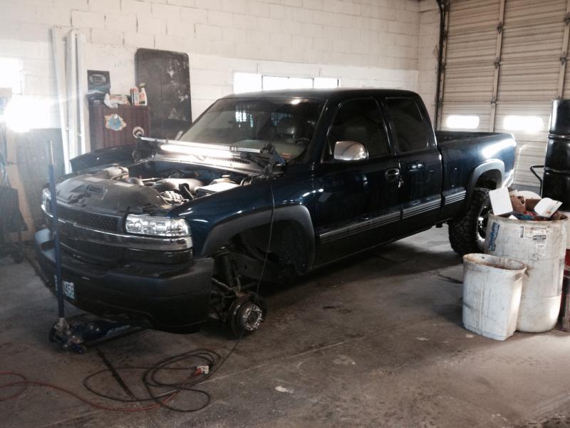

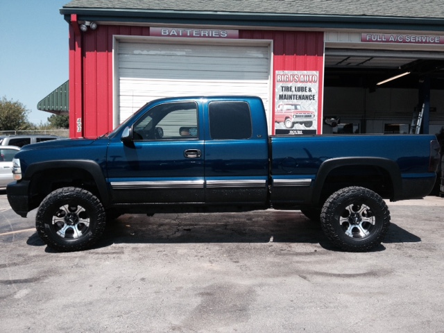

Few pictures of truck
Exterior mods are leveling kit up front with 3in. body lift with HD hood and grille Line X sides and roll pan wrapped on 16x8 dick cepek wheels on fierce attitude M/T 33.5" tires

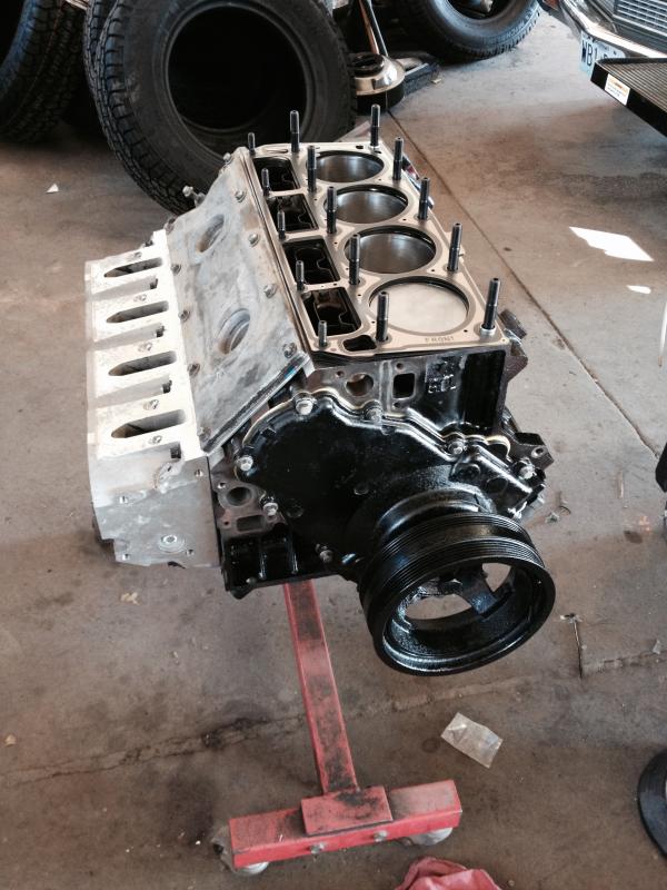

Installing LS9 head gaskets and ARP studs

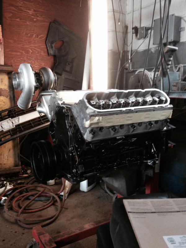

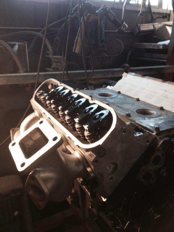

Quick Teaser with Turbo

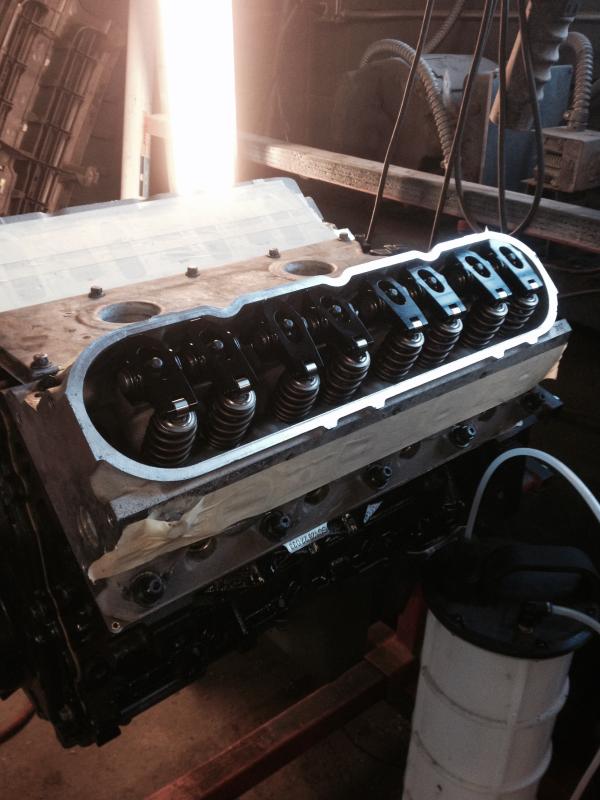

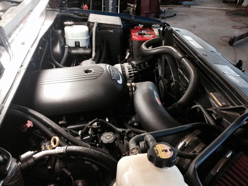

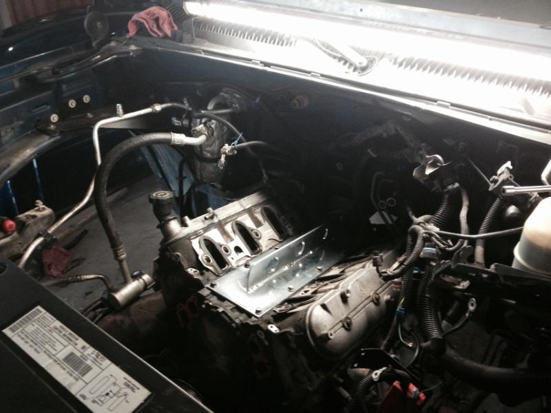

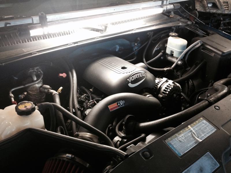

Here I am today's date 11/29/14

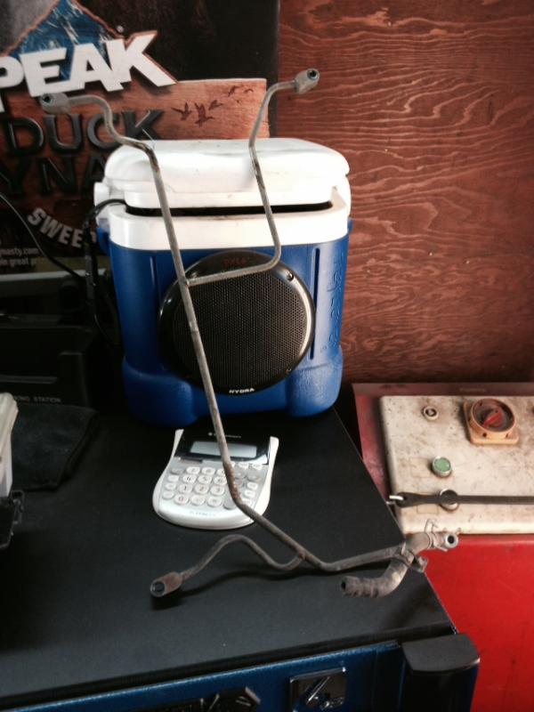

Needing some opinions on this my 5.3L I pulled out had these coolant lines on the valley plate but my 6.0L had just the front line and the rear two blocked off witch would be the better way to go
