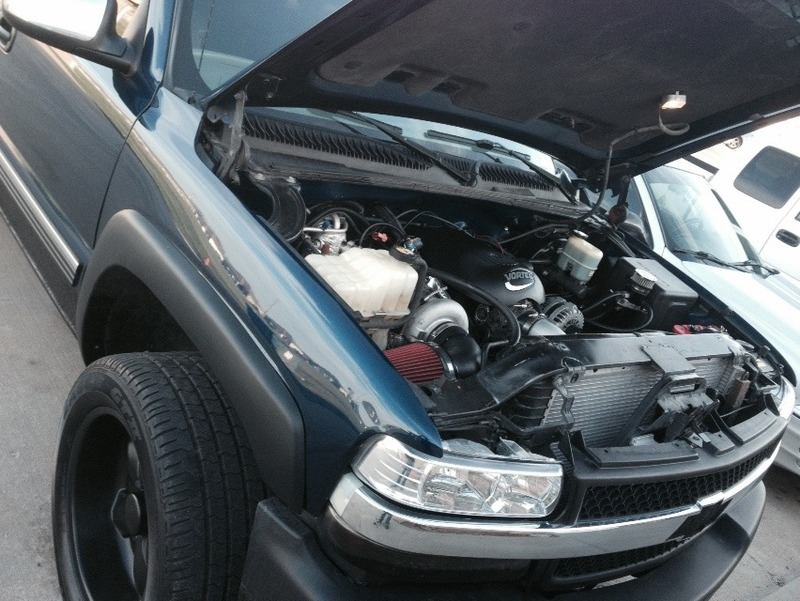

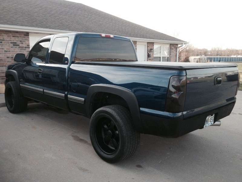

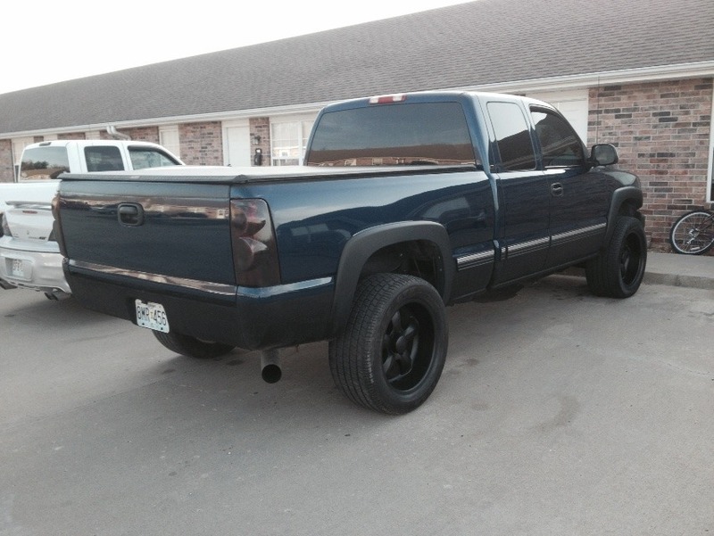

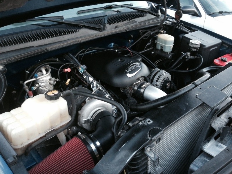

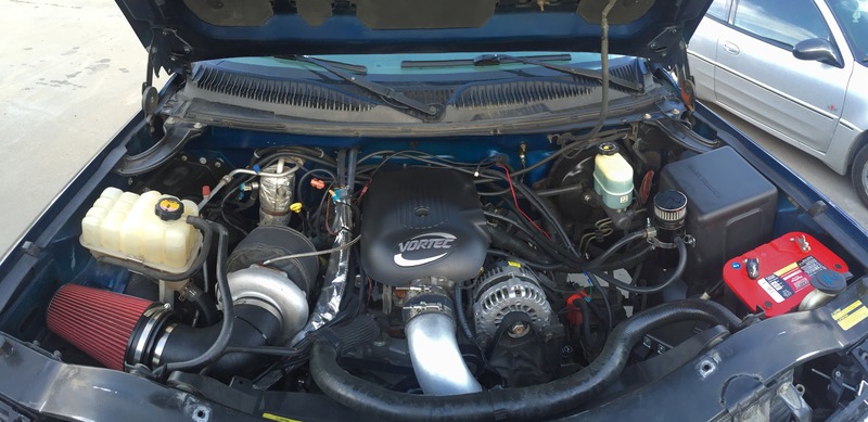

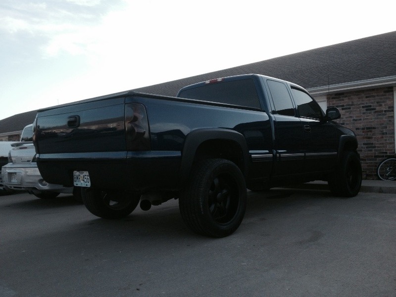

Small update on lowering it small amount to get my CV axles more horizontal & tie rods and found this set of used wheels 20x10, brand unknown with 305/50/20s with only 1st and 2nd gear she will haul *** tell 50mph lol
