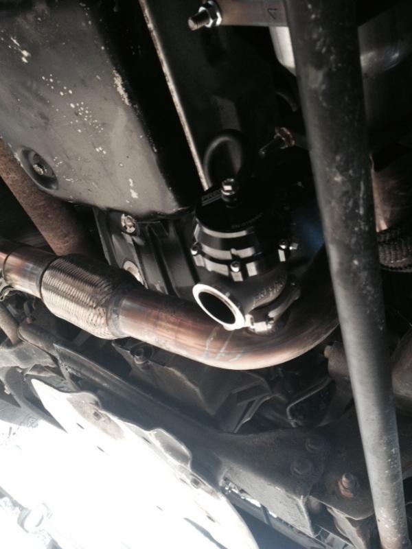

Finally have the boost under control running at 6psi, I talked to Rick at trick performance and he worked with me really well my setup ended up being dual wastegates with a 46mm precision gate with v flange adapter made from him and the 38mm gate up on the manifold works great.

So explain how you did the dual gates. Did you put 6psi springs in both gates? Did you T the vac line going to the 1 gate into the other? Do they open at the same time? Tell me as much as possible ha ha

I put equal springs in both and T both my vacuum source and my boost controller that went to top ports of the gates, they both open at the same time for having two different gate sizes they work well with each other.

They don't depending on what stage kit you get you get a single wastegate just in my setup I had to run two to keep mine under control one wasn't enough
