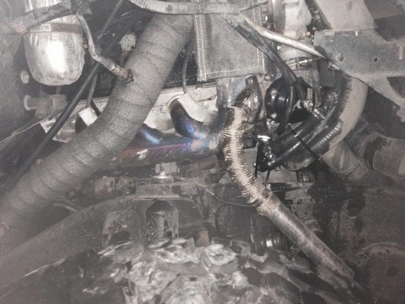

Ok took waste gate off everything was working perfect I dropped the spring down to a 4psi spring and still spikes I hit 16psi at WOT here is my setup

Probably needs a bigger wastegate.

It's a 39mm waste gate that came with the kit

I don't think those waste gates like being hooked to a vacuum source. I have mine referenced off of the compressor housing, which is only boost. The wastegate needs the boost pressure reference to help it open.
On the other hand, when I put my 4" down pipe and exhaust on, my 38mm wastegate had extreme boost creep. I now have a 60mm wastegate and can maintain 4lbs rock steady.

I will try going off the turbo, good point
