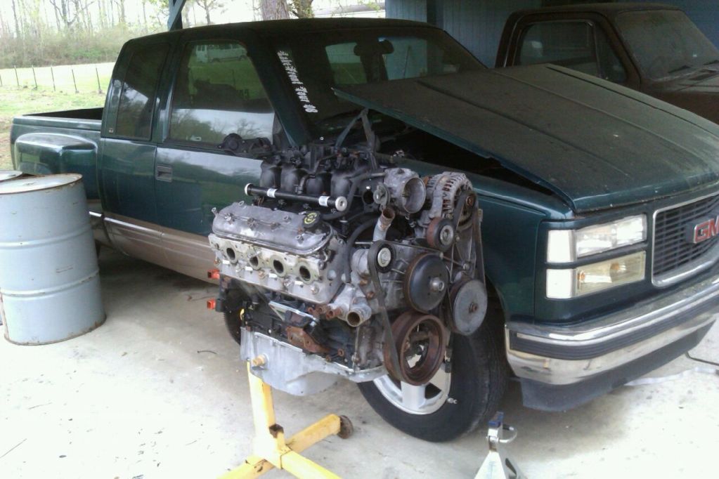

ok guys, still outta state, cant get much done in the 1 and a half days im home on the weekend! but i did get the 6.0 to my house finally! im still doing some research, getting a rock solid plan together before i start buying parts! iv talked talked to a member on here about a fuel cell. a good friend of mine found a 14 bolt from a 4x4 for dirt cheap, hopefully it has 3.42s, would save me from having to buy a gear set. but anyways, heres a pic

if its from a 4x4 it has 6 lugs, and the axle shaft diameter of a 4x4 and 2x4 in our OBSs is different thickness. you could just get front break rotors from a Z71 and just buy 6 lug wheels

Um my wheels are 6 lug? And its a 8 lug axle, I'm gonna convert it to 6 lug
