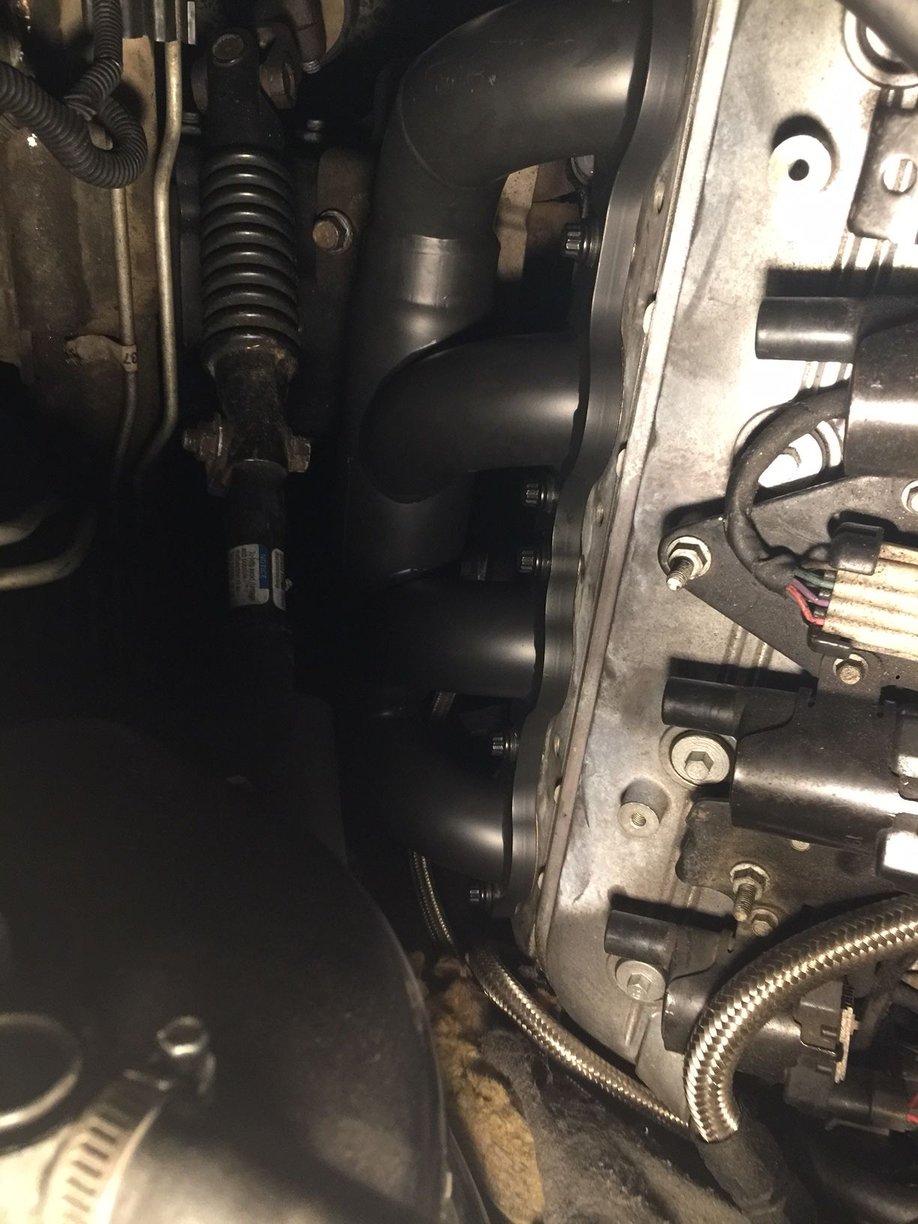

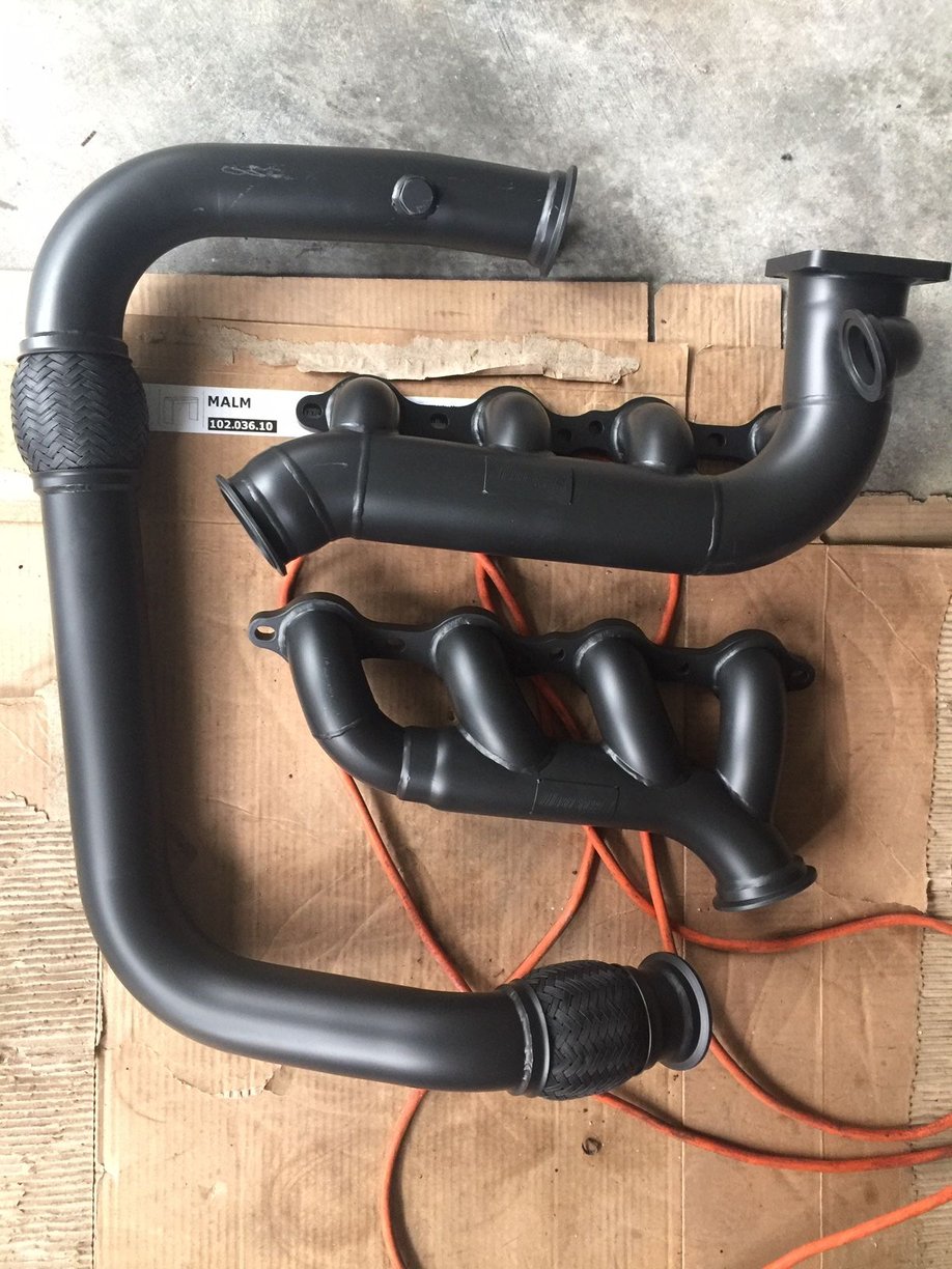

Installed and also got some Firecore50 spark plug wires. Those things are nice.
Ceramic coated to hold up to 2,000 degrees
Coating done at Performance Coatings in Auburn, WA. Will do the down pipe and turbo housing later this summer.
