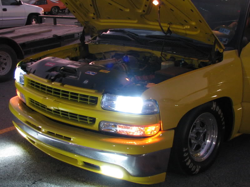

This is how it started back in 04-05 I believe, just a 6.0 lq4 ls6 cam and tune by Nelson Performance

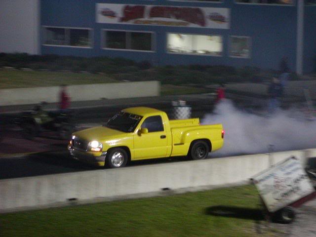

At SAR running 13.4 I remember lol

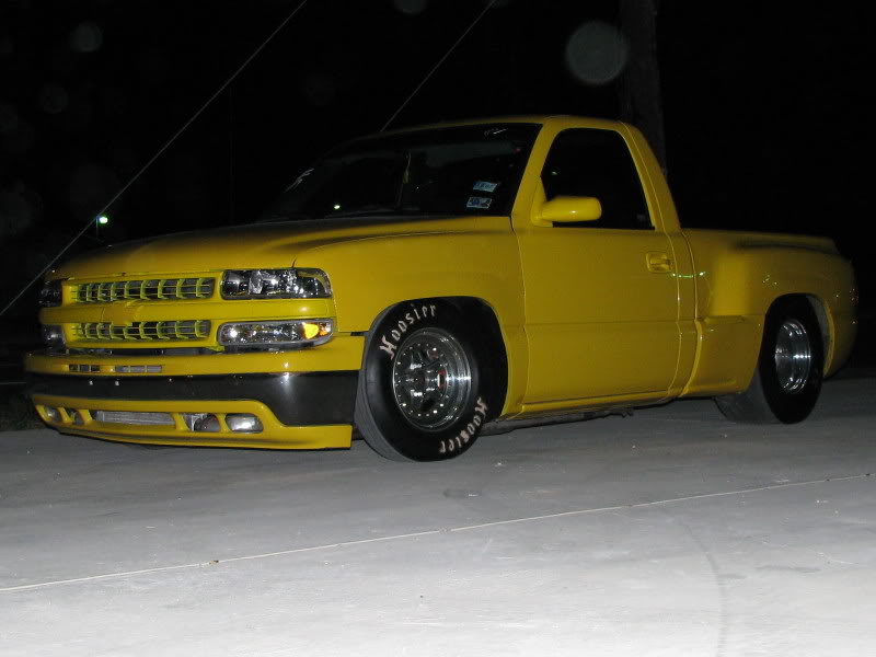

My Trucks..

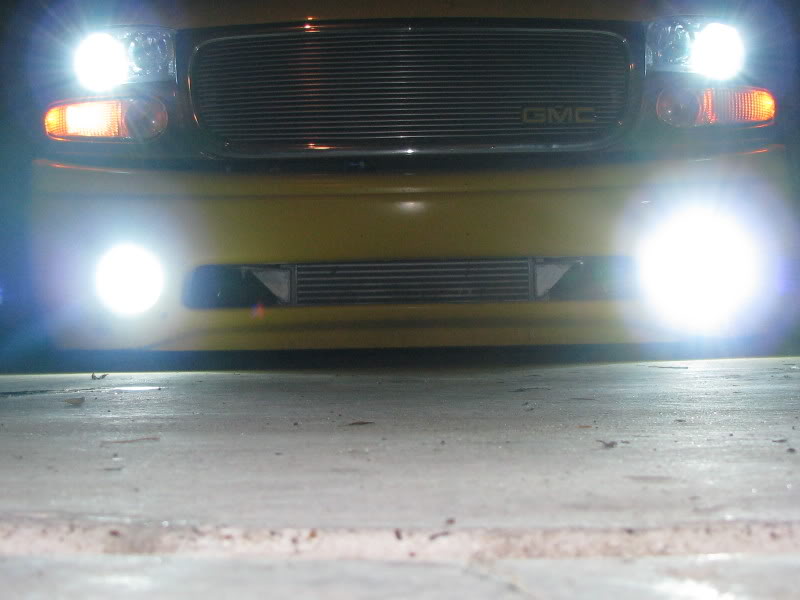

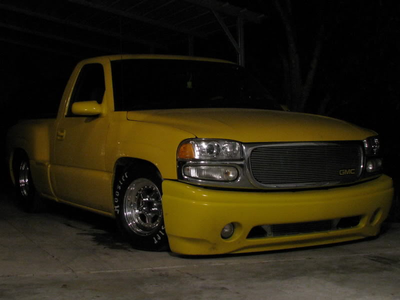

At one time I had the Denali Front but had to sell it since I would drag the bumper ones I swap to the bogarts...

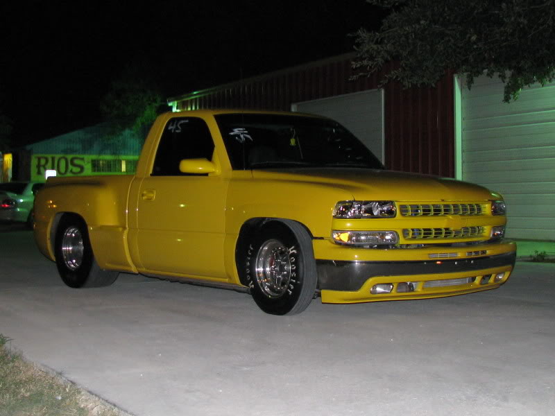

Changed to a Silverado front end...

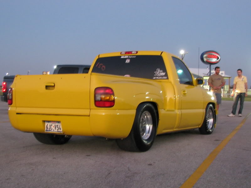

This is at Nelson Performance after SAR

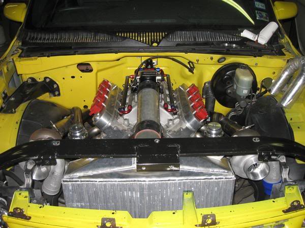

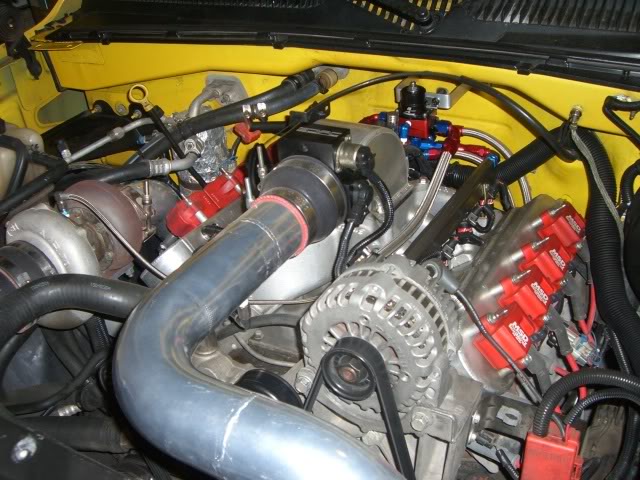

My truck has been thru a few setups like the STS Turbo and then to a Tick Turbo that's when I ran my best 10.74 @ 128mph in 08 I think... but blew a piston on a street run, I forgot to put methanol and few gallons of race fuel like I would do... Sold the Trick turbo kit and took the truck to get a Twin Turbo Setup which haven't been able to use.. (in storage waiting for a boost engine)

Then it sat for about 2 years and I started on it again this time I took care of everything, remove a/c rewire the harness and add and wire custom gauges, with an lq9 and the rest of my mods on my sig this got me to a 10.53 @ 127 with a 150 shot, this time tune by me...
JJ 10.53 pass - YouTube
Truck had ways to improve as I went from 4.11s to 4.56s and was gonna start going bigger on the jets but......I decided to paint the truck and add a few cosmetic details and went too far as I sold the 6.0 and started on my 383, so this has taken over 2 years ones again but now its closer to been done and here and on is where I will try to keep the updates...

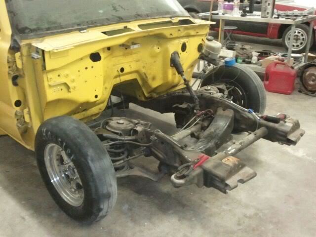

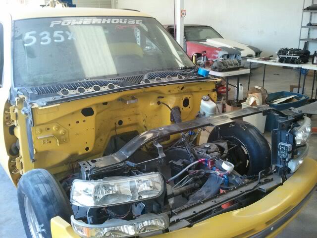

Ok this is when I get out of hand and decided to do the whole thing...
Got rid of all the stock brakes lines, ABS module, master cylinder and booster, going with the Burkhart Chassis manual brake kit and gonna run all new stainless steel brakes lines..
