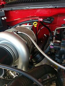

Originally Posted by slonlow2000
Just read form front to back, the attention to detail is amazing! Great read so far, keep it up. On your trans cooler lines going into the 40K did you make those or buy the lines premade? My OEM lines have been damages, if I could buy a premade set like that it would be a time saver.
Those might be out, there, but I made these myself. Just got a roll of -6 line and some fittings

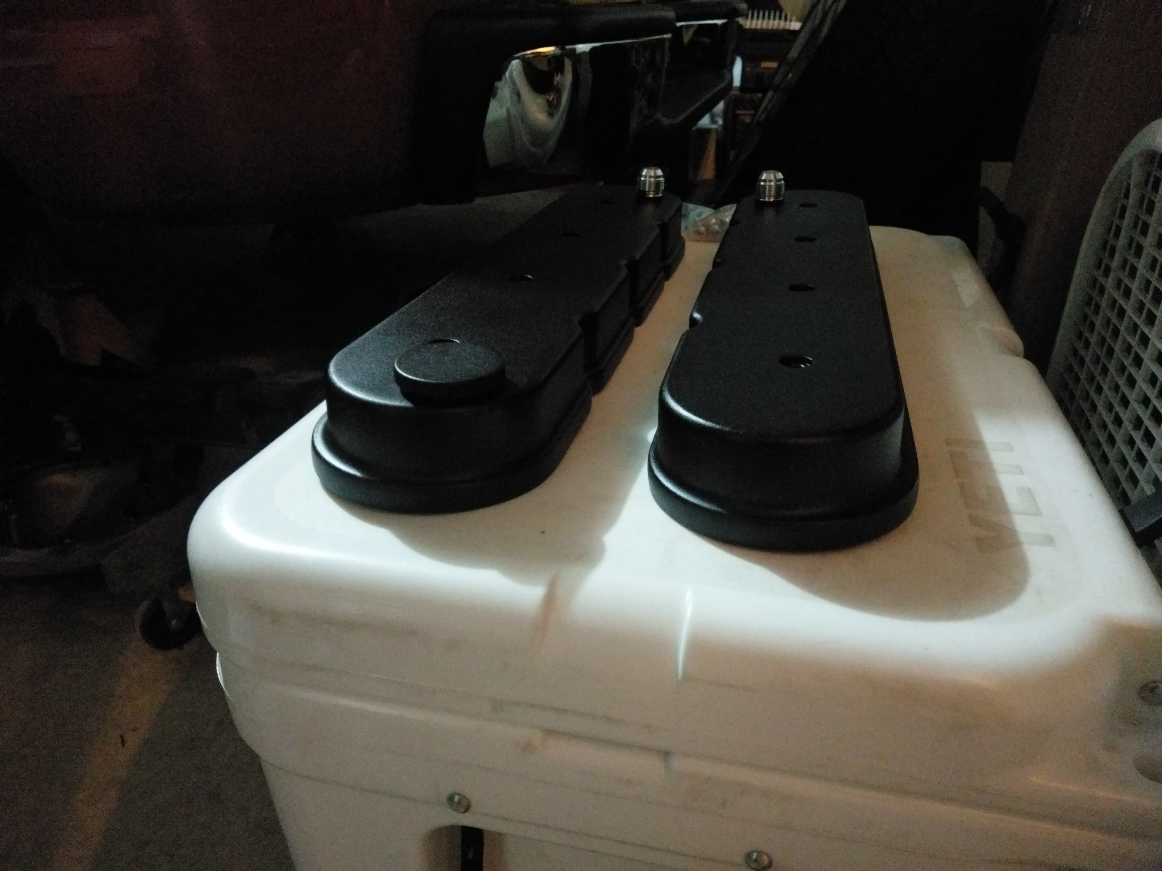

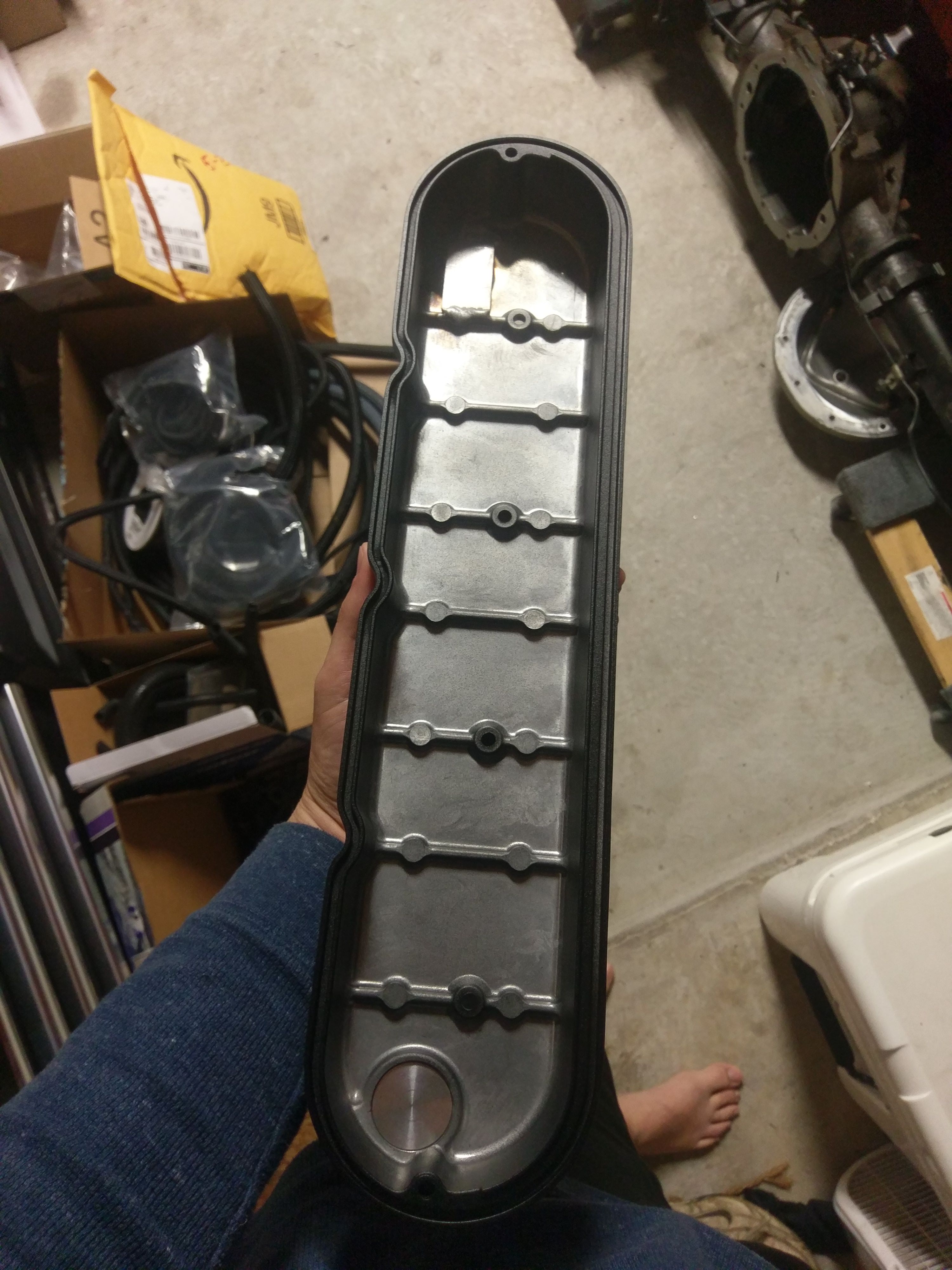

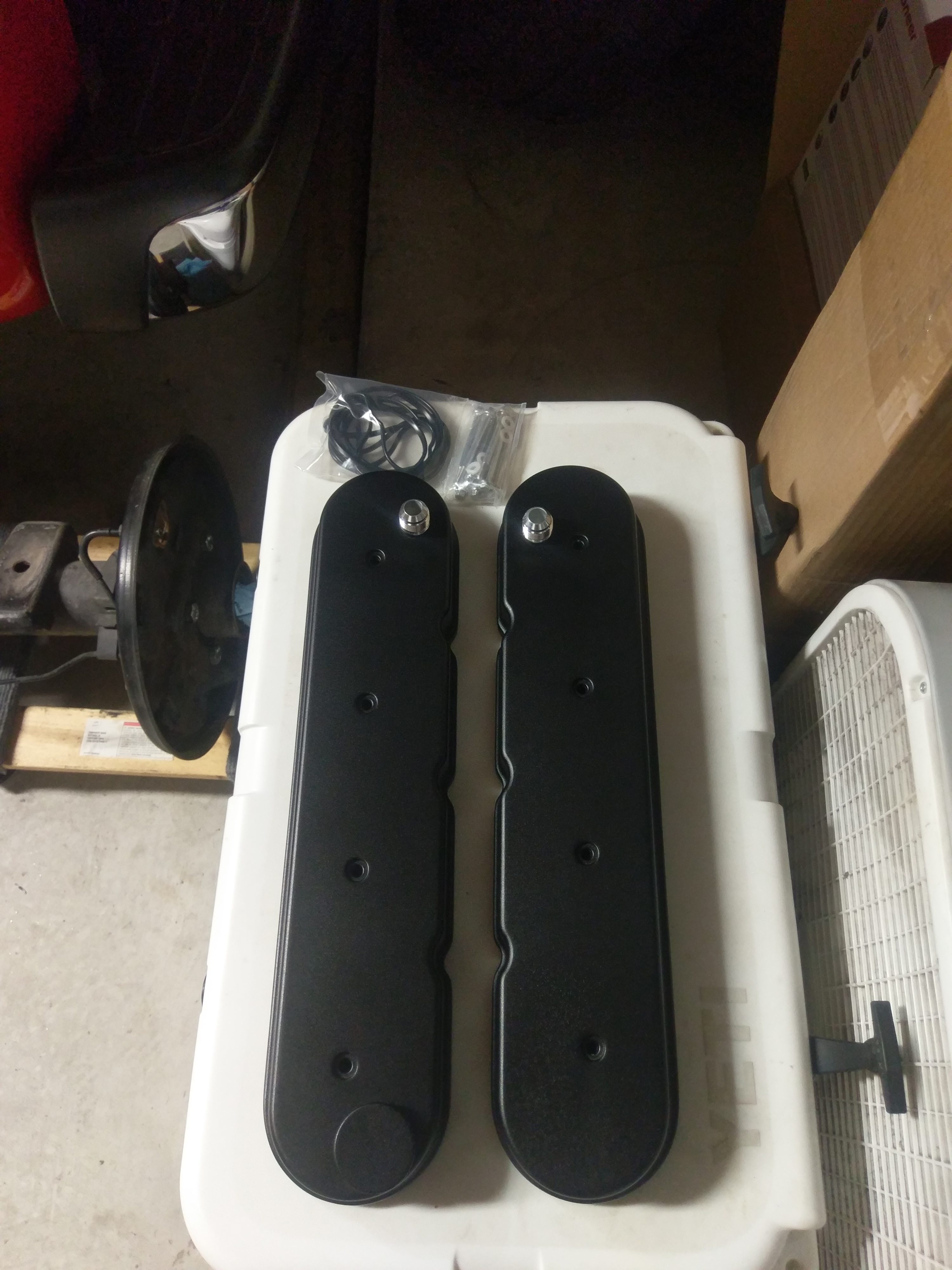

Not slot of progress since I've been battling with some stomach bug, but my valve covers came in yesterday

I am curious to see the clearance between the passenger valve cover and the firewall.

I had to ditch my tall valve covers. It put the coil into the turbine housing.

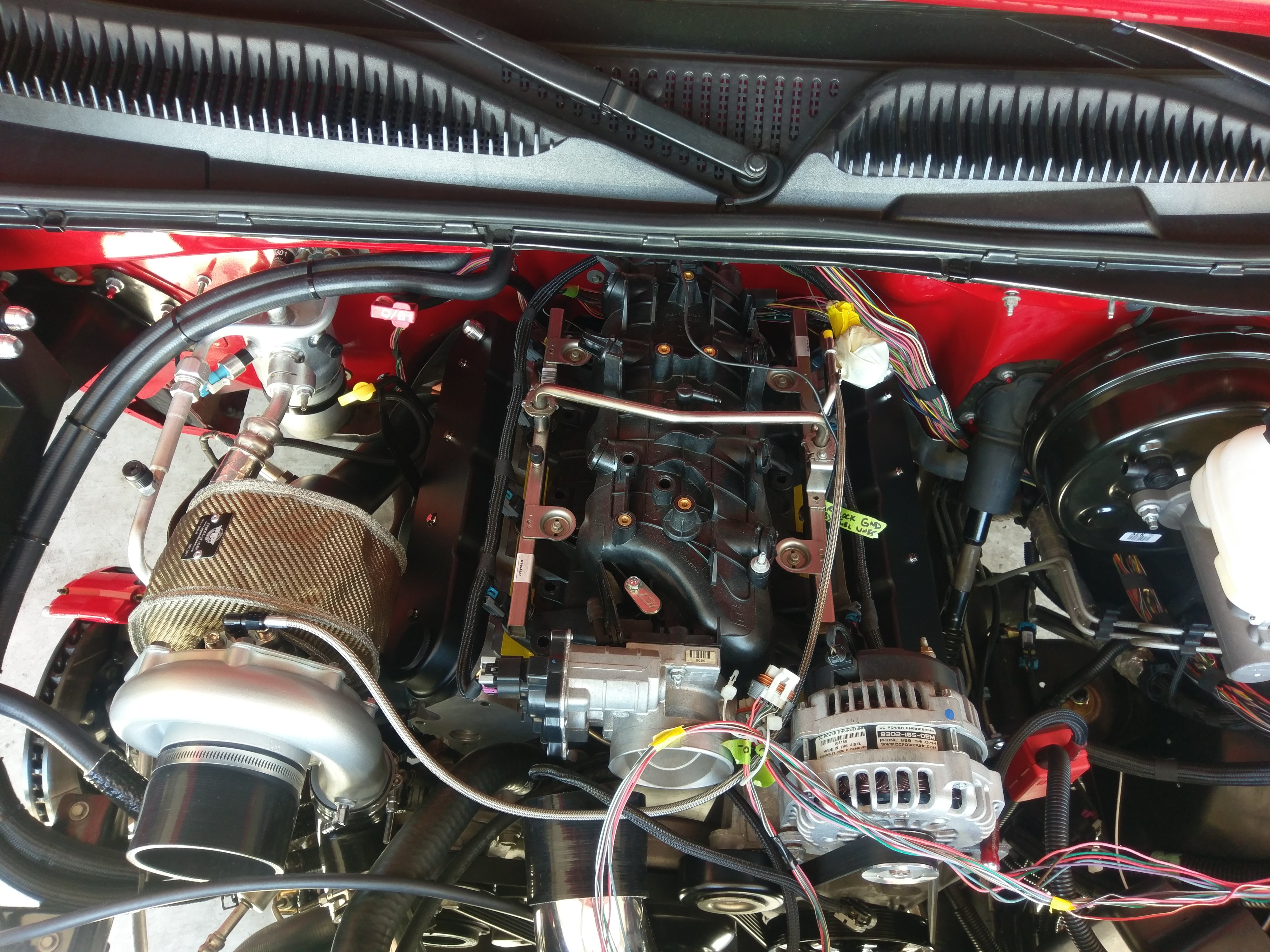

These aren't very tall, and no coil packs to worry about. Should fit, but I won't know until I can get over this stomach bug I got

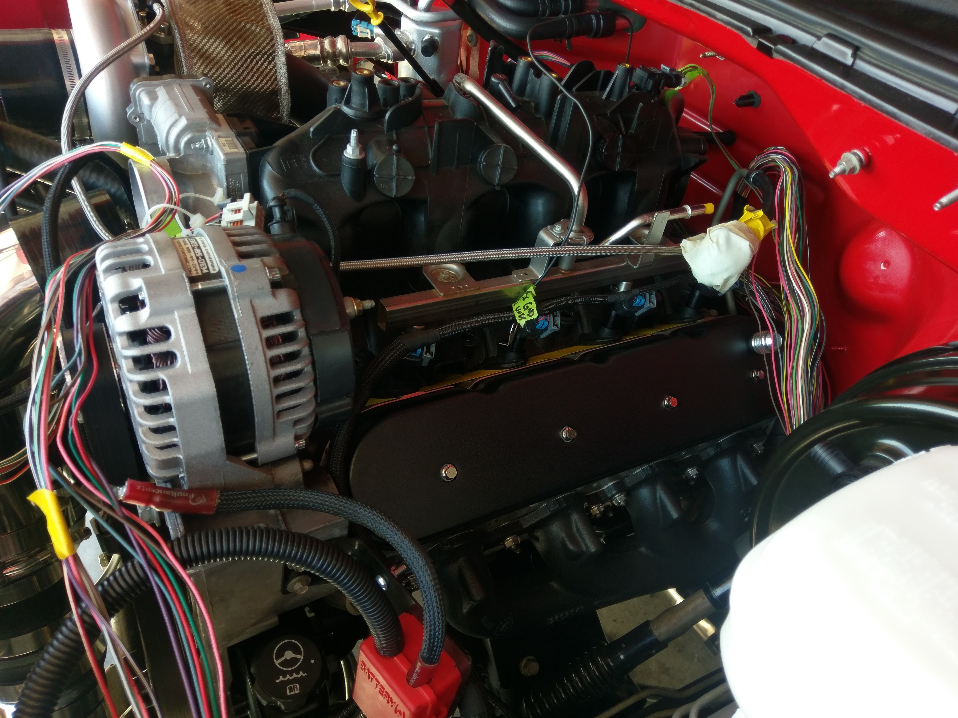

Well hopefully my truck will put down the power yours does, because I could live with that
Everything fits great

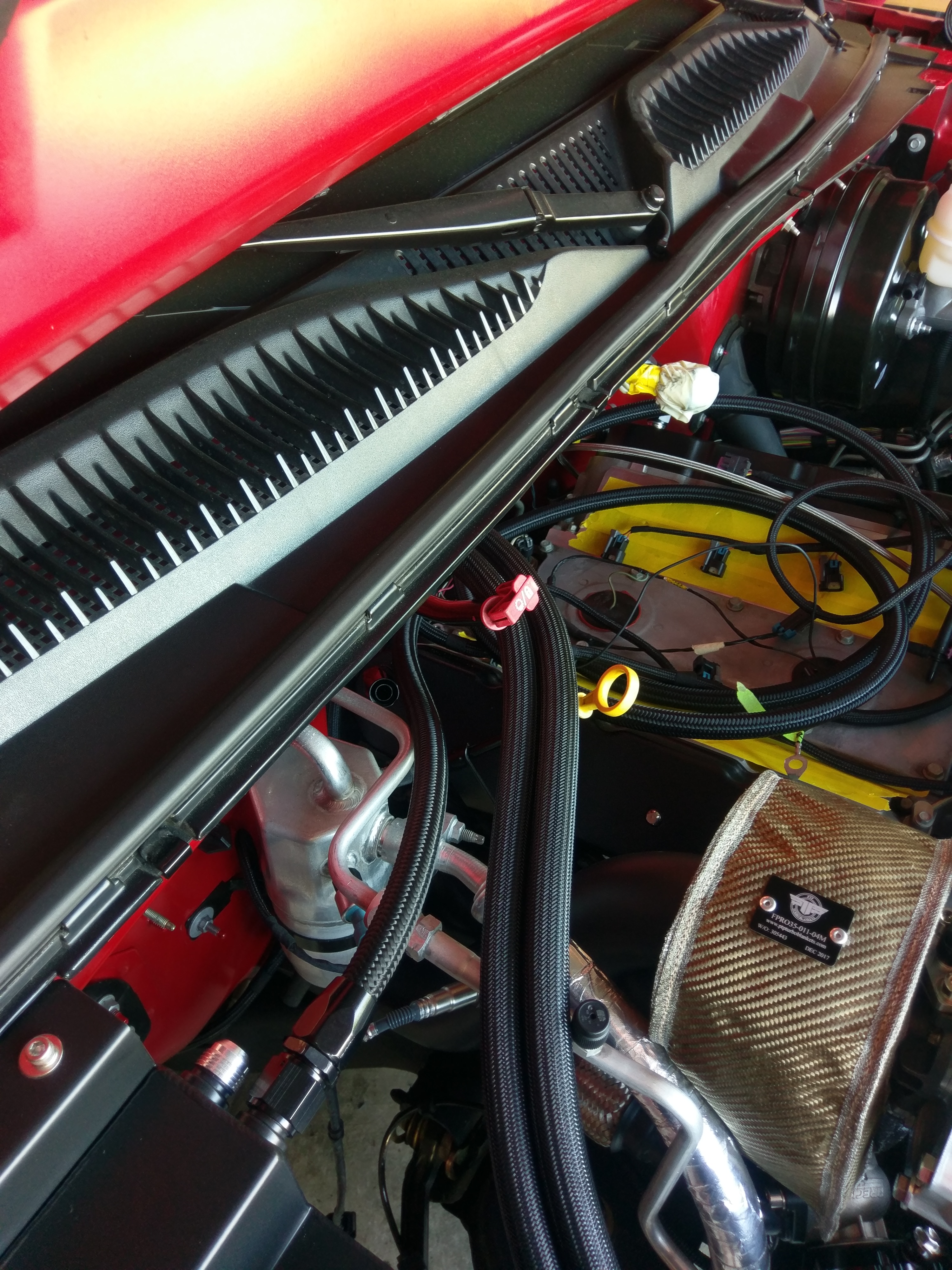

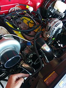

So I didn't like the way the heater hoses and catch can lines ran across each other, so I redid the heater lines yet again. Im also wrapping all hoses in techflex for protection, but also so it looks like braided AN lines.
ILuvJDM's 2007 NBS RCSB Build - Turbo/4L80e/Coilovers/Wilwoods-seiv8p0.jpg
ILuvJDM's 2007 NBS RCSB Build - Turbo/4L80e/Coilovers/Wilwoods-lpwewtu.jpg
Upper steamline wrapped
ILuvJDM's 2007 NBS RCSB Build - Turbo/4L80e/Coilovers/Wilwoods-yaf0mgg.jpg

looks good. What different sizes of techflex did u end up using on the harness? thought about doing my new harness with this stuff. Looks way better!
Old May 7, 2018 | 08:02 AM
  #230
ILuvJDM's Avatar
Joined: Feb 2007
Posts: 954
Likes: 59
From: Austin, TX
So far here's what I have in techflex stuff:
Split loom
1/8"
1/4"
3/8"
1/2"
3/4"
1"
Expandable sleeve
1/4"
3/8"
1/2"
3/4"
