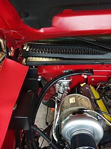

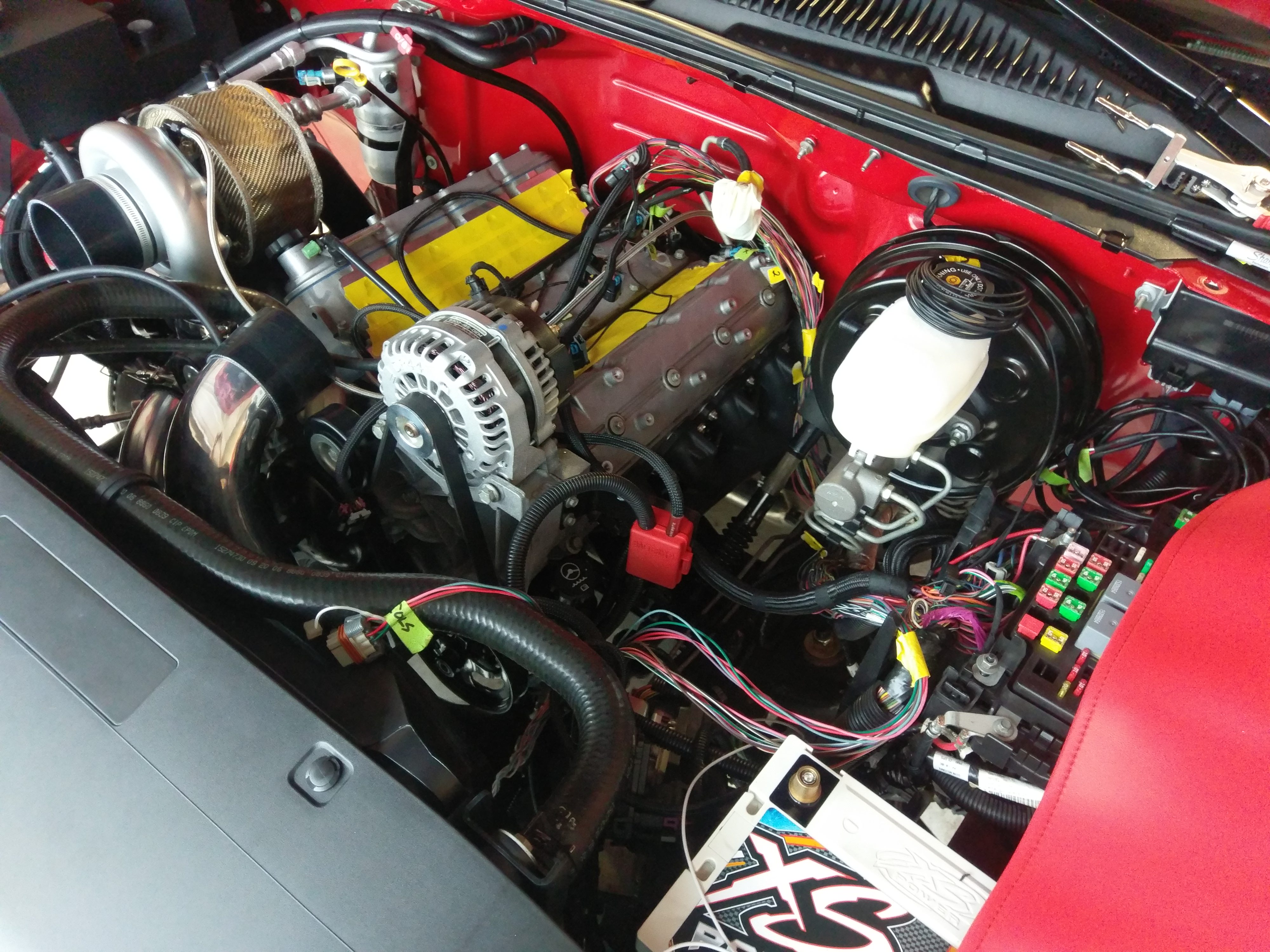

Tried to make more progress on the wire tuck. I found myself stuck in a circle where I had to do one thing before the other, but couldn't start that until something else was routed.
Anyway I finally said **** it and took a stab at the passenger side
ILuvJDM's 2007 NBS RCSB Build - Turbo/4L80e/Coilovers/Wilwoods-ah0gcr2.jpg
Nice and hidden

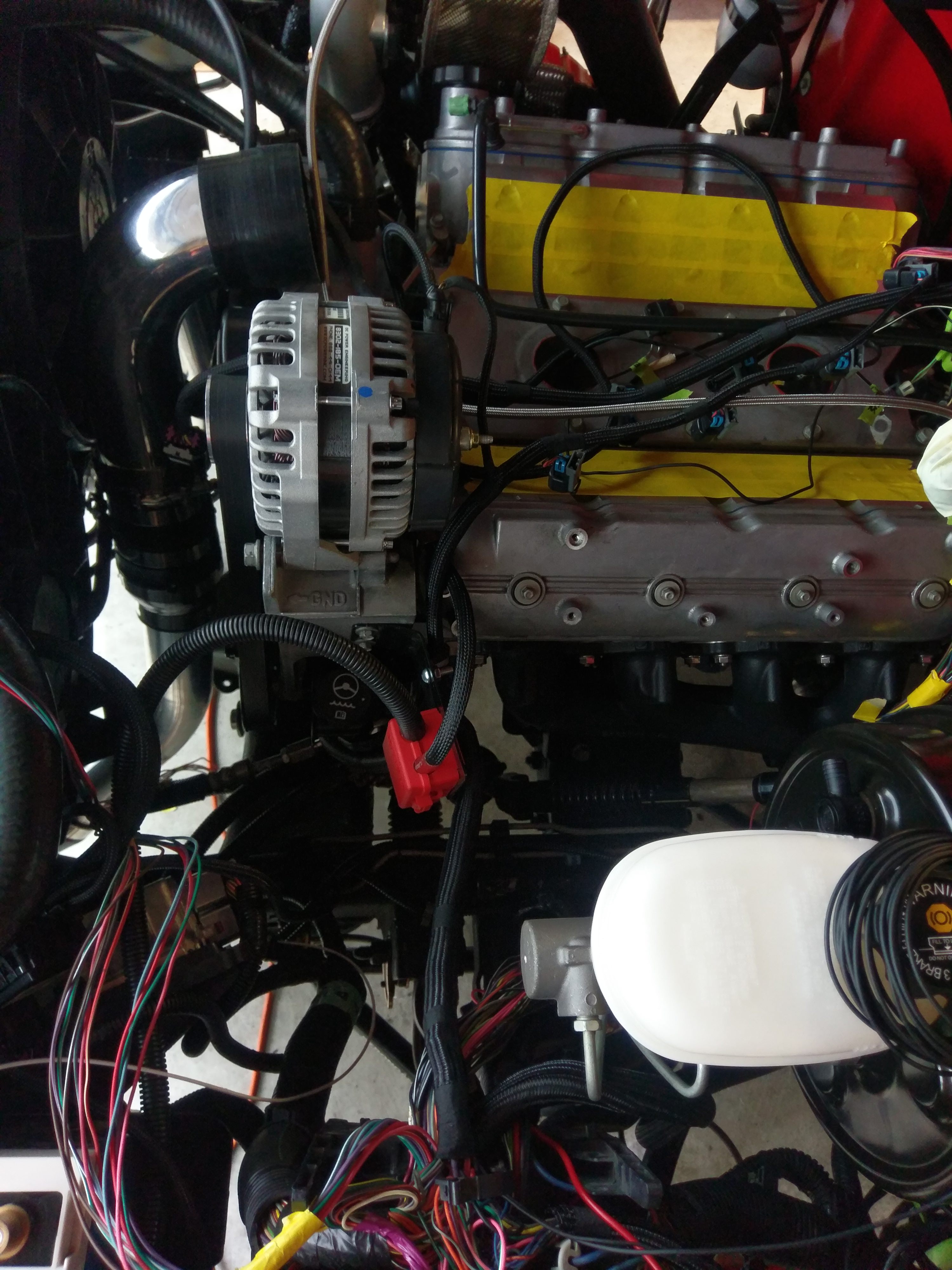

ILuvJDM's 2007 NBS RCSB Build - Turbo/4L80e/Coilovers/Wilwoods-khxg8da.jpg
Got the front harness completely wrapped. This contains the lower engine stuff like AC, oil level, crank sensor, starter, and the upper is coolant, alternator, and drivers fuel injectors.

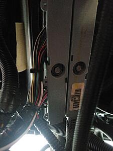

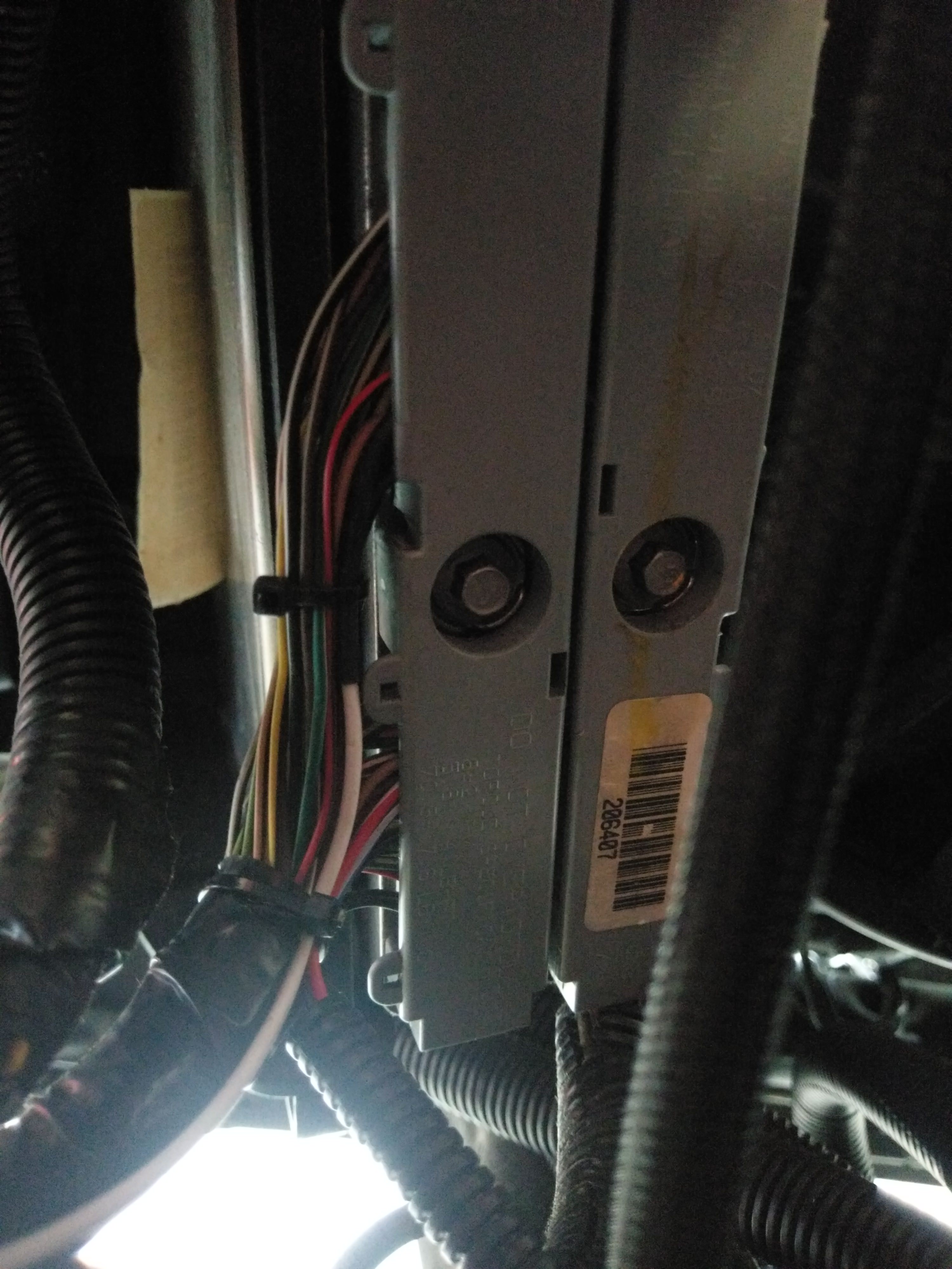

ILuvJDM's 2007 NBS RCSB Build - Turbo/4L80e/Coilovers/Wilwoods-psjjauc.jpg
ILuvJDM's 2007 NBS RCSB Build - Turbo/4L80e/Coilovers/Wilwoods-t3zqe3k.jpg

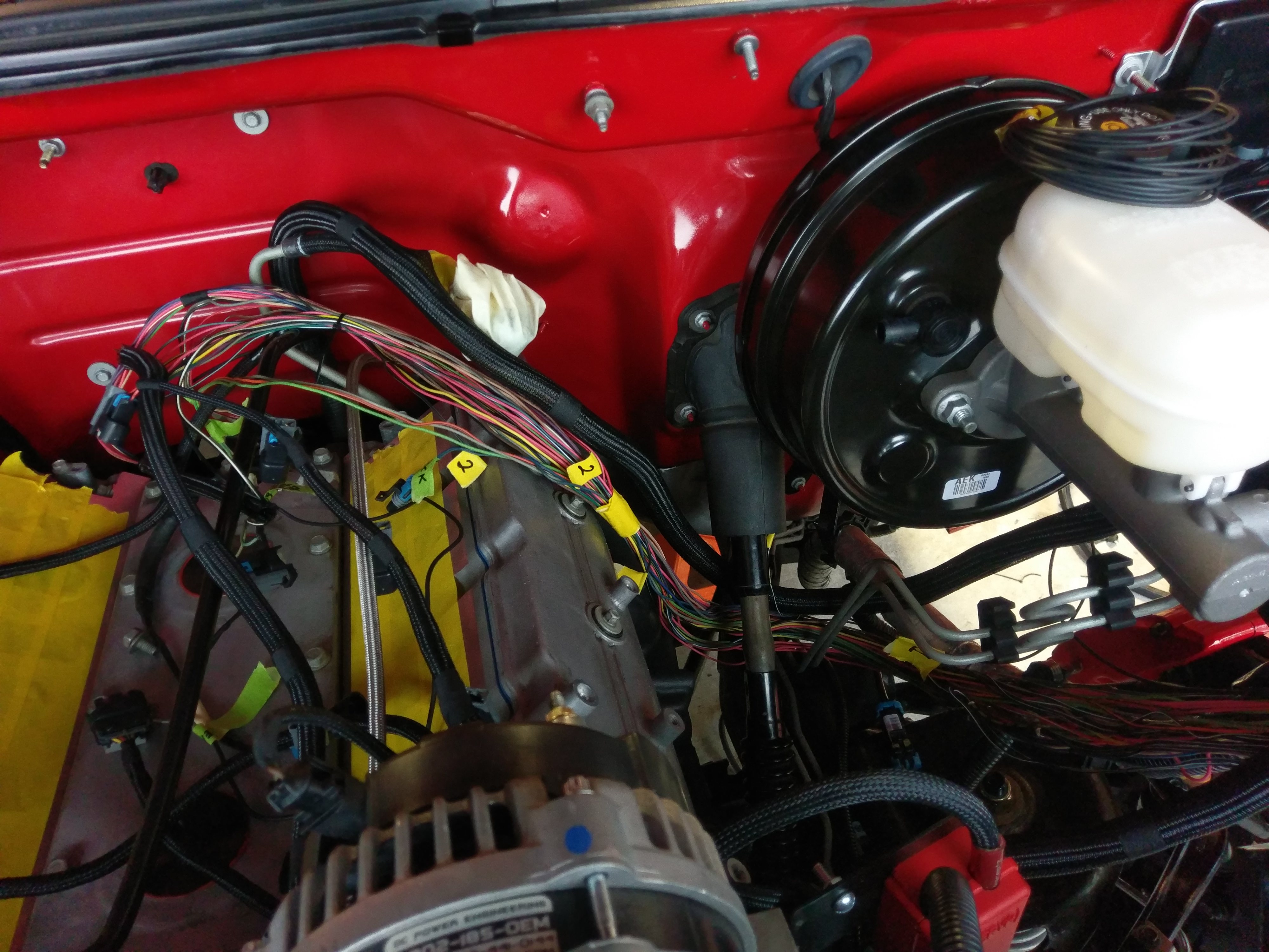

Also got the transmission harness wrapped. It's still got a ton of slack, but I'll find a way to hide that
ILuvJDM's 2007 NBS RCSB Build - Turbo/4L80e/Coilovers/Wilwoods-q9ip7ft.jpg

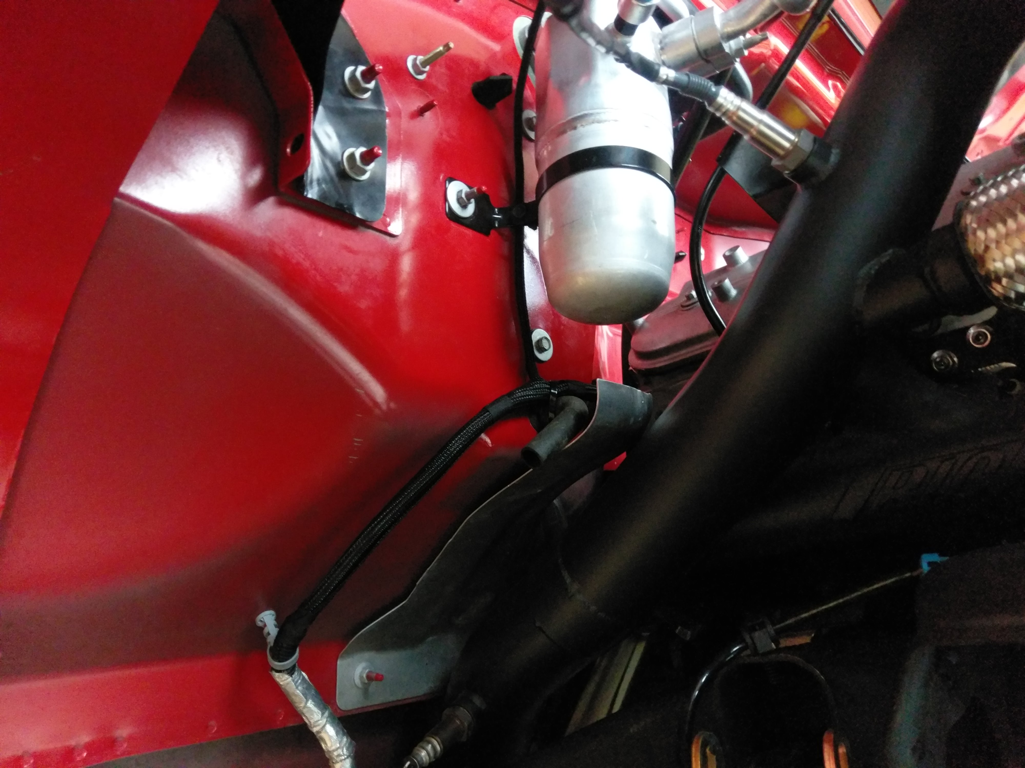

Added the 4l80 harness and a white pin for the wideband logging
ILuvJDM's 2007 NBS RCSB Build - Turbo/4L80e/Coilovers/Wilwoods-mbbtlqw.jpg
