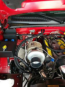

Nothing too exciting, but made a little more progress today. Added an overflow tank in the fender in case the radiator ever blows off pressure
ILuvJDM's 2007 NBS RCSB Build - Turbo/4L80e/Coilovers/Wilwoods-ou2byxx.jpg
ILuvJDM's 2007 NBS RCSB Build - Turbo/4L80e/Coilovers/Wilwoods-to5y6zi.jpg

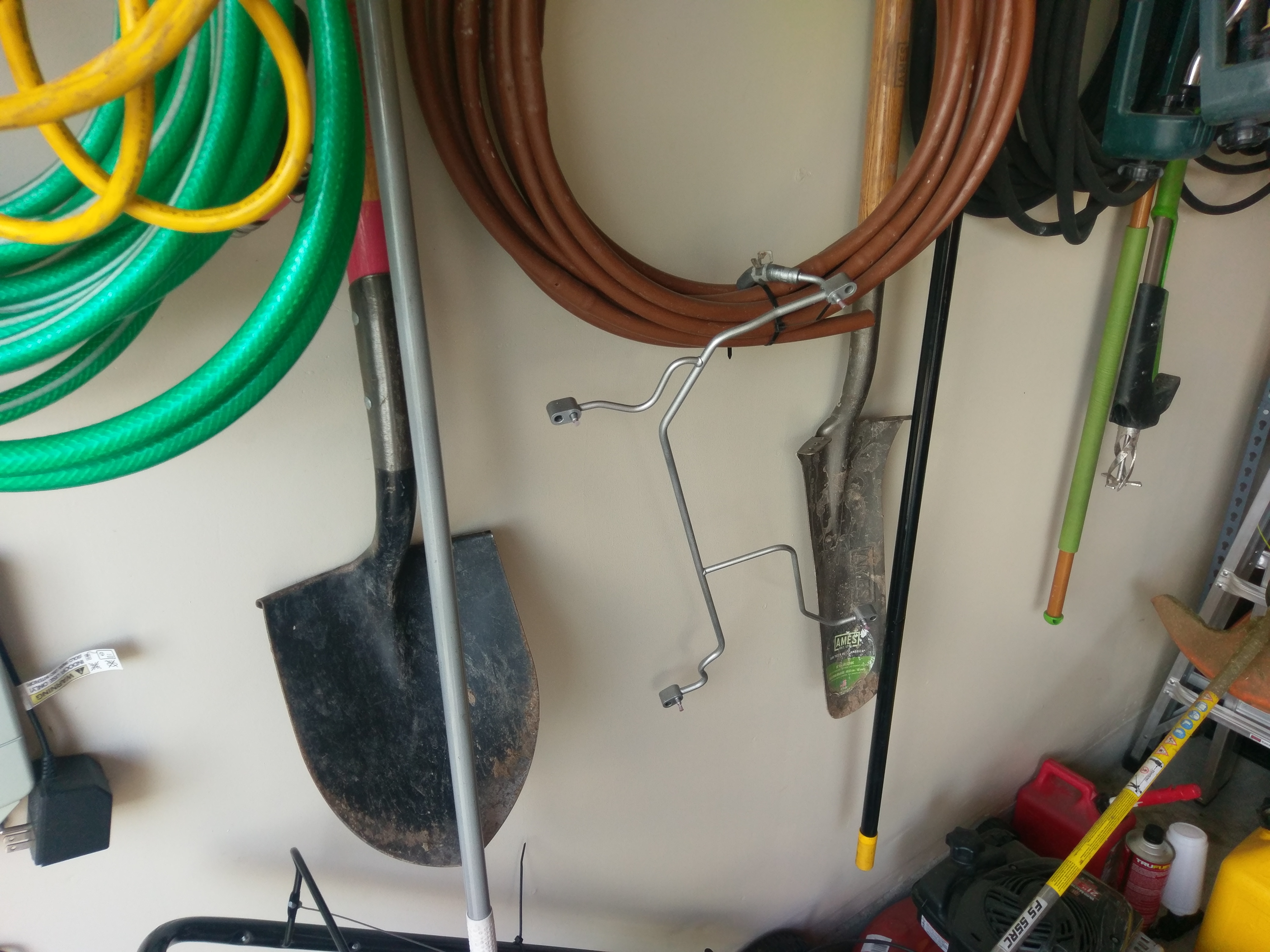

Also went to the junkyard and got a 4 corner steam tube setup, cleaned it and threw some engine enamel on it
ILuvJDM's 2007 NBS RCSB Build - Turbo/4L80e/Coilovers/Wilwoods-nqa68dz.jpg
ILuvJDM's 2007 NBS RCSB Build - Turbo/4L80e/Coilovers/Wilwoods-30gcjq6.jpg
Took the o rings from the oem lines
ILuvJDM's 2007 NBS RCSB Build - Turbo/4L80e/Coilovers/Wilwoods-phx8arb.jpg
ILuvJDM's 2007 NBS RCSB Build - Turbo/4L80e/Coilovers/Wilwoods-7dpcn62.jpg
Also scored a clockspring for steering wheel controls to put back in the daily driver. The steam tube and harness were $20 total. Last time I got a clockspring harness on eBay I paid like $120+

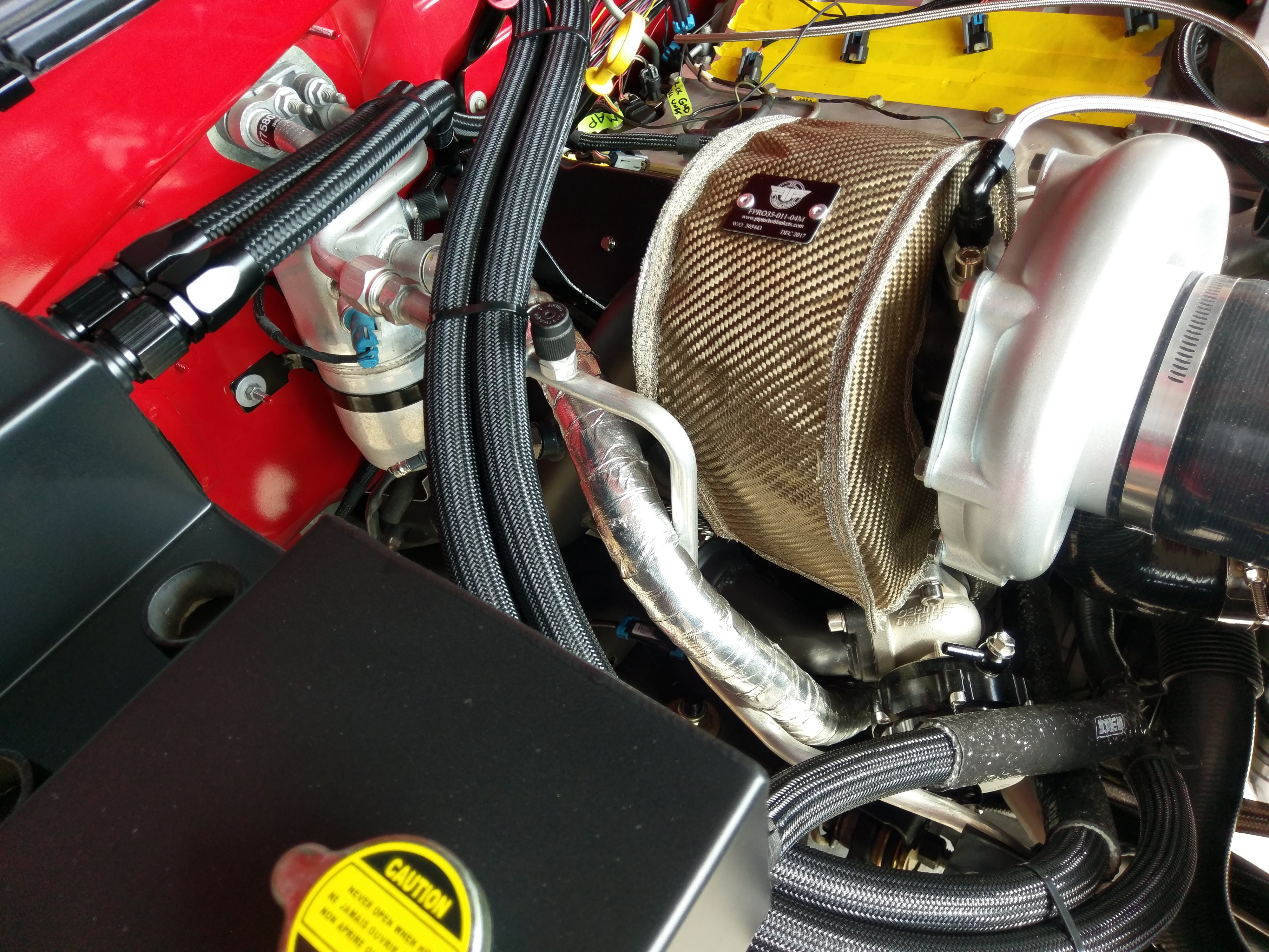

AC line was leaking since I got the truck, so got an AC delco replacement
ILuvJDM's 2007 NBS RCSB Build - Turbo/4L80e/Coilovers/Wilwoods-bodilrv.jpg
ILuvJDM's 2007 NBS RCSB Build - Turbo/4L80e/Coilovers/Wilwoods-viln2a7.jpg
ILuvJDM's 2007 NBS RCSB Build - Turbo/4L80e/Coilovers/Wilwoods-ruhc4pn.jpg
While the system was discharged, I moved the AC line by the turbo to get it away from the heat
ILuvJDM's 2007 NBS RCSB Build - Turbo/4L80e/Coilovers/Wilwoods-8f72djd.jpg

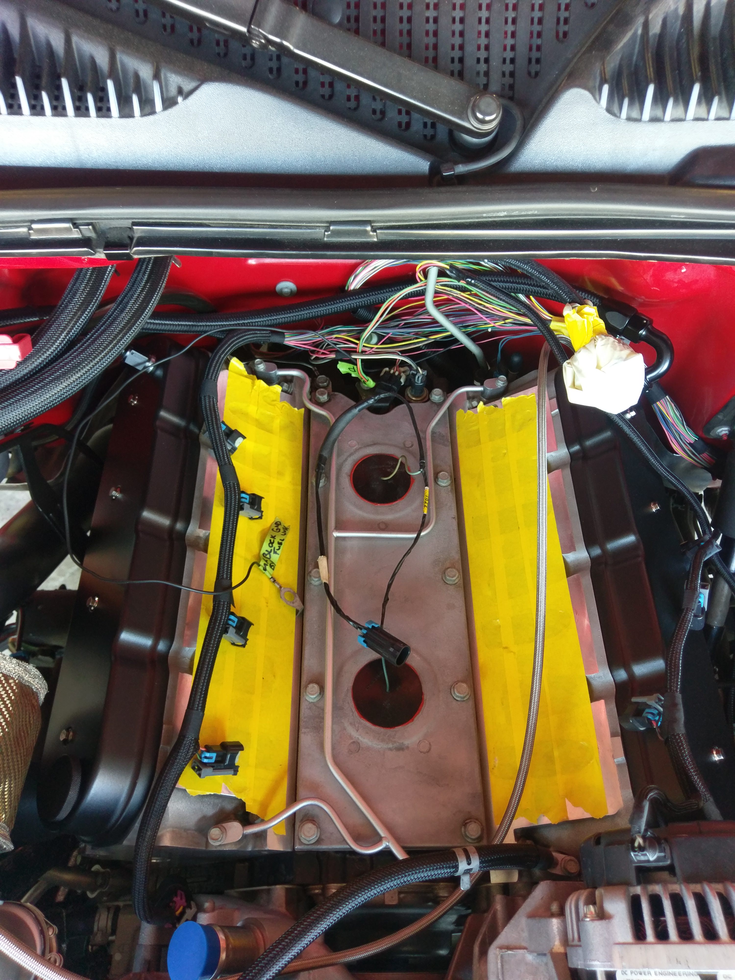

Finished the main engine harness wire tuck this evening. I knows its not a shocking transformation with the stock intake manifold, but you have to image how nice it will look when I have a hi-ram or edelbrock manifold and there are no visible wires running across the engine
ILuvJDM's 2007 NBS RCSB Build - Turbo/4L80e/Coilovers/Wilwoods-aai1kkz.jpg
ILuvJDM's 2007 NBS RCSB Build - Turbo/4L80e/Coilovers/Wilwoods-lnkd0er.jpg
ILuvJDM's 2007 NBS RCSB Build - Turbo/4L80e/Coilovers/Wilwoods-u8j7idx.jpg
ILuvJDM's 2007 NBS RCSB Build - Turbo/4L80e/Coilovers/Wilwoods-ru98xi4.jpg
Where the harness runs with the fender liner removed for visual
ILuvJDM's 2007 NBS RCSB Build - Turbo/4L80e/Coilovers/Wilwoods-2rrpof2.jpg

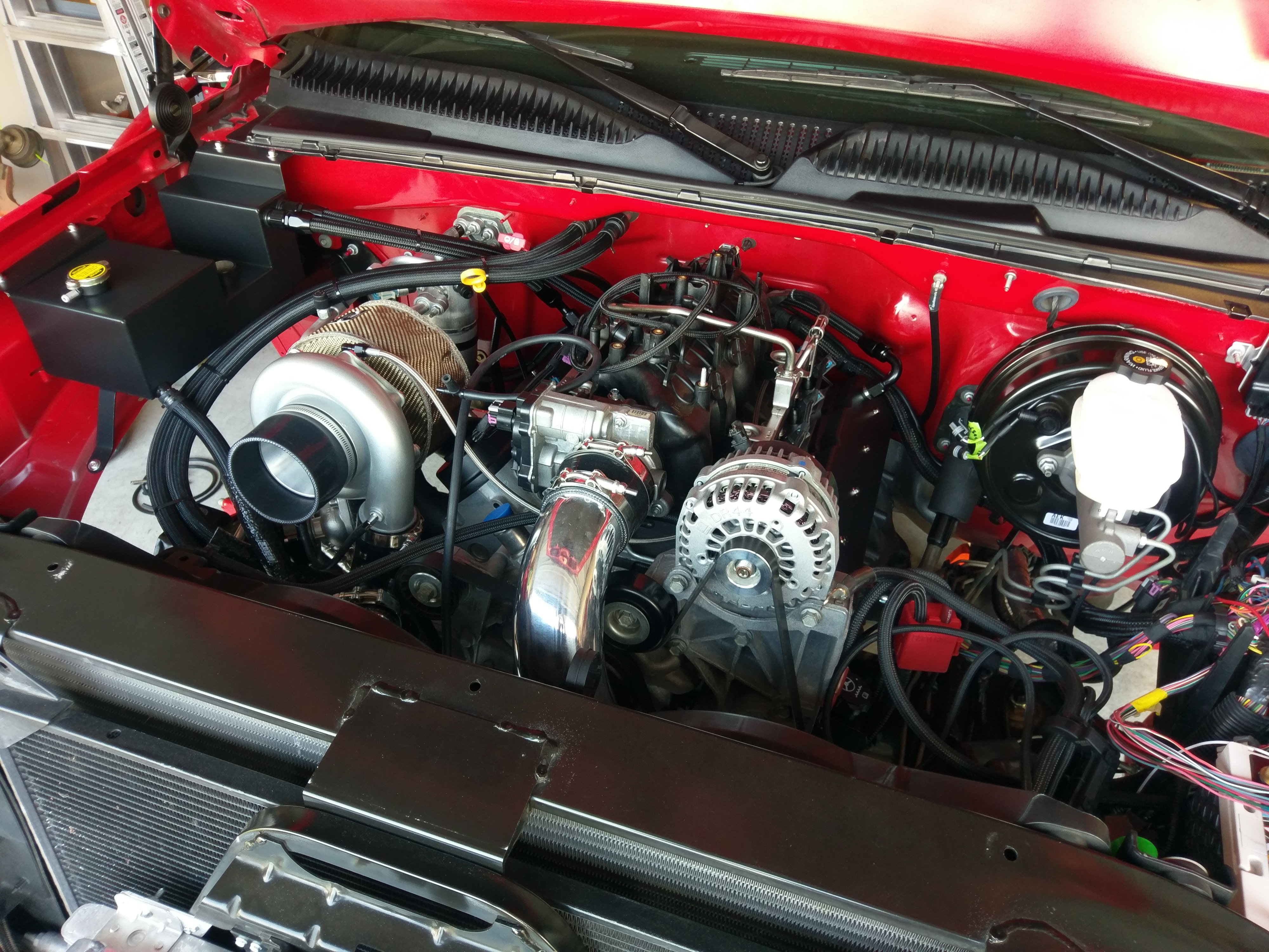

Trying to finish the little details which always seem to take the longest. Got the wastegate hooked back up and also ran the wiring for the wideband. Would have been cleaner to incorporate it into the OEM harness before I loomed it, but then I couldn't easily remove it in case I ever need to.
ILuvJDM's 2007 NBS RCSB Build - Turbo/4L80e/Coilovers/Wilwoods-meirr19.jpg
ILuvJDM's 2007 NBS RCSB Build - Turbo/4L80e/Coilovers/Wilwoods-kjzsa8v.jpg
Intake manifold is installed and torqued, fuel rail hooked back up with stock injectors for now, charge pipe tightened back down. Just need to find a way to secure the oil supply line and run the MAF/vacuum line for BOV
ILuvJDM's 2007 NBS RCSB Build - Turbo/4L80e/Coilovers/Wilwoods-ejwnuvc.jpg
The coolant tank that started this whole damn project is finally fully plumbed
ILuvJDM's 2007 NBS RCSB Build - Turbo/4L80e/Coilovers/Wilwoods-lkufaoc.jpg
The only big thing left is to figure out where to mount the coil packs, build spark plug wires, and wrap the rest of the harness.
