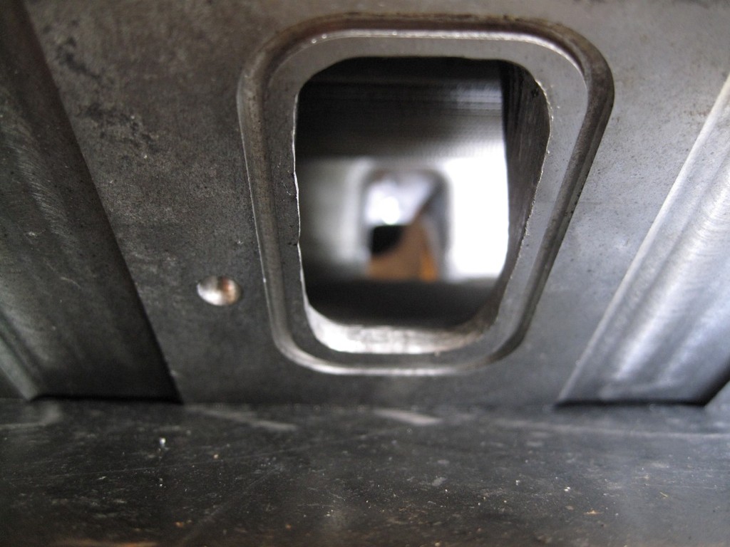

So here it is with no spacer, the intercooler is approximately 1" from the bottom of the intercooler to the manifold.

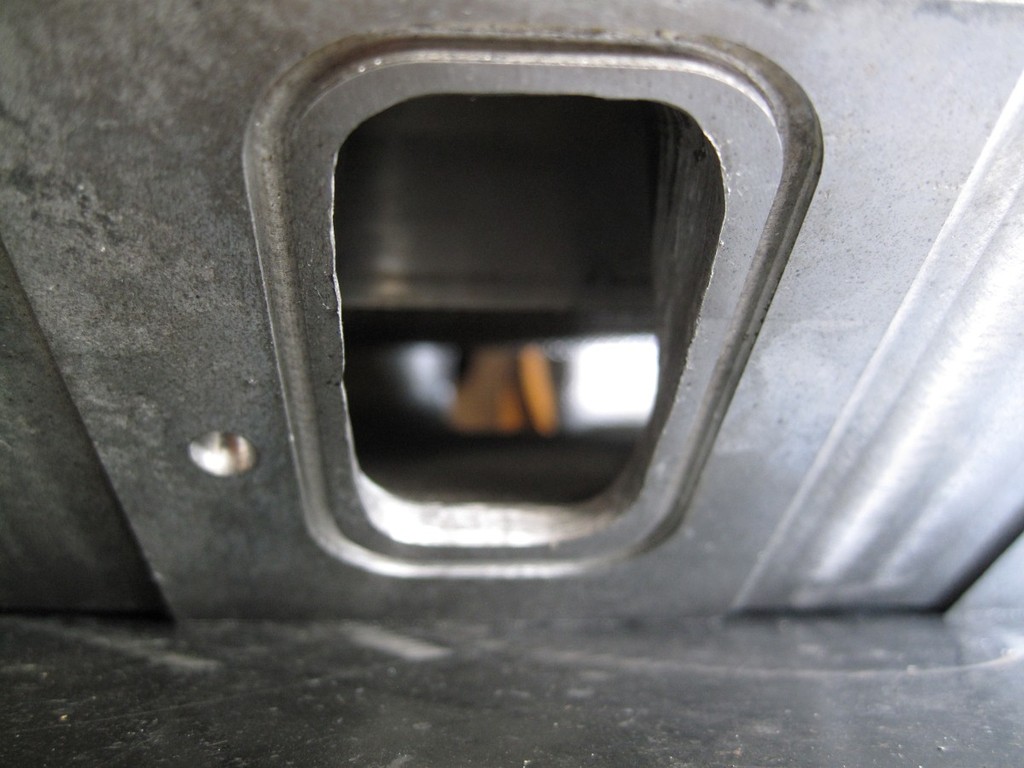

Obviously with 1" spacer it is now 2" off the bottom, but its a huge difference in giving the air a clean shot to the ports.

I put the camera on the bench both times to keep the perspective the same.
