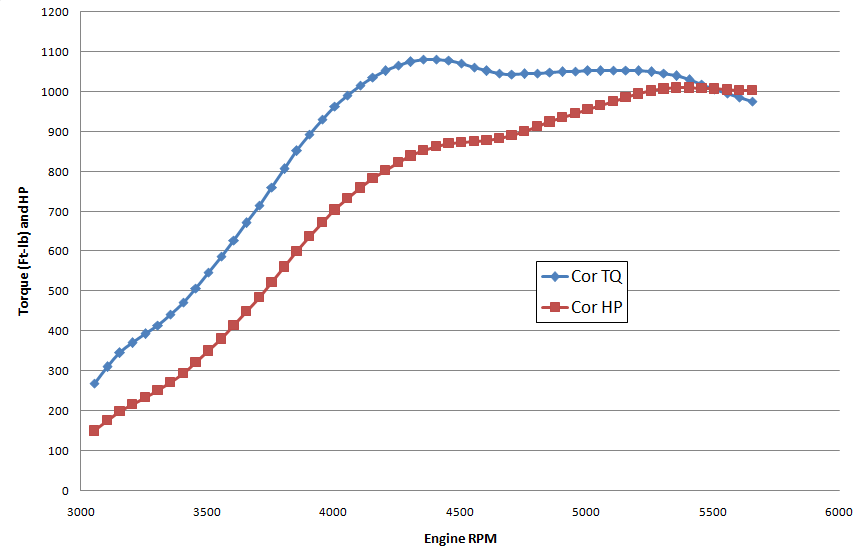

Oh and the dyno results...I dont put a ton of usefulness on the numbers exactly since the dyno loads it much different than the street. A little disappointed I couldnt keep boost in it like I wanted to, but the torque number sure says a lot. Boost feel from 25psi down to about 21psi at the end of the run. Pump 93 gas with some c16 in the tank and spraying a lot of meth. Roughly 18-19 degrees of timing. I replaced the pulley at the dyno shop and drove it home.
I think some diesel guys would be jealous of that torque number

1000hp/1100tq is why this is my favorite truck on the site. Awesome numbers man!
So you run 25psi on the street/track?
Old Aug 31, 2014 | 10:53 PM
  #475
Atomic's Avatar
I have a gauge for that
Posts: 16,282
Likes: 438
Yea well 27psi would be about perfect for the turbo but thats also where the 3 bar map ends so thats a thin line i dont want to cross. Hard to dial in the controller so it doesnt spike but yet gives me the boost i want. Boost stays more stable on the street around 25psi compared to the dyno. Turbo should be done around 1150 or so which sounds about right. Little fella is making some sauce!

Nah after I got it repaired I went home. Figured my luck was up for the day. I did a pull before at around 22psi and the numbers were 900/900ish, but it came in a lot slower so the torque was already past the engine peak VE.
