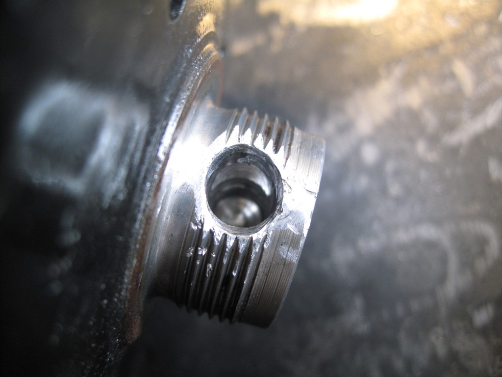

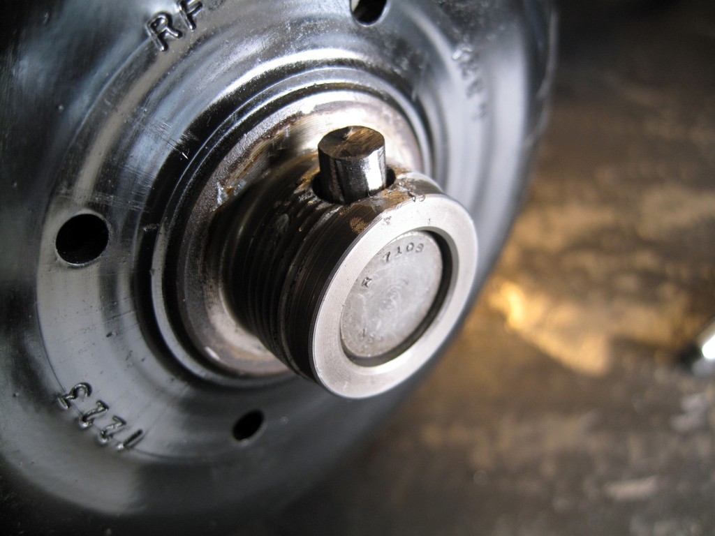

Alright so I ended up actually finding a 5/16" carbide bit in my tool box which I think is from the magnacharger crank pin kit I used 5 years ago. I knew that would come in handy eventually. Jeebalow was right to hold it very fixed...I cracked the bit in half when it was almost all the way through. Part of the problem was the bit was pretty short, so the drill chuck hit the pulley so I couldnt get a straight angle on it. Cut through the shaft like nothing though. 5/16" is a little bigger than I wanted, but I think it will be fine.
I got a piece of 5/16" rod and cut it a little longer than needed and welded it in there and also put 4 welds on the end of the pump snout to the pulley. Not a pretty enough weld with my mig for me to show off, but if it breaks its going to have to rip the pump shaft in half and not just spin off the pulley.

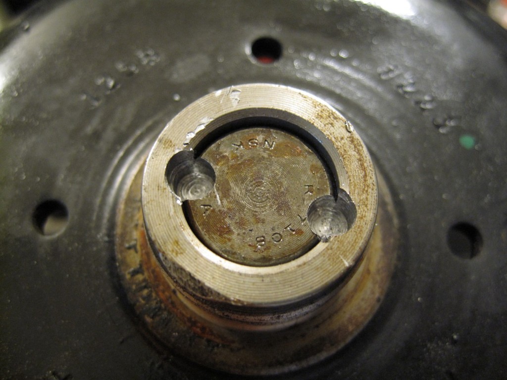

I was worried about the 5/16" being too bit and the shaft just breaking in half, so I got another pump and a fancy end mill bit and did what he suggested.
Im gonna keep the one with the 5/16" as a backup

Looks good! Hopefully that does the trick, much better than the $400 waterpump.
