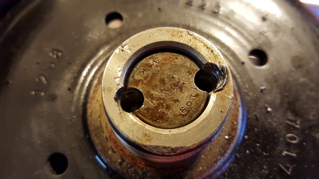

I thought about it and it seems the most likely failure mechanism is low cycle fatigue due to alternating stress. In my mind I picture everything spinning along and then at a shift, momentarily the belt tension is in reverse (blower is driving crank and everything else). This is because the blower has significant inertia and does not instantly change speed same thing with the waterpump moving large amounts of water at high speed. The HD tensioner and 8rib belt exaggerates this issue by not allowing the belt to slip making the cycle amplitudes higher. I measured the HD tensioner to be about 33% stiffer than the normal one. So basically after enough of these cycles the welds eventually crack and on the pulley shafts spinning on the shaft and works its way off.
So if this is the failure mechanism then pinning it should be a much better fix than welding. I used a 3/16" drill and it measures 7/32" so if I can find a pin that size I think I can press it in and maybe use some of that sleeve retaining compound so it doesnt back out. Or a tiny tack weld to hold the pin in wouldnt be hard.

This is what happened when I tried to tap the hole for a bolt. The pulley has threads but the shaft didnt have a scratch on it
I drilled it deeper to about 9/16". The pulley snout is only about 3/4" thick.
