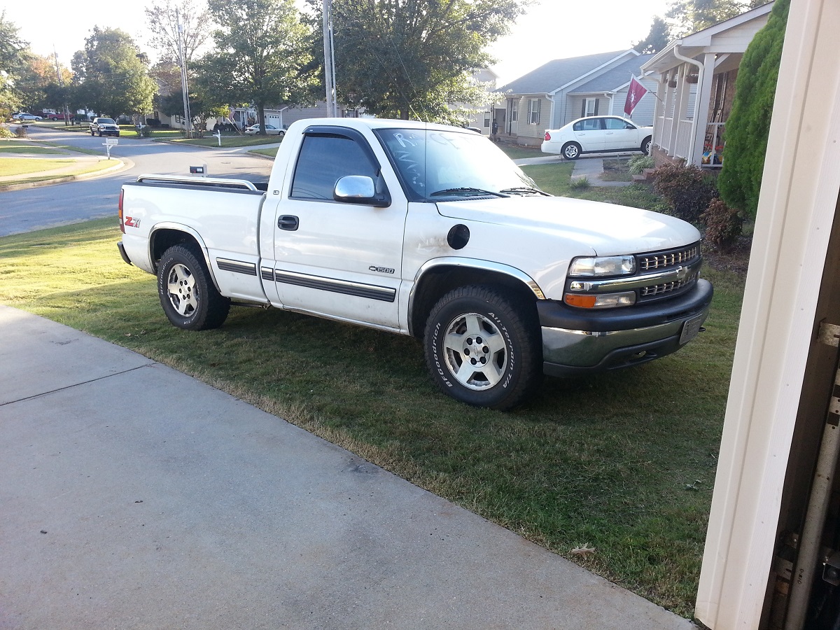

Trucks looks good, like always a sleeper like no other lol does it still have a hole in the passenger side fender?

Yep, still has the hole in the fender
