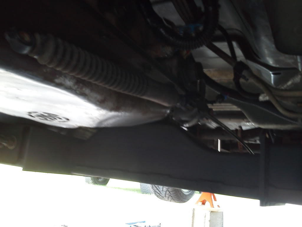

80e swap is underway. Had my buddy stop by and help out which made this move pretty quick without any real problems. I work at a snails pace compared to him.
old 4l60e out and next to the new 80e

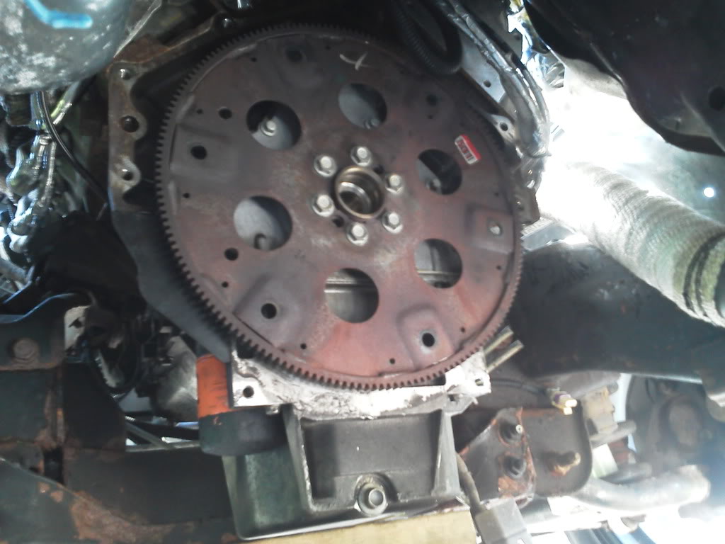

New flex plate bolted up to the engine

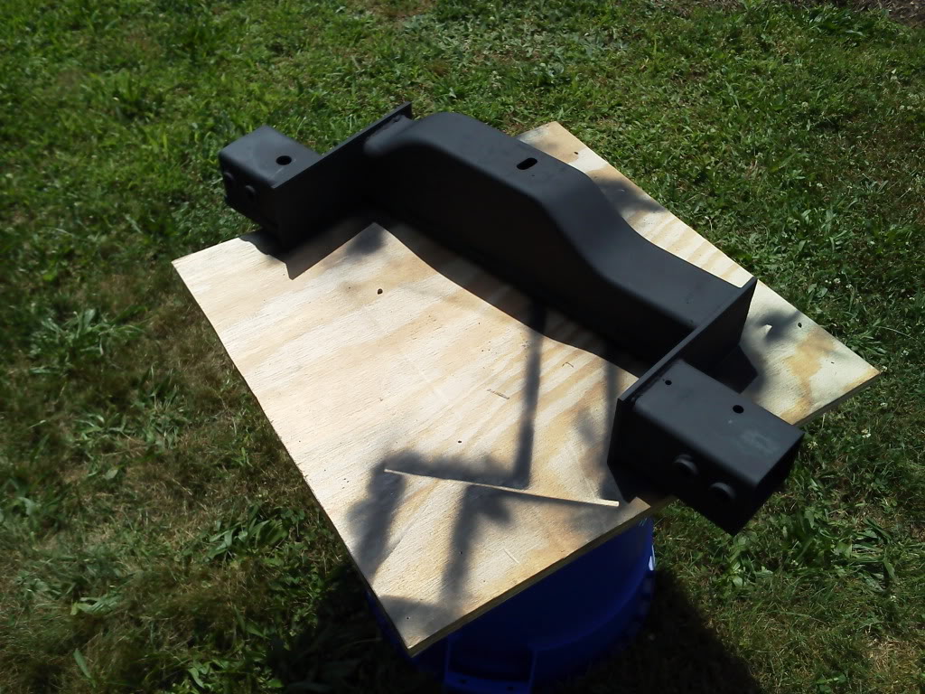

Crossmember modified and painted

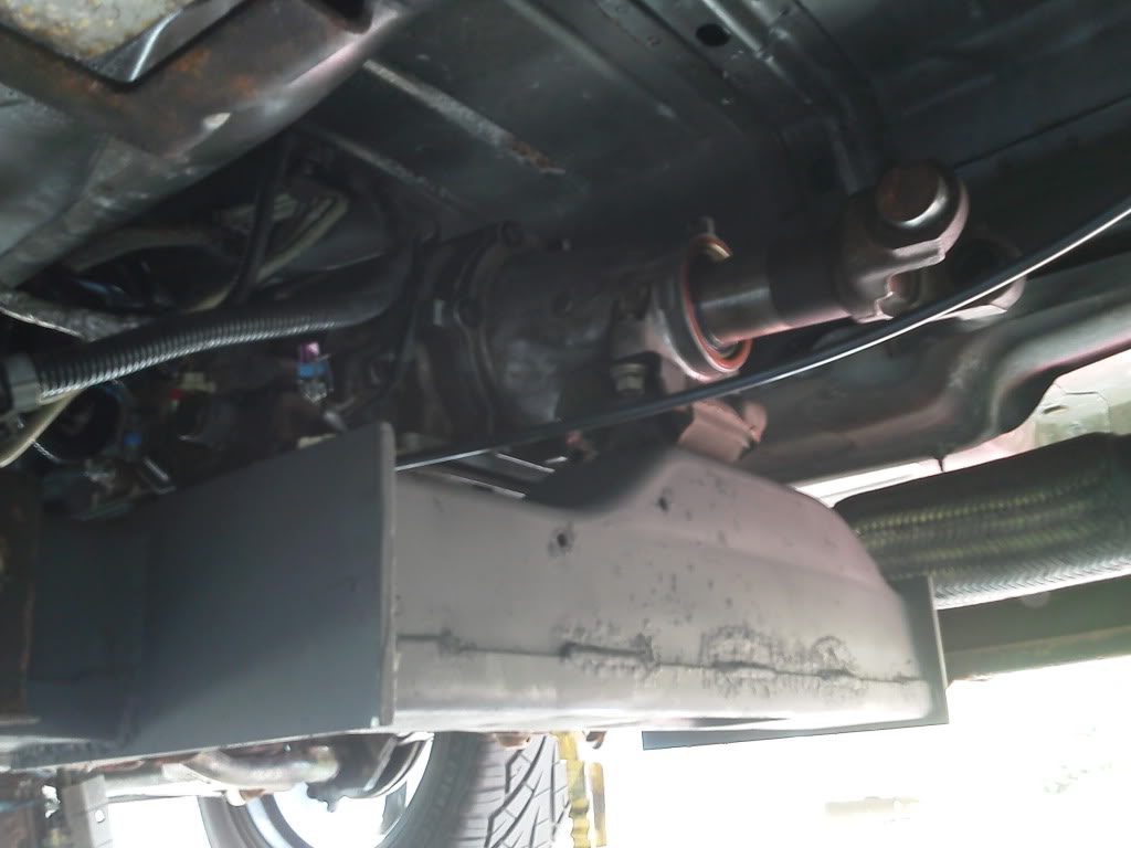

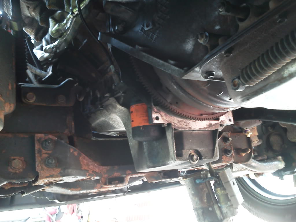

Trans in (The pictured yoke is not the yoke being used. Only in there to keep crap out of the trans until the shaft goes in.)
