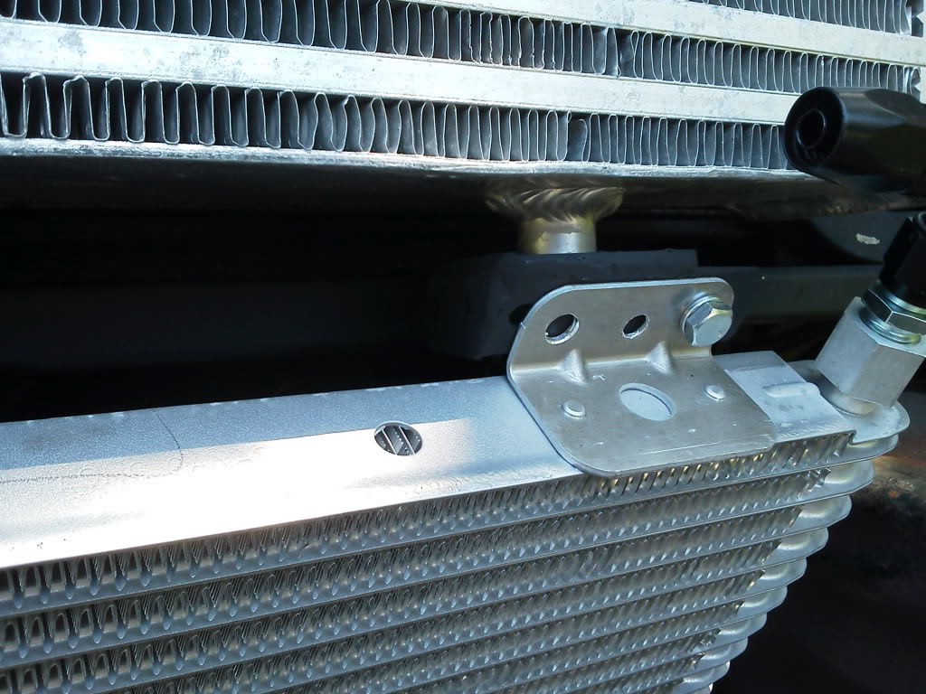

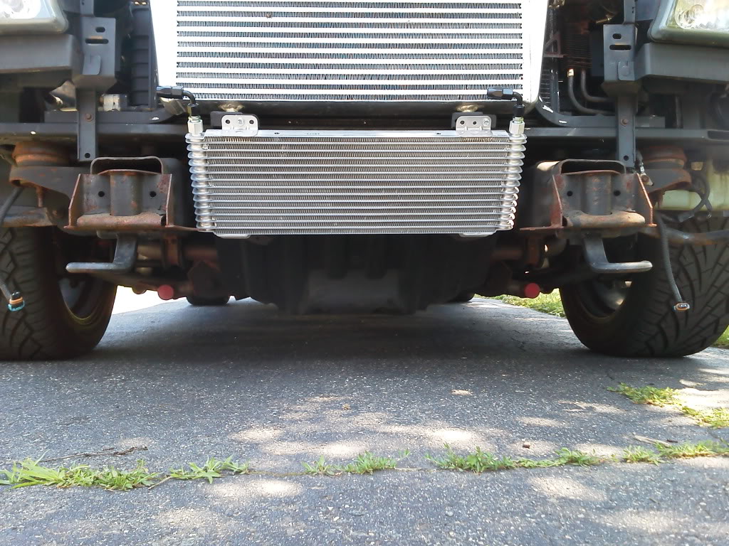

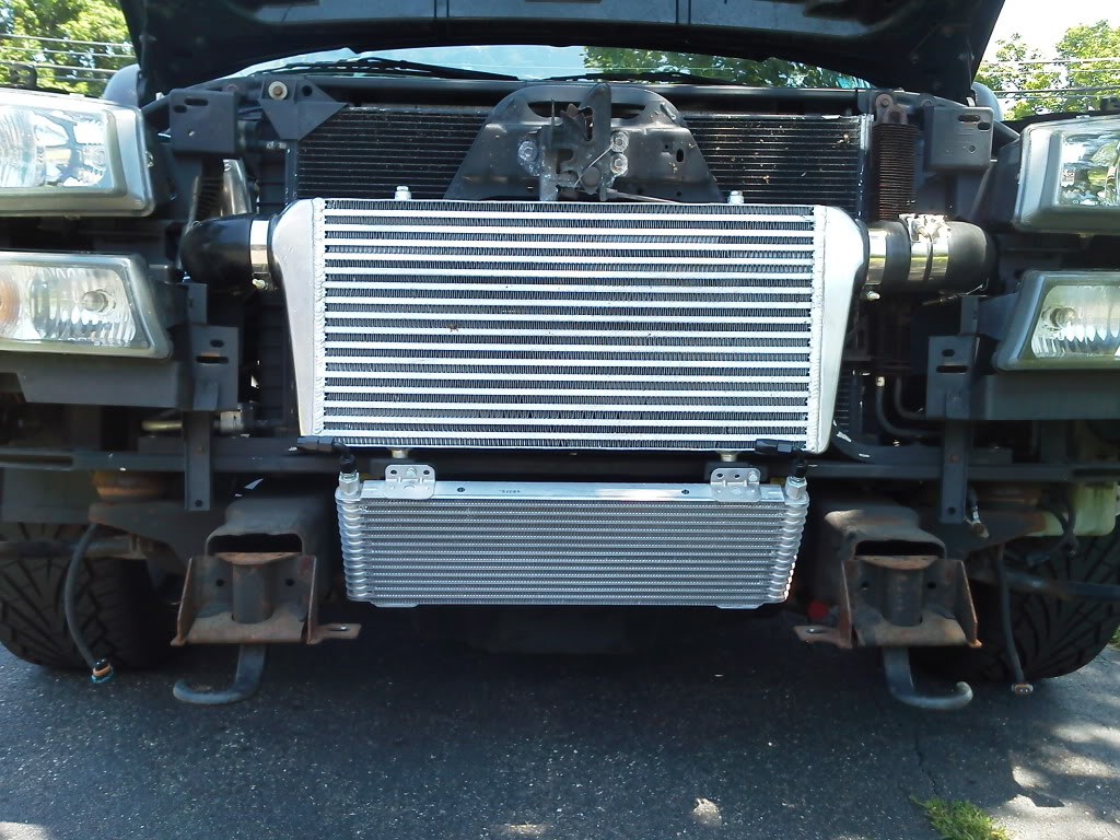

Took some time this morning to get the tru cool mounted in prep for the trans swap which will hopefully take place next weekend. With a little welding I was able to modify the intercooler mounts to also hold the trans cooler.
The bottom is mounted to the plastic cover bolts with the stock strips that came with the tru cool. Just bolted them on and twisted with a pair of channel locks until the mounting holes were where they needed to be.
I was able to get some more gound clearance with the angle its mounted as well as to keep me from having to notch the bumper. The outlets of the cooler end up in between the pockets of the bumper. Cant see the cooler through the grill and it should get enough air from that small hole in the bumper.

Looks real good man! Worst case if you feel its not getting enough air, you could always cut those three indents out in the lower valance. Ive seen a lot of people do that when they have the intercooler mounted between the frame rails.

Thanks, I don't think there will be a problem with overheating. Big cooler, stock stall, and a lighter truck should do it. Cutting the bumper would be absolute last resort, was never a fan of the way it looked.
