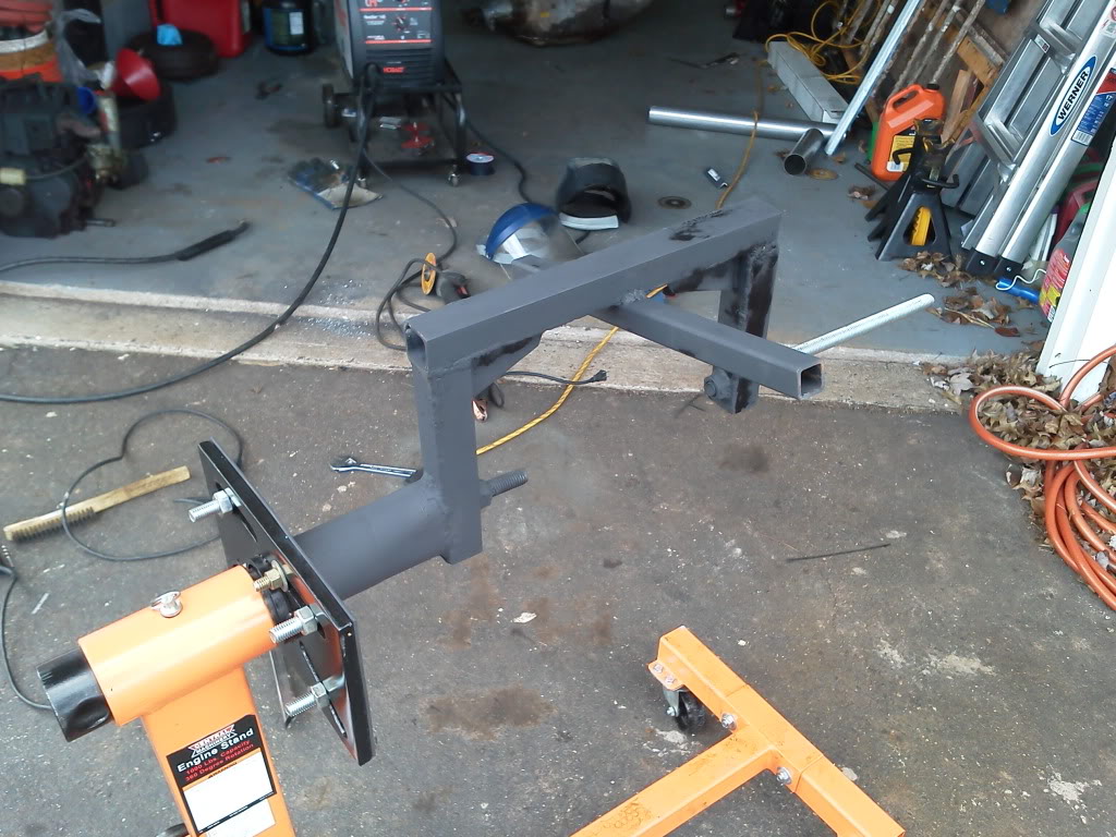

Sent some logs back to Justin at Blackbear and got a retune, the overall driveability was fantastic but as I crept into boost the mixture was too lean, so back to blackbear for some tweaks. Been running 1300 miles so far on the initial tune and the 60e is still holding strong somehow.
Since the 80e was going to need a rebuild I took some time this weekend to make a service adapter to one of my engine stands. Not as pretty as some of the others on here but it came out pretty good.
Tear down/rebuild pics to follow as I get some free time.
Paint still drying
Mounted
