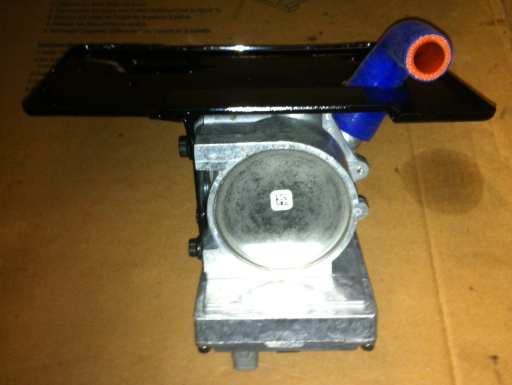

Finally snuck in a few hours to work on my own stuff.
Bolted down the lower intake with the modified LSA/LS9 intake gaskets. Hopefully these will work better than the Fel-Pro paper gaskets. Threaded the bolt holes deeper into the heads and used thread sealer. Should help prevent the bolts loosening and the oil seepage that I had before.
Mounted the EMP intercooler pump under the factory air box support, keeping it in the optimal mounting orientation. Hoping to drop the blowers back on this weekend, Then can start wiring up the sensors.

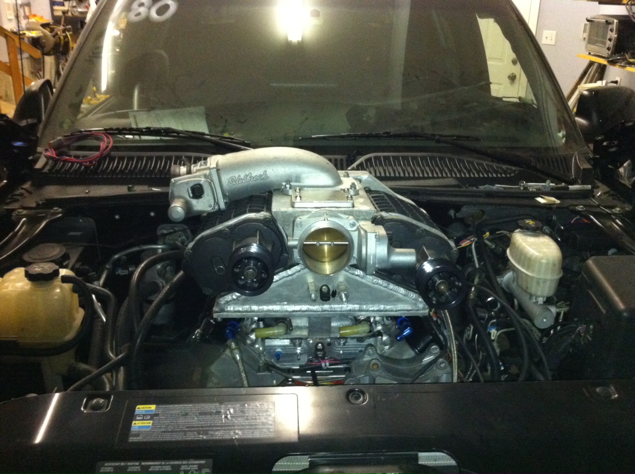

Little more progress....

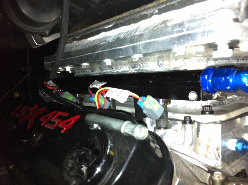

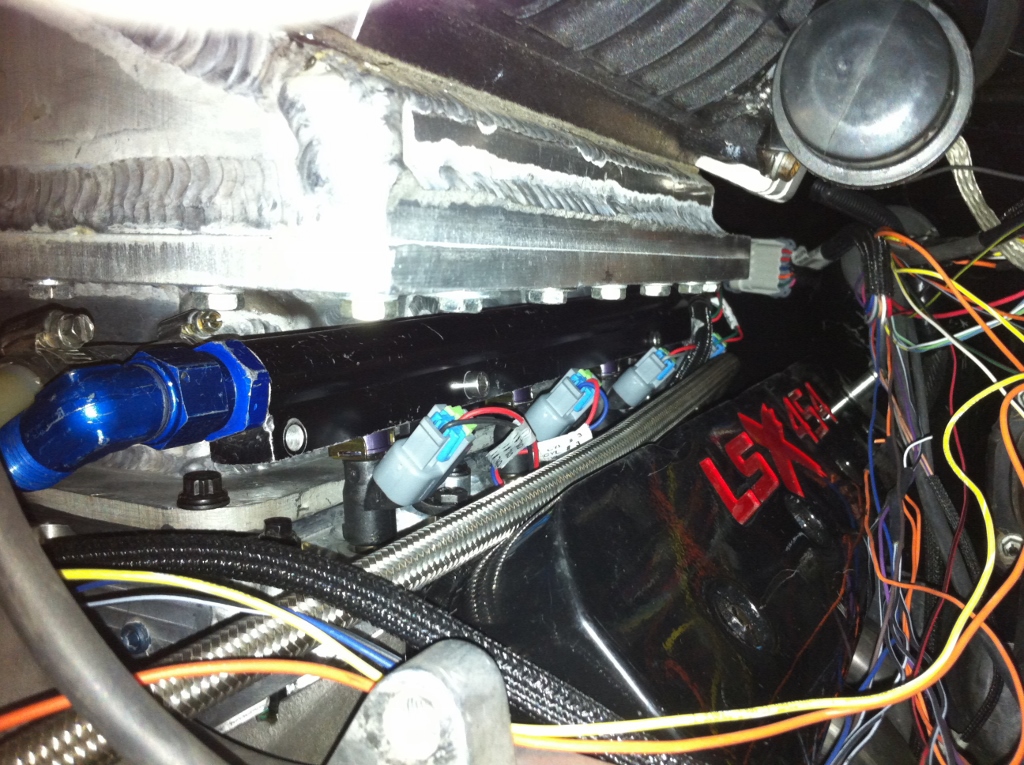

Rails are in.
Will be running pre and post IC IAT sensors as well as in/out coolant temp sensors on both IC core and HX.
