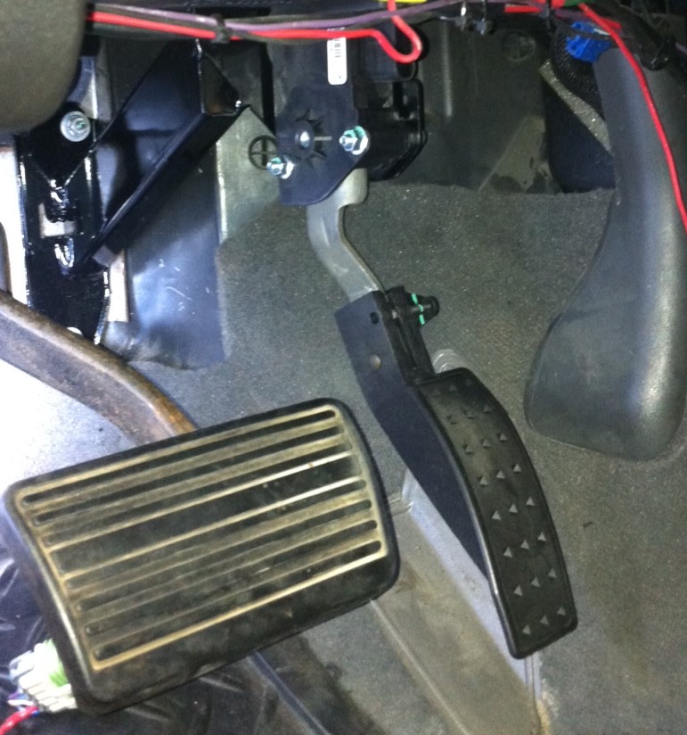

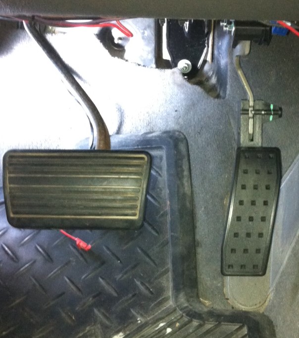

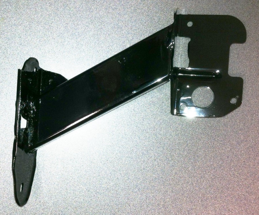

Just getting started on this, but have a few pics.
The Dominator system uses a GMPP throttle pedal which is puny compared to the original truck pedal, so I had to build a mount to get the pedal in the correct location. Lost my never used power adjustable pedal though.

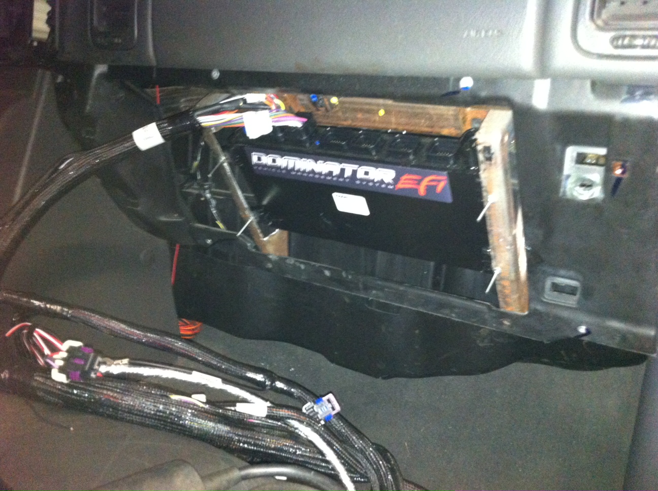

Scoped out a possible mounting location for the PCM. Still deciding where to pass all the wiring through the firewall for a half-a** clean install. GM must have known the Dominator was coming when they designed the glove box bracket. Just required a little trimming.

Are you using factory ecm with the Holley? Or just deleting it altogether?
Old Jun 5, 2016 | 11:12 AM
DrX's Avatar
DrX
Joined: Jun 2005
Posts: 2,703
Likes: 6
From: Canada
I have removed it.
Going to have to rig up something for the trans range indicator/neutral safety switch as the Dominator has no provisions for that. Maybe an LCD that shows the selected gear/range. As it appears that the Digital Dash only displays the gear commanded by the Dominator.
The D1 brake may also be an issue. Don't need 2nd commanded while the shifter is still in D1.

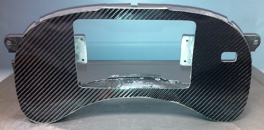

Thinking maybe carbon fiber for the dash??
